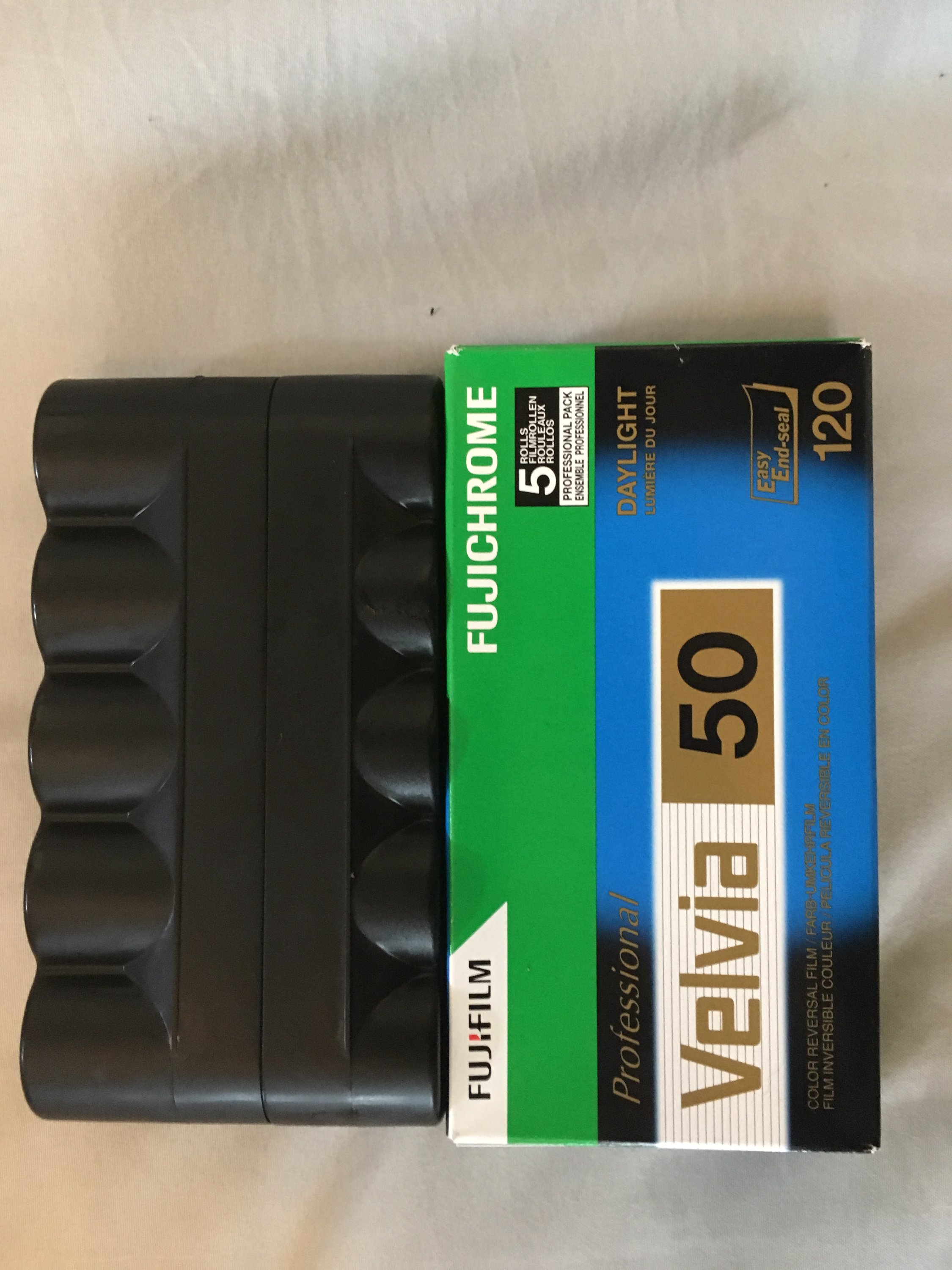

Here are some photos:
251D2512-BEA8-43CF-AB68-84FEED0CBF8C.jpeg 5EE29295-41B1-4895-A787-5924E8C86394.jpeg
EDIT: and, yeah, they’re probably light tight, my comment was also about the fact that you’ll be opening and closing it to retrieve fresh film and add finished rolls, which could allow fogging if the roll has come loose in the container. The single cans you can leave closed until your ready to develop.

I'm not sure where you get 18mm from?
Sorry, I was just being lazy with an off-the-cuff guess instead of taking the time to measure the individual roll holders I have. I did, however, want to differentiate from the thickness of the material it is made from.
Thanks for the photos - they are perfect for what I need!
