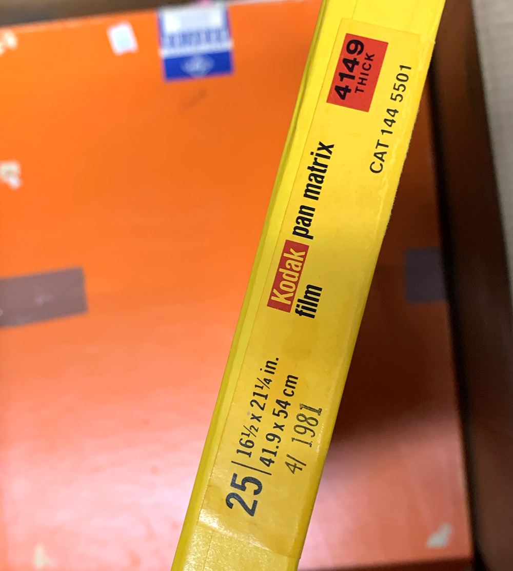

So I inherited quite a bit of enlarging papers stored in a climate controlled space, I suspect much of it is over 20 years old at this point. Most of the sizes are 8x10, 11x14, 16x20 and some 20x24 and some technical films like Kodak Matrix. This is a lot of paper, over 200 packs and boxes, some unopened, some opened, almost all of it graded, only a handful of multi-grade and by far most of it Agfa.

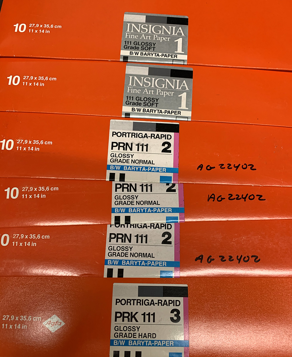

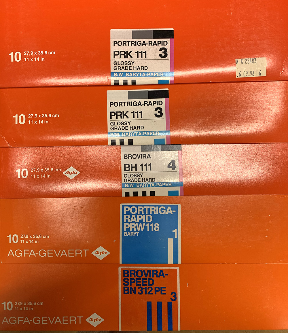

Right off I can see using this almost in a Lomo sense, I get what I get and don't use it for anything in where I would expect consistency or even results of any kind. But given the photos I have attached below, what are my prospects of using it for any kind of meaningful image based on the experience of those who have used very outdated paper?
For lith, some of that stuff is the gold standard (the blue box Seagull) - and the Agfa paper isn't bad either. The Ilford paper is likely pretty good too for that. Lith processing is pretty fog resistant even with aged paper - I've used expired Agfa paper that produces horribly grey whites in regular dev, but cleans up just fine in lith.
Insignia is the same as Record Rapid as far as I know.
Sadly the Pan-Matrix is probably long dead & badly fogged if it hasn't been very carefully stored (it's a highly sensitive, unhardened panchromatic emulsion).
to test, take a sheet, cut in half, develop and fix one using your normal timing for development, and just fix the other. Wash and dry them, then compare. Any tone in the developed one will be fog.
I’ve not had good luck with old Agfa “speed” or “rapid “ papers. The Brovira BH-111 might well be ok, not sure on the others.

As always, YMMV, but just a couple of weeks ago I printed on some Agfa Brovira paper which has been stored terribly for the last 35 years. Contrast was quite low, but still got something fairly decent from it.
Just give it a try when you're recovered!
I've used some very old Agfa Brovira and Kodak papers successfully though there was some fog. Give it a try... You might get good results.

portriga-rapid is my favourite paper so far for lith. old papers like this are worth quite a lot of money nowadays.
You have a gold mine for Lith printing.
Graded blue Seagull is fantastic. Followed by Portriga and Brovira which are also terrific in Lith.
Agfa Insigna is very tricky and unfortunately doesn't behave like Record Rapid.
Never tried Ilforbrom but they are supposed to Lith very well.
All in all you got a treasure :smile:
Enjoy !
I agree with Guillaume, it is a Lith paradise!
Yup, those are some very nice papers. And not only for lith! All of the Agfa fiber based paper I've tried so far has turned out to work great. The RC paper is usually junk.
I've had pretty good results with some older Agfa MCP 310 - it may well be dependent on the specific coating package at a specific plant - there seems to have been some specific coating addenda that prevents lith happening (and I'm pretty sure it's not the heavy metal salts that makes paper 'lith').
Interesting - all the material evidence I've seen suggested they were at least very close, if not identical - at least with the last generation of RR.
I had the same belief than you until I ran off of RR and followed with Insignia. Very strange, image came way too fast and a fog, like a dichroic fog, killed the print.
I tried a few times with different boxes and got same issue. Last generation of RR isn't the best for Lith when compared with older ones but you can still get beautiful gritty prints.
