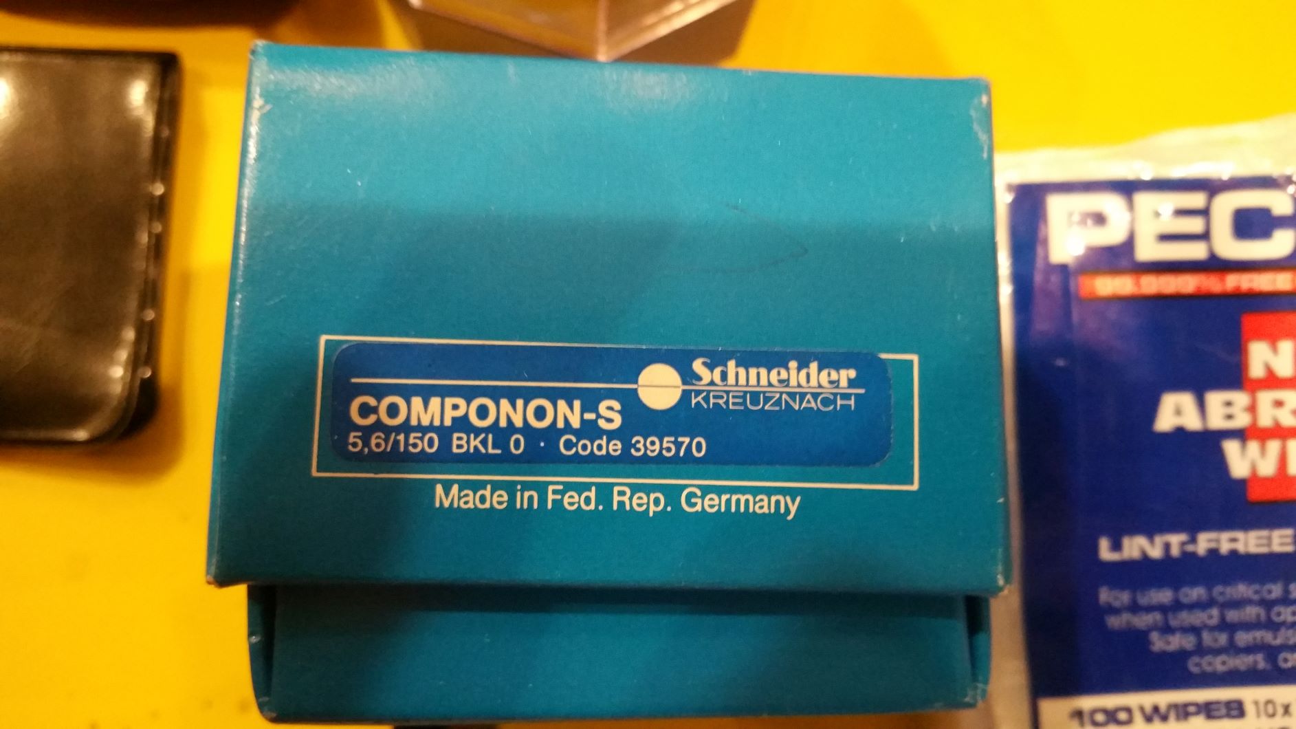

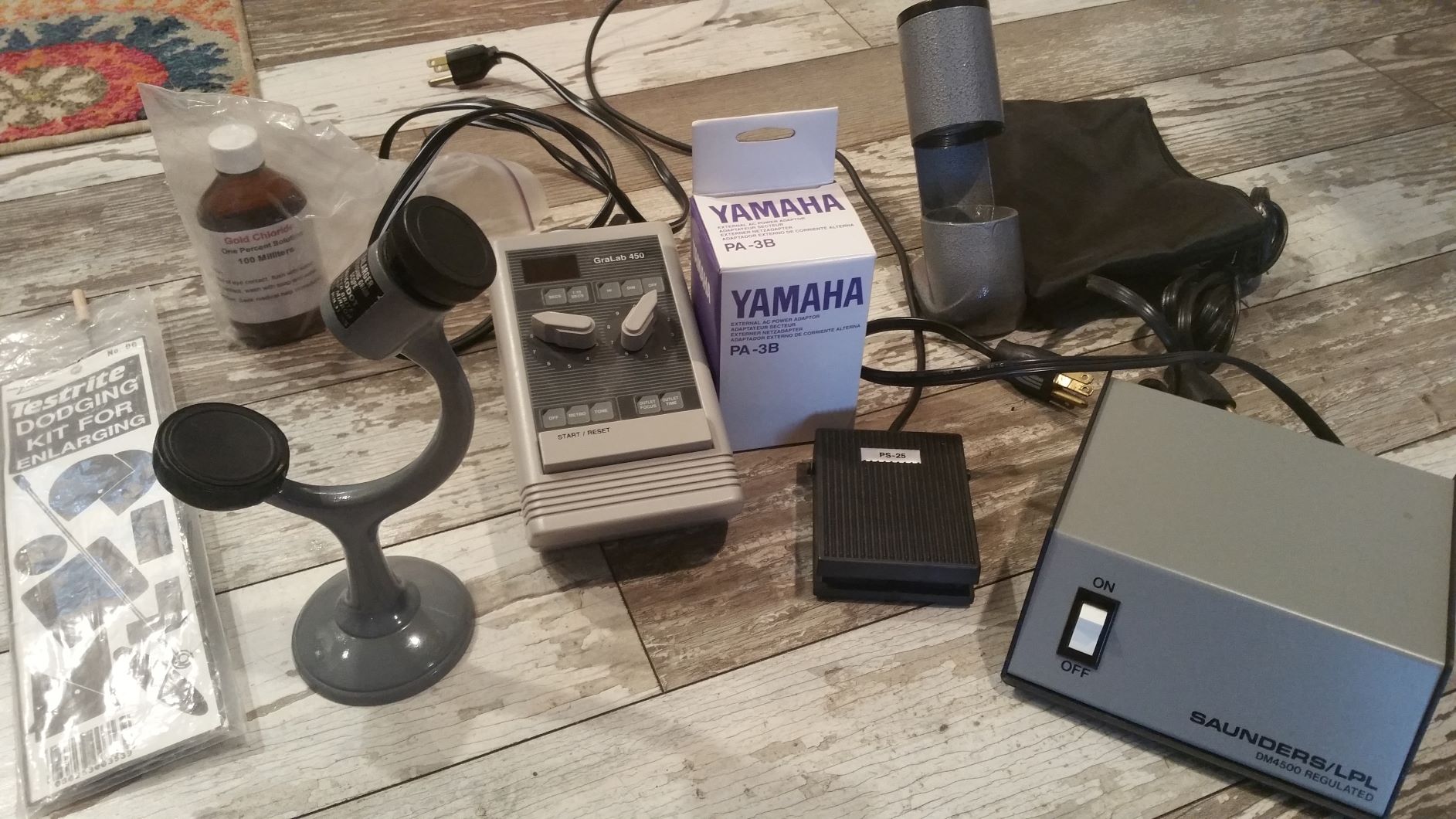

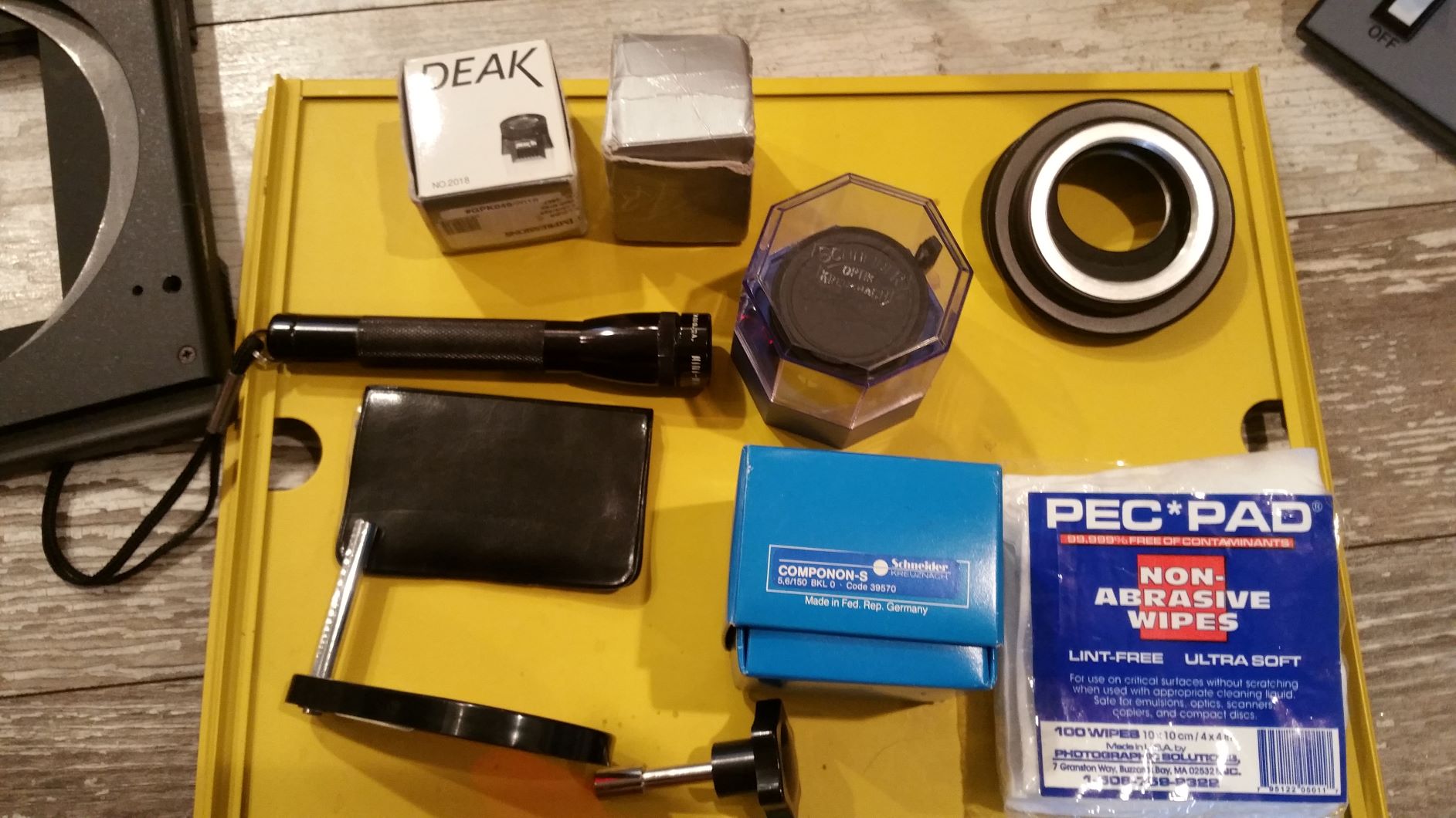

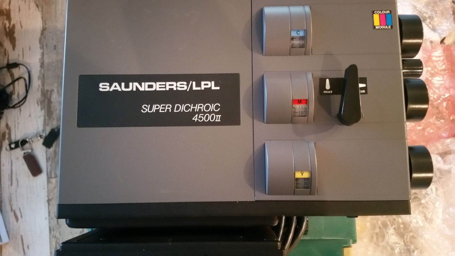

looking for advice. I inherited darkroom equipment.( been years since I have been in a darkroom.) and I will be moving out of the country, so I am planning on selling this equipment. not listing a classified here, yet. I need to subscribe. thinking on FB or Ebay maybe. I'm a little bummed because I always wanted to have a darkroom. I have a lot of negatives, it's just not possibly anymore.
the system is currently disassembled. I won't be able to test making a print, but what should I test? power/lamp? should I take the time to assemble it?
during my research I believe it's a good enlarger. any advice on what to list it as?
any advice is appreciated. thanks!
Personally, I would plug in the enlarger head, make sure the air ports are clear and that the heat won't affect the surface, turn on the lamp and make sure the C/M/Y filter wheels work and produce the proper color when turned to maximum.
Otherwise, physically check the other items for cracks, fungus and obvious physical problems.

You do not need to put them together. You need to connect the power supply box and timer, to the enlarger head unit. Turn on and to test the power supply and the head unit. If they are all good, you can turn the color wheels to see if light changes color. That is all you need to test. Also, you need the mount the lens.
Then see through the lens to see if there is any defect. There are more if you can, such as the frame and head movement on the frame etc. But I doubt there will be any issue.

Overall, the enlarger is a good solid model and the lens is also great. I'd guess $600-800 for the whole kit is a decent deal for the buyer, if everything works as it should and there are no other problems. But there may be no takers for this price all the same.

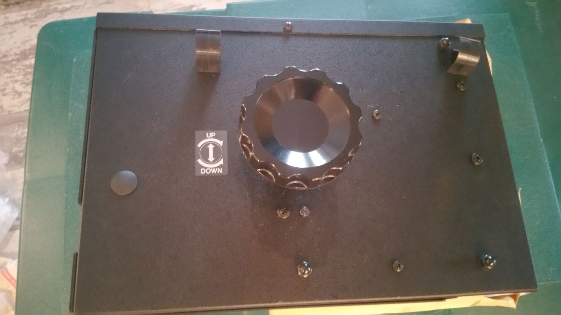

It would be best to assemble the enlarger to make sure it's not missing some critical component.
Does it have the column to raise and lower? it is not shown in the picture.
