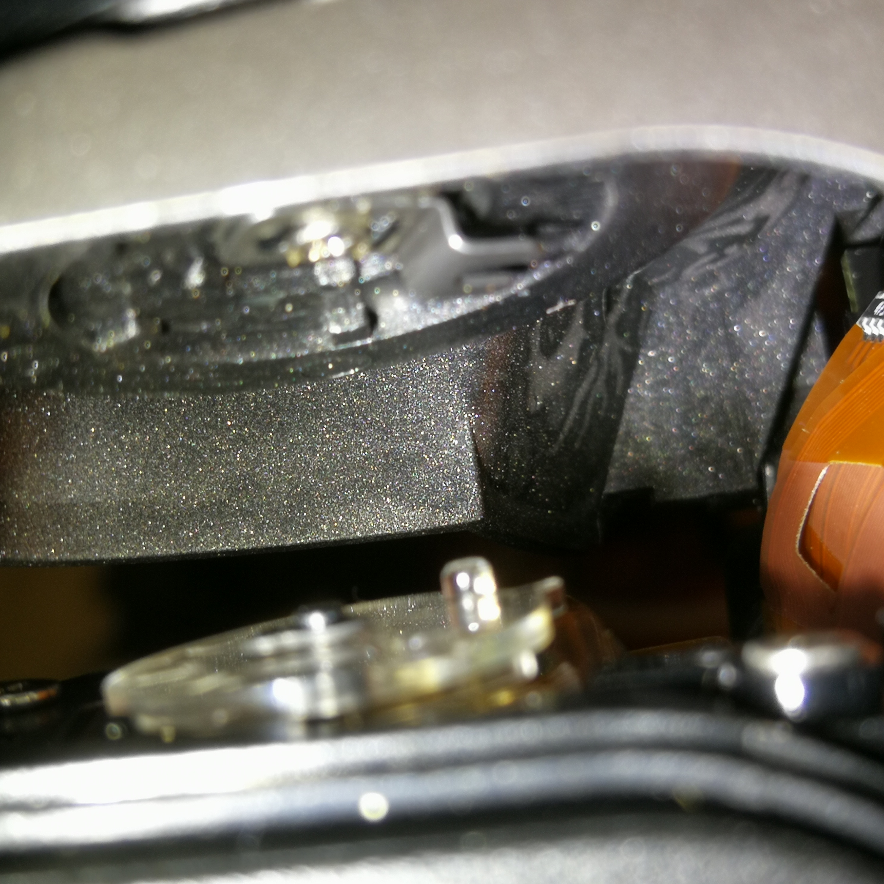

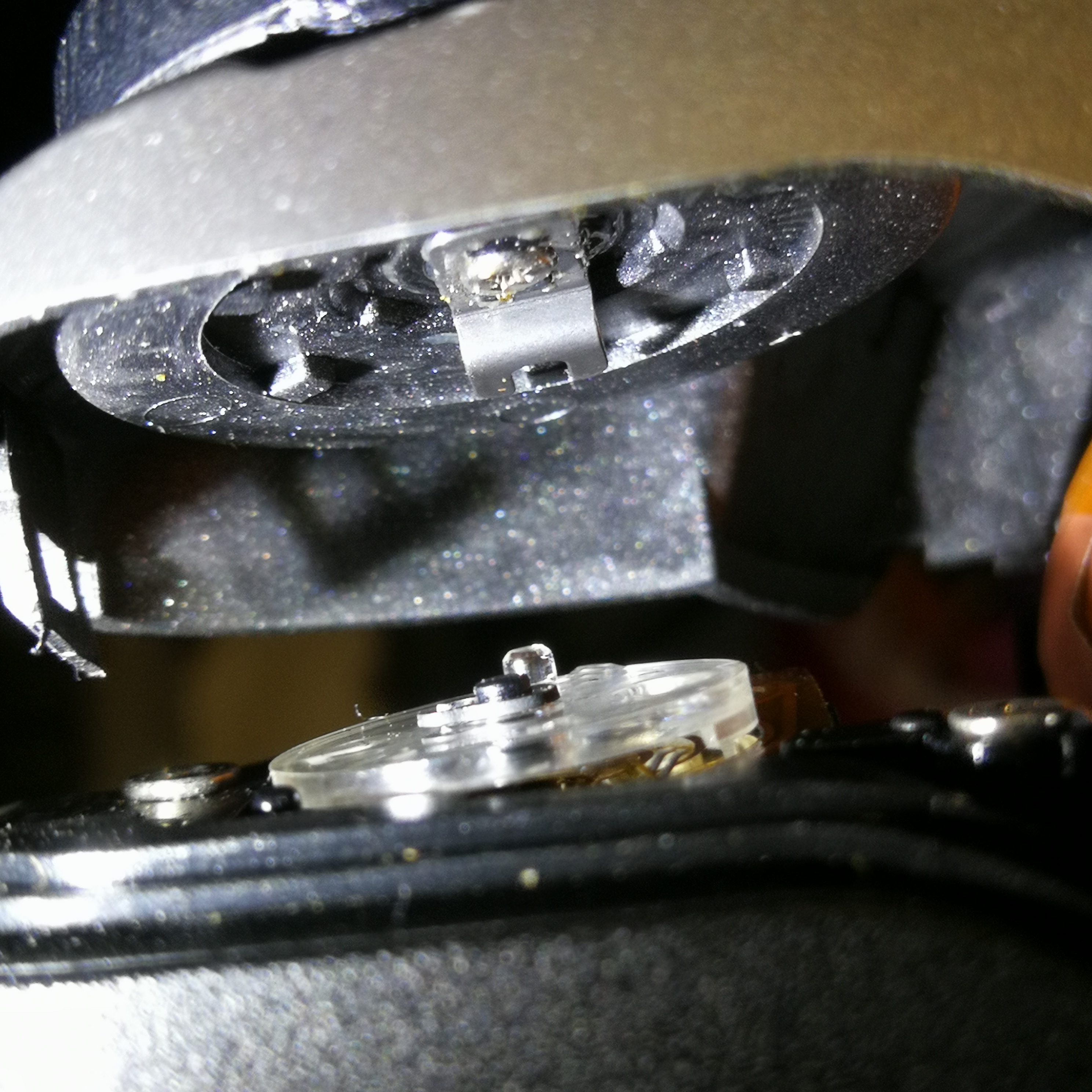

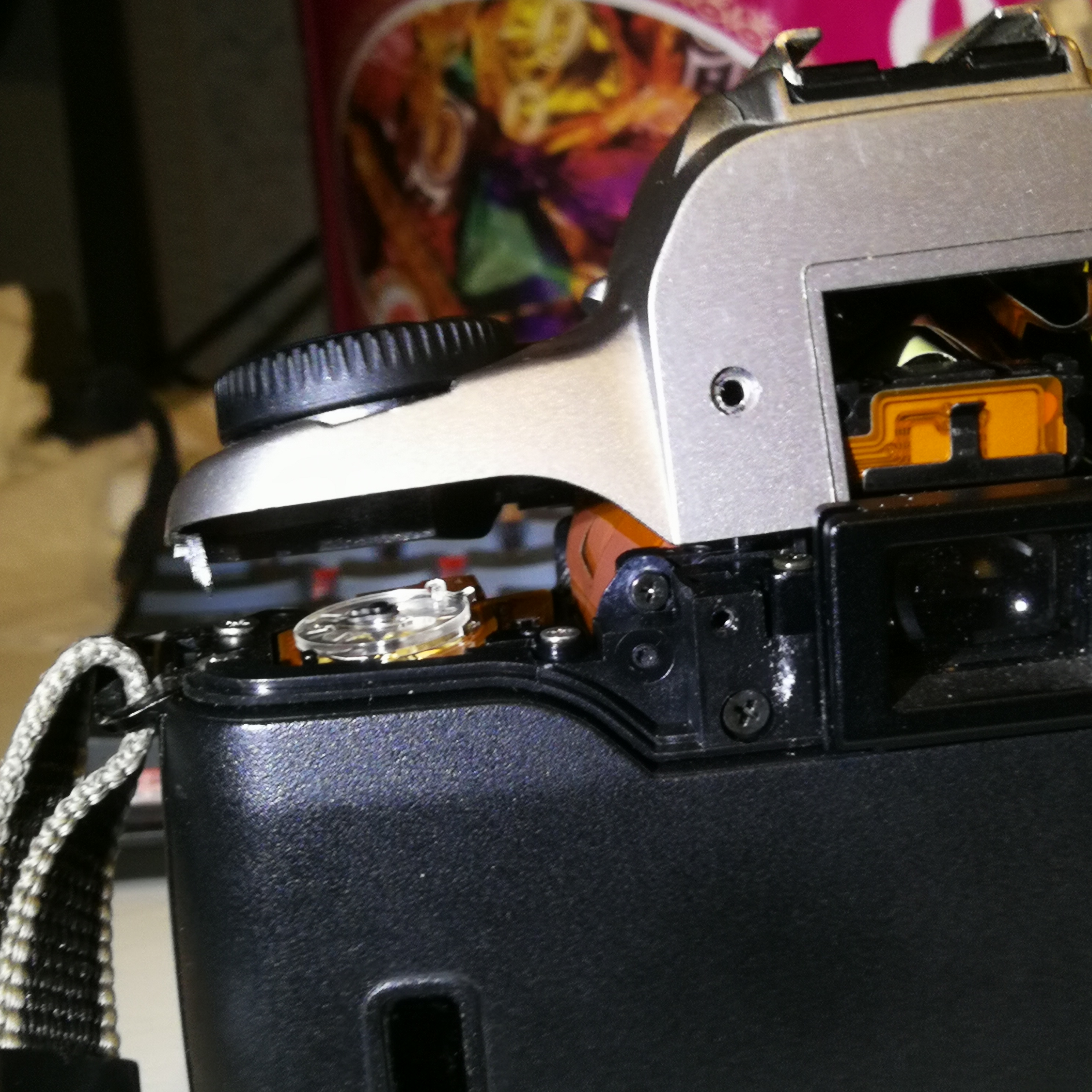

Once I got the top plate off, I could see that the little bracket on the underneath of the mode dial wasn't lined up with the little protrusion on the mechanism that sits below it. So the command dial on the top was turning, and clicking nice and firmly to each detent, but it just wasn't connected to anything underneath :pinch:
For the sake of anyone who might happen to come along behind me with a similar problem, here's a few pics:
So I lined up the two parts, put the top panel back on, and voila! The mode dial now works!!! :D
