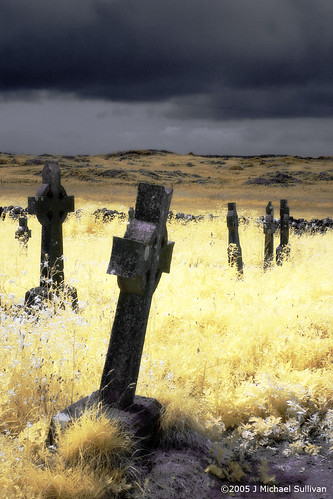

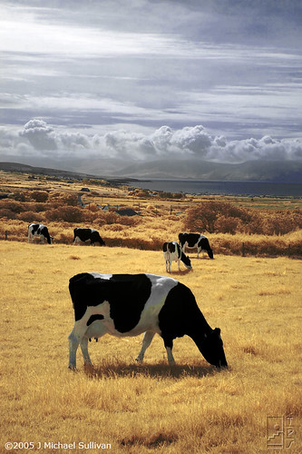

Converted Nikon D100
I had a Nikon D100 converted at Dead Link Removed a few years ago. I like the results. You can check my Verdun Infrared or Battle of Actium galleries for typical images. The conversion cost was under $300, as I recall. It works best for me with my old AI manual, fixed focus lenses. Zoom lenses seem to have more focus problems, so need small apertures -- f11 or smaller. Hand held works fine in most situations. Using an IR filter on a non-converted camera often means using a tripod to get good results.

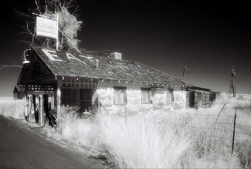

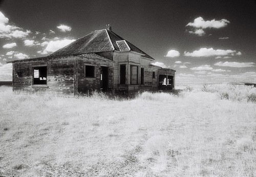

Here is a sample image of digital infared by one of my clients.
