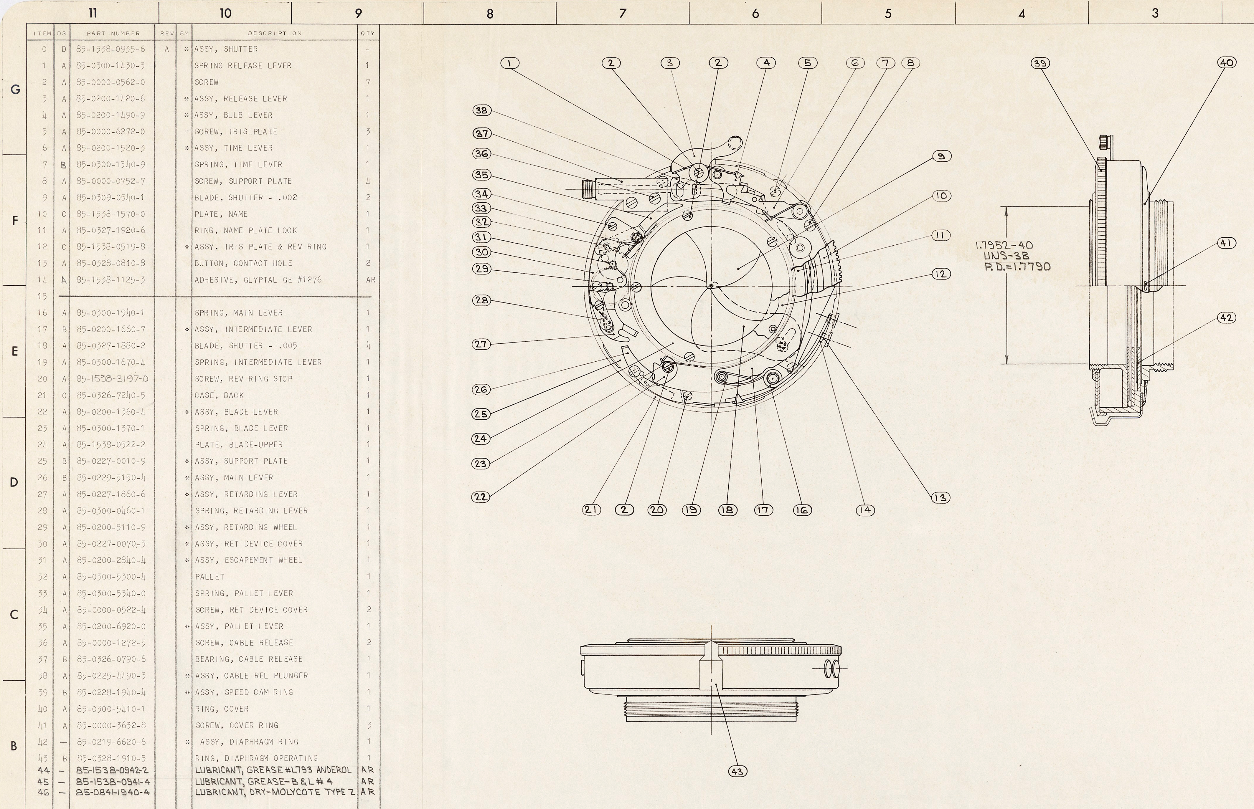

Read and weep:

Thanks Dan From! I'll need to study these charts and determine what make my Graphic Kodak Flash Supermatic shutter is. It says made by Kodak but maybe it wa
I have a Century Graphic 23 with a Kodak Ektar 101mm f4.5 lens in a Kodak Flash Supermatic shutter. I have never liked this shutter since I worked on them at National Camera in 1973. Like mine, most of them are flat worn out and erratic, no matter what you do to them! I'm looking at a Wollensak Raptor 101mm f4.5 in a Graphic shutter on eBay with a very scratched front element. I'm hoping and need to know if my Ektar, front and rear groups, will fit in this shutter in place of the wollensak?? My Ektar front group has 29.5mm thread. Does any one have information on this? Much appreciated!
Thanks Dan Fromm! I will need to study these charts further. I need to determine what my Graphic Kodak Flash Supermatic shutter is. It says made by Kodak but maybe it actually something else like Alphax or Betax. I see nothing on the charts for Kodak shutters. Of course I see Wollensak with the 29.5 thread. I got to believe the 101 Ektar will fit in the Wollensak shutter but I want to be sure before I waste the money to purchase it.

Kodak is Kodak, Wollensak is Wollensak. Each sold its own lenses in its own shutters to Graflex. The two didn't agree on shutter specifications, and there's no reason why they should.
If you want to use a 101 Ektar you'll have to reconcile yourself to using one in an EKCo shutter.
