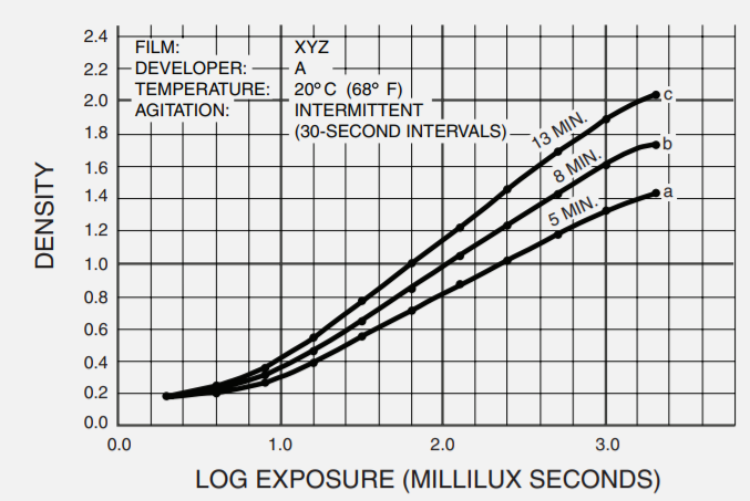

The Kodak Basic Photographic Sensitometry Workbook states that a film's "Contrast Index is affected by four variables: time, temperature, agitation, and developer activity". (I suppose with developer activity they mean dilution.)
How the contrast index changes based on development time is shown in a graph ("characteristics curve" or "D-Log E curve") in that workbook and that is also what I have seen beeing provided by the film makers for their films.
But why are those graphs only ever shown (as far as I can tell) for one of the four variables, the development time, but never for the other three variables, temperature, agitation, and developer activity. Shouldn't that be of interest to?
I have always wondered if and how modifying temperature, agitation, and developer activity modifies the contrast and overall appearance of the final negative. Would the characteristics curves (or D-Log E curves) look much differently when changing temperature, agiatation or dillution (but compensated with development time to get a proprerly development film)?

The example characteristics graph from the sensitometry workbook I posted initially says otherwise. If I scale time up from 8min to 13min but keep it at 20°C, the characteristics curve totally changes.
the contrast changes. The general shape of the curve, not so much. You would be hard pressed to see a difference between equivalent prints made with them outside of the higher contrast negative having different looking grain, assuming you’re enlarging enough to actually see the grain. A lot of this boils down to: you have 4 variables. Each one doesn’t significantly change the overall shape of the curve, but can effect contrast. Development time is the easiest to change, so that is what is presented.
