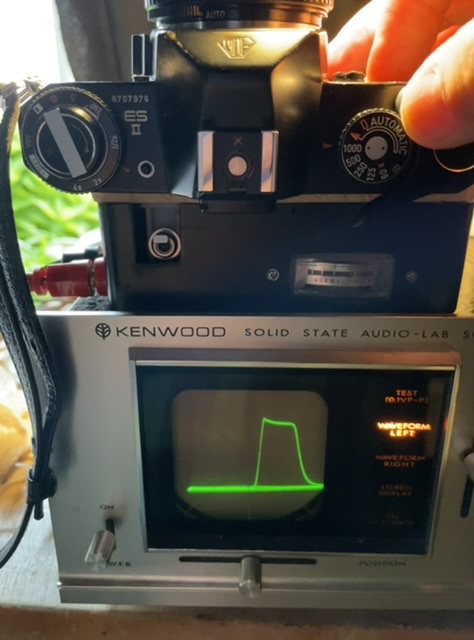

There’s always some challenge. The old scope had fritzed on me decades ago so I put it away until now. On a rheostat I found it was fine at 80 volts line power. Mouser came through with some high voltage capacitors and the first one worked, got it on the line now.
Although this reveals shutter time, it doesn’t measure curtain speed.
I’ll need a two sensor arrangement to get that info.View attachment 312889
Love the Kenwood scope, beautiful piece of equipment.
Thanks awty! I like your recent media too!
