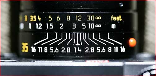

This is a bit of a stupid question, but I thought that if you want the infinity to be in focus, you set your lens to infinity and set the infinity sign to the f stop you are using.
But, somehow my photos are not that sharp.
When you are photographing a landscape, how do you go about focusing?
Also how do you go about focusing if you are focusing on a stone, that is middle distance away.

What do you mean "set the infinity sign to the f stop you are using" ?

DoF scale.

That had occurred to me, but I read the original post to mean that the OP wanted the most distant subject to be in focus, rather than wanting as much as possible of the scene to be in acceptable focus.

Both a Leica with a Summicron DR and a Hasselblad Planar 80/2.8.
Yes, that´s kind of what I meant, I thought that if
my meter says 1/125 and f/11 I would put the infinity mark at 11.
Which would mean that everything between x meter and infinity will be in focus.
In the above example between about 2 meters to infinity.
So if you decide a distant mountain or a hut (in example above) more than 30 meters away, would you focus through the camera, or can you actually use the DoF scale?
For landscapes, I would normally want as much as possible in focus.
My last roll was out of focus and I used the DoF scale to focus, but it was also very windy, on the Leica/Summicron I used 1/50 as shutter and on the Hasselblad 1/125 most of the time (it´s understandable 1/60 could be shaky).
I know these are two different questions, but I would like to know you people normally focus in landscapes in order to get as much as possible in focus.

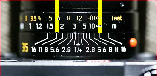

Auroraua,
If you use the image that I posted and use the f11 that you mentioned, you should be able to have between approx. 1.8m/5' and infinity in (somewhat) focus. See the yellow lines.
Whenever I use this type of scale (or even when using DoF charts), I err on trying to have more room on each end that I require to have a buffer. These scales are not super accurate; more a guide than a rule.

The fundamental problem is that the DOF scale for most manufacturers assumes the viewer of the 8x10" photo, at a viewing distance of about 12", has worse visual acuity than reality. If you have f/8 on the lens set, then put the Infinity mark next to the f/8 mark on the DOF scale, the human eye WILL DETECT focus blur at objects at Infinity. That is one reason why very long time shooters will use the f/5.6 mark on the DOF scale, rather than f/8! Even that compensation of the DOF scale is optimistic, though!...
Using the photo in Post 6 as an example, it is 35mm lens, and at f/11 the DOF scale says about 5.75' - Infinity is 'in focus', and the focus scale is at 12' primary focus distance.
  • If we use a standard DOF program, it agrees that DOF is 5.88' - Infinity at f/11 when lens is focused at 12'.
  • If we use a DOF program that allows selection of 20/20 visual acuity for the viewer, it says that the DOF zone is actually from 8.9' - 18' with aperture at f/11.
Looking back to the photo in post 6, we see that 20/20 vision DOF of 8.9' - 18' is more similar to the lens DOF scale marks for f/2.8 and primary focus at 12' !
