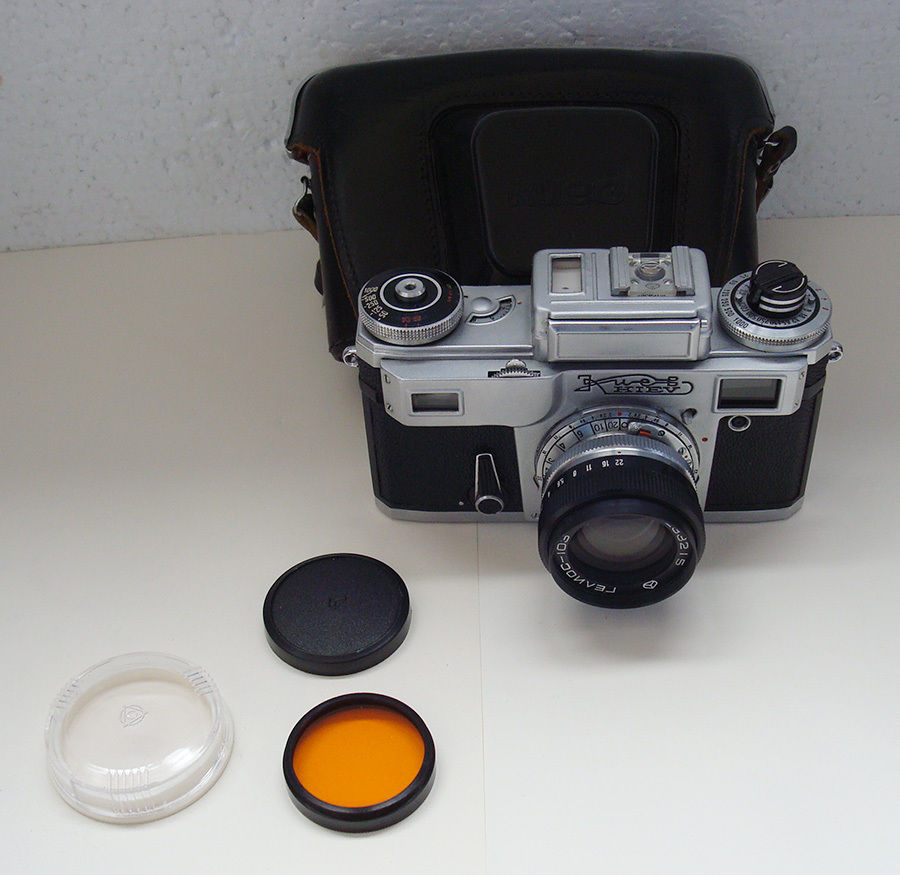

A few days ago I bought a Kiev 4m with Helios 53 1.8 lens from a seller in Ukraine. It's not the most reliable RF but that's the one I really wanted. And the price was lower than most of the others mentioned in this thread. The seller claims it's been tested and in good working order. It would be almost impossible to find one in my home country(USA). And most of the analog cameras on EBay from US sellers have descriptions like "estate sale find", "I know nothing about these", "everything SEEMS to be working fine, but I have no way to test it". Here's a seller's pic.
