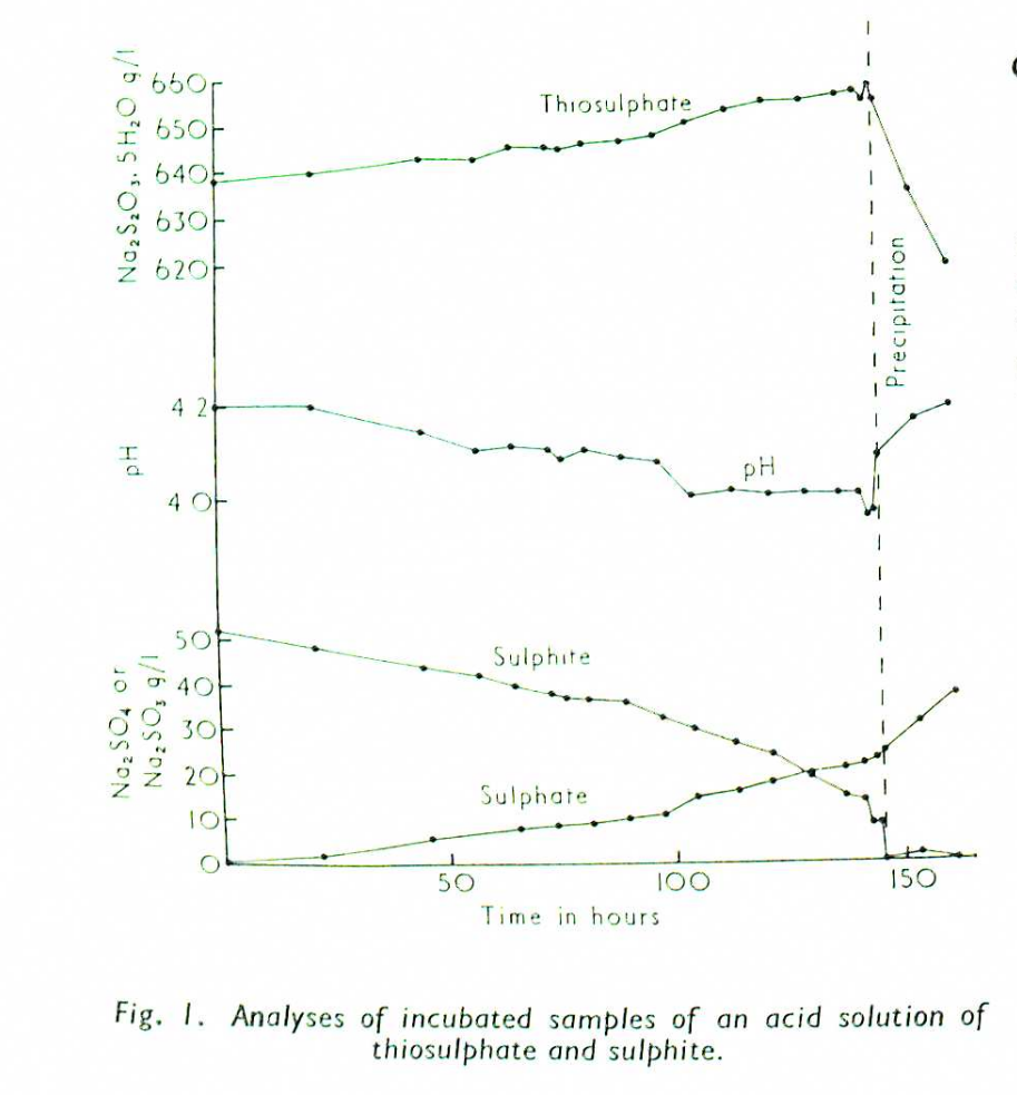

Ammonium Thiosulfate 60% is said to be stable. It is a very concentrated solution, and Oxygen will not dissolve very well. I have not seen Ammonium Thiosulfate 60% go bad yet, even after years of storage in hot area at least during Summer.
Once you dilute it and optionally mix in sulfite ions, you get several effects:
  1. Oxygen will attack first the sulfite ions, then the thiosulfate ions. In both cases pH will drop, and it will drop faster when thiosulfate ions are oxidized.
  2. If the resulting liquid is acidic, Sulfur Dioxide will form and leave the solution (c.f. smell of rotten eggs). It will do this faster at lower pH, but not at neutral or alkaline pH.
  3. Sulfur Dioxide also goes through the reaction 4 SO2 + 3 H2O <===> 2 H2SO4 + H2S2O3. Obviously the speed of this reaction will be proportional to amount of available Sulfur Dioxide, which means much faster at low pH. This is a disproportionation reaction, which will also take place in a perfectly sealed container!
  4. if pH drops below 4, the thiosulfate ions will decompose into sulfite ion and sulfur. Once that happens, your fixer is toast.
If you just dilute the Ammonium Thiosulfate concentrate, you will at first see action (1), which will then quickly devolve into action (4).
If you have a neutral or alkaline fixer at working solution strength, sulfite ions stay what they are, they do not form Sulfur Dioxide. Oxidation will very slowly oxidize first the sulfite, then the thiosulfate, but it will not sulfur out.
If you have an acidic fixer, there will be a combination of sulfite decomposition (= release of Sulfur Dioxide), sulfite oxidation and sulfur disproportionation. The close pH is to 4, the faster the sulfite decomposition process will be. Once all the sulfite ions are decomposed and/or oxidized, oxidation will drop pH quickly and your fixer will go bad.
Conclusion: a reasonably buffered Ammonium Thiosulfate based fixer with 10-20 g/l Ammonium/Sodium Sulfite will last for months as used working solution. Right now we use cheap Tetenal color fixer, diluted 1+9, and the working solution lasts at least a month and goes through a half dozen darkroom sessions in this time. Fixer pH is about 7.5.
PS: I have never read about this disproportionation reaction of Sulfur Dioxide in photographic literature geared towards amateurs. It has been described in scientific literature, though, e.g. The Stability of Concentrated Thiosulphate Solutions at High Temperature. Part II: The Loss of Sulphite, by E. R. Brumpton and G. I. P. Levenson, in The Journal of Photographic Science, vol 13, p 79ff. The attached graph shows this effect including the increase in thiosulfate concentration during fixer decay.
john_s
Nov 19, 2002
2,140
Melbourne, A
Thank you Rudeofus for this thorough explanation.

Rudeofus
Aug 13, 2009
5,081
EU
Mr. Bill: the article I quoted uses a highly concentrated fixer at elevated temperatures to show the claimed effect. This is not also not a rapid fixer - it's based on Sodium Thiosulfate. Its concentration is much lower than Ammonium Thiosulfate 60% solution, because we're comparing weight/volume with weight/weight.
Another big difference between this article and your lab setup is pH: color processes typically used pH close to neutral, whereas the effect observed in this article happens slightly above pH 4.0.
PS: I would be deadly afraid of a gallon sized Ammonia spill, but assume, that typical amateur level dark room users do not try to handle such large amounts.

Rudeofus
Aug 13, 2009
5,081
EU
What I'm trying to emphasize is that a thiosulfate-based fixer should always have a surplus of sulfite ion in it. I've never seen a fixer come apart as long as it still had spare sulfite.
This is what the chart posted by me clearly shows: sulfite going going going, and as soon as it's gone, the fixer sulfurs out. What this chart also shows: even if you keep Oxygen completely out of your acidic fixer, it will eventually sulfur out. So basically yes, you need sulfite, and as long as the fixer is neutral or alkaline, the sulfite will actually stay in the fixer.
Conclusion: unless you absolutely need to harden your emulsion, ditch these acidic fixers and use neutral ones.
