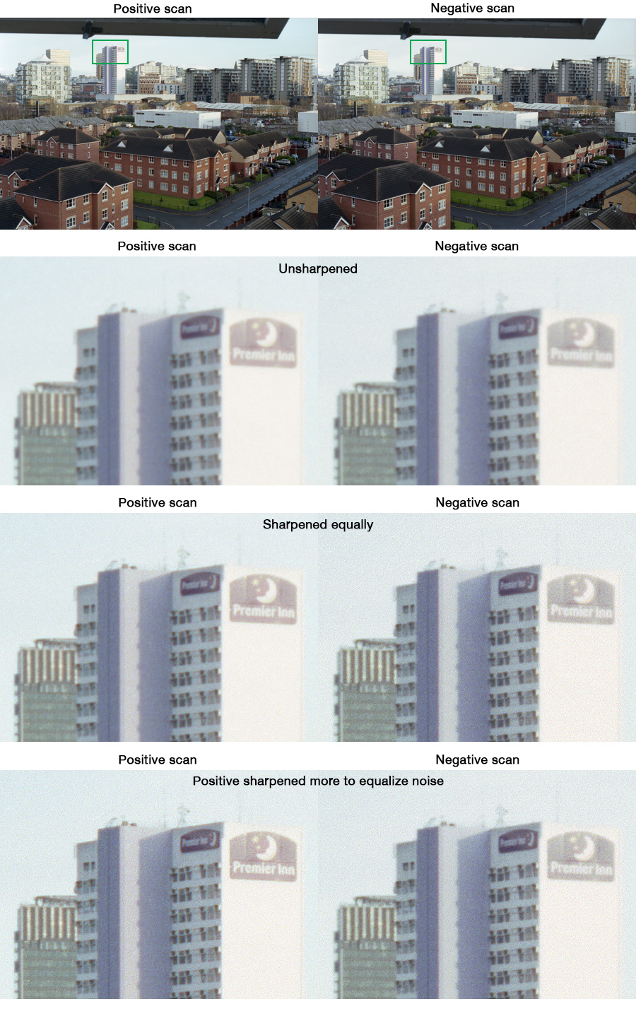

Here is an example:-
The scan on the left was done as a positive, colour controls on, histogram sliders set as above. The scan on the right was scanned as a negative with 'No color management'. Both were scanned at 6400ppi and saved as 48 bit TIFFs, resized to 3200ppi, then the colour transformations done as a series of adjustment layers in Photoshop. I did my best to equalize the colours. They are both scans of the same 35mm film frame. The film was not moved between scans. The negative has quite a long tonal scale, so the highlight area depicted is fairly dense. It is a very sharp image which contains more detail than the V700 can resolve. The film stock was Fuji Pro160S.
Anyway, see what you think. Maybe some of you already use this method. I suspect the other V-series models will behave similarly. These tests were done using Epson Scan II, but I'm pretty sure the V700 behaves the same with the former version. I'd be interested to hear the experiences of others.

Ok. You can get significantly better image quality from colour neg film on an Epson V700 and Epson Scan if you scan as a positive. The scanner uses multi-sampling in positive mode but not in negative mode. You get less noise, smoother tones and a bit more detail. Takes longer, but for me at least, it's worth the effort.

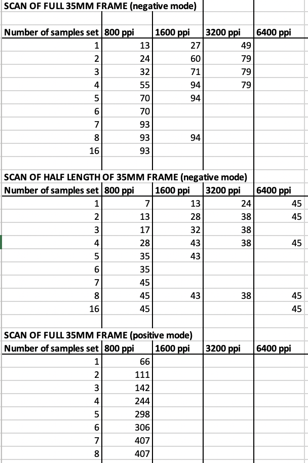

I have done some more testing with Vuescan's multi-sample function on the V700. I recorded the scan time for several scanning resolutions and gradually increased the number of samples requested. Timings only included actual scan time - not calibration or scan head travelling time. Results are posted below.
The results strongly suggest that for any given scanning resolution, there is a maximum number of samples which can be taken - more samples can be taken for lower resolutions. For scans of 35mm width, this is 7x at 800ppi, 4x at 1600ppi, 2x at 3200ppi and just 1x at 6400ppi. It may be that for different scan widths, this will change - I haven't tested for this.
Looking at the scans produced, it was fairly clear that quality was increasing as the scan time increased, but then stayed the same after that, so I'm fairly confident in assuming that if there is no increase in scan time, no extra samples are being done. Scan times increased in a linear fashion as extra samples were taken - ie. 2x samples takes roughly twice as long as 1x. 4x takes roughly four times as long as 1x, up to the 'limit' - after which there was no increase in scan times.
The pattern when scanning in positive mode appears to be exactly the same, albeit with much longer scan times overall.
Scan times are given in seconds.

Yes when scanning in positive mode on Epson Scan using the method I described in the original post, there is absolutely no clipping in any of the channels, highlights or shadows, if you set the sliders correctly. You get access to the full range of tones in colour negative film quite comfortably.
I suspect your are right about Epson Scan not doing multi-sampling (though hard to be sure), but it appears that the extra exposure done in positive mode provides substantial benefits for scanning negatives. If I had to guess, I'd say that the negative scanning mode uses a minimal exposure to increase scan speed, resulting in the image data falling into the lower portion of the sensor's dynamic range, giving quite noisy files - especially in denser areas. The sensor seems capable of dealing with the increased exposure used in positive mode without clipping any of the channels, resulting in much less noisy files and better scans.
Thanks for all that testing. Can you explain the sampling numbers? I don't know what they mean? For example, in the first chart, Number of Samples Set is 2, then for 800ppi you have a 24. What does the 2 mean? What does the 24 mean?
Do you have final results in the form of images that we can compare for the various settings? Or at least two that compare a normal single scan with Epsonscan vs the best you can do multisampling with Vuescan?
The first column is the number of samples 'requested' in the software. The subsequent columns are the scan times in seconds for different scanning resolutions (actual scanning time - it doesn't include calibration or transport of the head to the scanning position). So in your example, 24 is the number of seconds the scan took when number of samples was set to 2 and resolution was set to 800ppi.
In terms of showing examples, I may get around to doing that, but it takes quite a bit of time to do. Thing is though, anyone interested in getting the best quality possible will want to scan at the higher resolutions, and my tests seem to show that Vuescan only offers limited multi-sampling capability at the higher resolutions (and none at 6400ppi, which is what I would use), whereas scanning in positive mode (at least in Epson Scan - probably in Vuescan as well) gives increased quality at any resolution.
