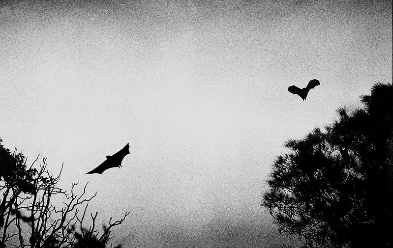

To me it looks typical of a dense/fogged 35mm negative. To get the final print may of been a combination as you say.
I love the eyes of the birds.
Think I need to but eyes on my bats.
Release The Bats. by Paul Fitz, on Flickr

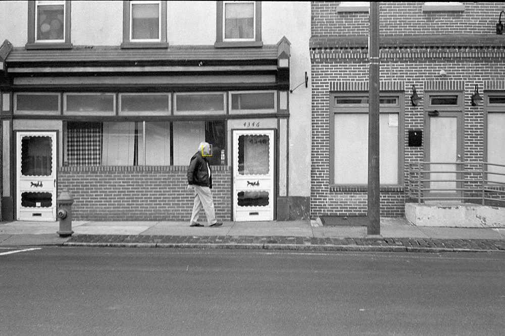

Examples below of my first experiment, which is limited to what I can achieve with basic hobby equipment. The first image is a generic scene showing the entire 35mm negative uncropped. The area we're interested in is hilighted (from ear to chin):

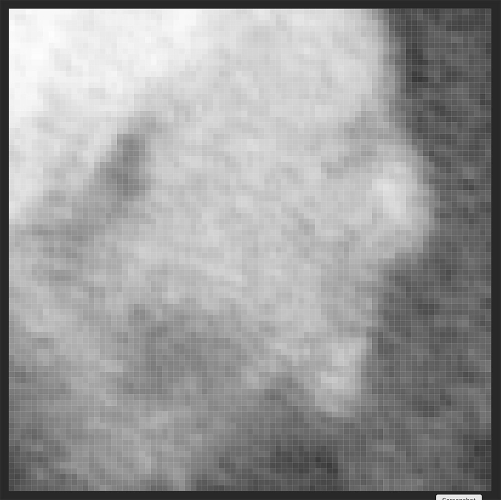

Here is that area at the limit of my Nikon scanner. A 2900dpi scan results in a square that is 85 pixels across:
And the same crop from a scan of a wet print using an Epson V700:
I like that the Epson is showing more information than the scan, and that I'm seeing the building blocks of the image depicted as organic shapes rather than pixels. I think I'm seeing a combination of film grain, paper grain and paper texture, all of which are good. There is nothing in the Nikon scan that I would use.

That shot is just great Paul and does remind me of Fukase. I like the grain but want 10x that amount of grain if possible, so I can barely identify them as bats. I know that sounds ridiculous but here we are in a ridiculous world. :smile:

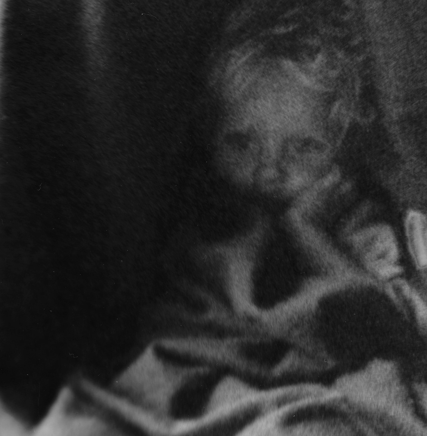

This is something I was working on, just a close crop of a HP5 35mm neg on a post card sized print. If I maxed out my durst 1000 enlarger and used a 35mm enlarger lens I could print to about 8x10, if I made a larger negative using Ortho film I could make an even bigger print with huge grain. I get too much artifacts when enlarging digitally, which wrecks the grain.

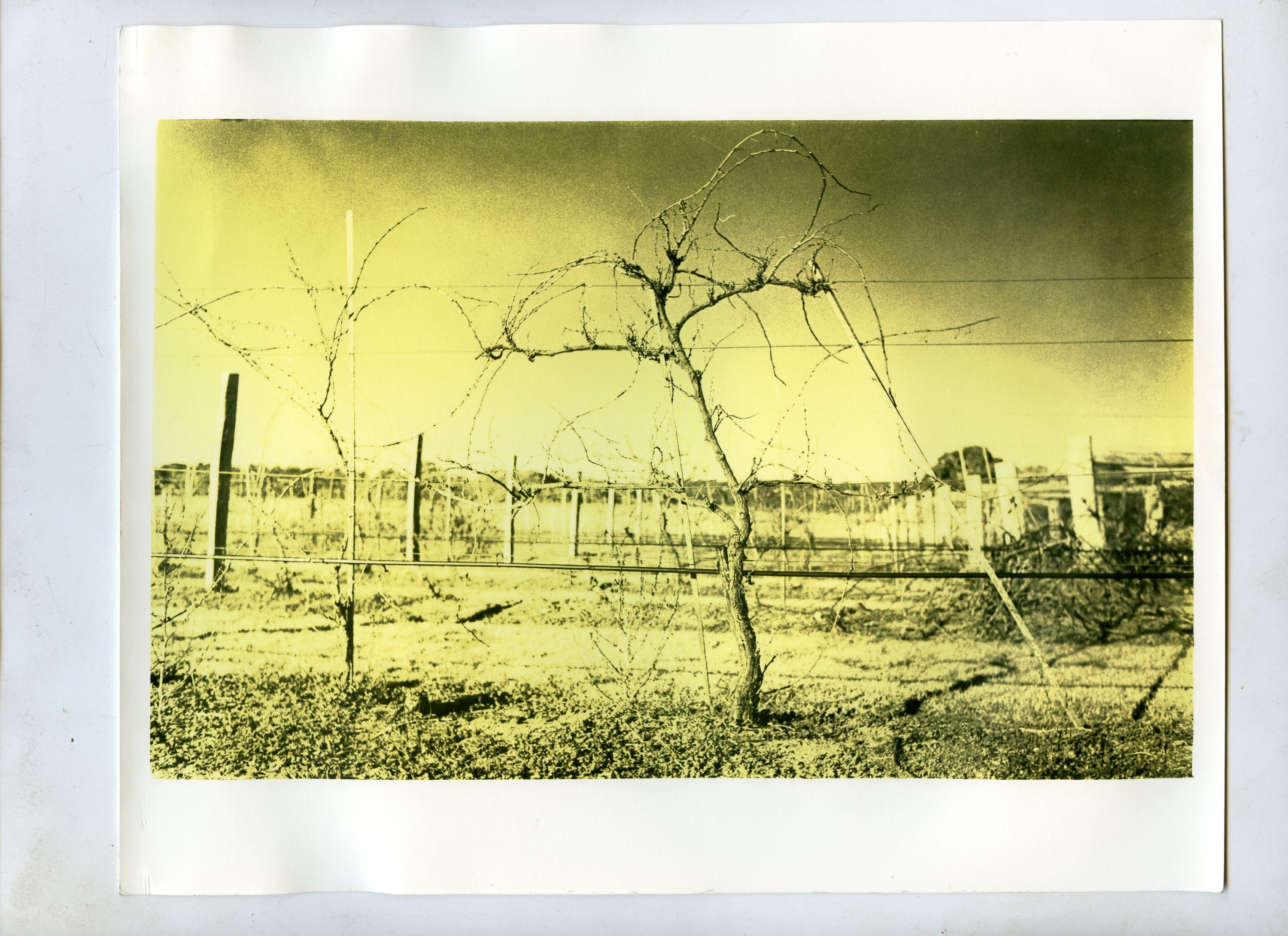

Another effect is to over expose the paper and bleach back some grain.

Now you're talking, I like that print of the child. But, you know, it could use a little more grain. :D
That old man's head I wet printed was about a 35x enlargement and I want to go at least 50x but I'm so far away from the enlarger lens that the light is too dim to focus well. I'll keep at it until I reach the point of diminishing returns. This is a good exercise for me.
