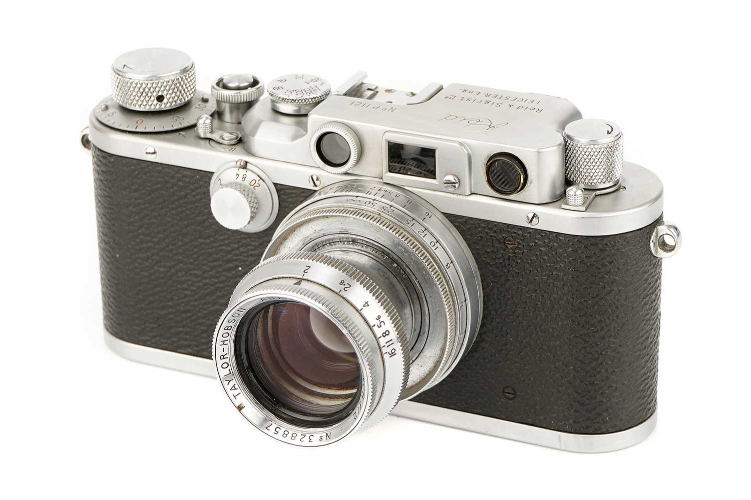

Reid and Sigrist. If I could afford one, I would buy it.
I too was going to suggest the Reid 3. I have never owned one but used one, way back in the 1960's. They were 100% superb, in my mind better than the Leica 111b they were based on. I would go as far as saying it was better than the 111f that I did own.

Like Clive it would be a Reid III. In the 1970s cases of unfinished Reid cameras and TT&H lenses were found in storage, technicians finished them and they were sold through AW Young and a couple of other London surplus dealers for around £21. I had no income at the time as a student . . . . . .
Ian
