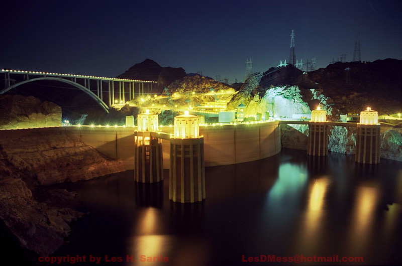

Just to be sure, when it comes to night time shooting there is none like the Pentax LX. It is the only camera ever made that can aperture priority auto expose a shot for as long as it takes or batteries run out. All the while monitoring the scene for changes in lighting and adjusting exposure accordingly.
I have taken aperture priority autoexposures lasting hours long. This night shot of the Hoover Dam taken on Kodak Ektar 100 took about 45 minutes.

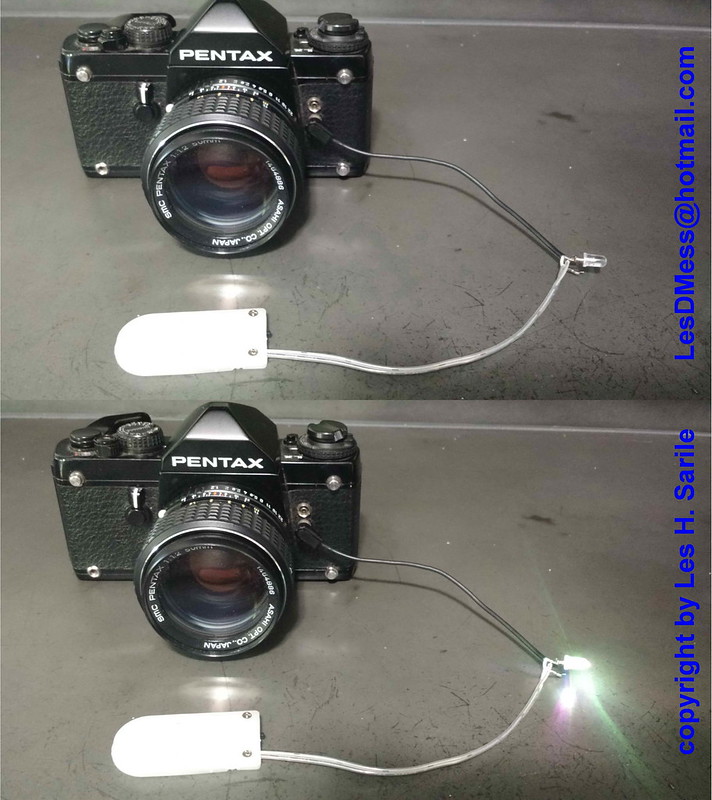

Was a real pain taking shots that last this long as there is no external indication when exposure is done. I had to keep looking through the viewfinder to see if the mirror had gone back down. Which on unpredictably long exposures was a pain. Fortunately, another user pointed me in the direction of using the flash port and I was able to device an LED indicator that would show it was done.
Shutter open indicator B by Les DMess, on Flickr

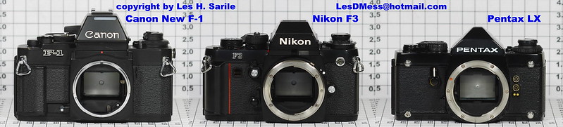

The Pentax LX is definitely lighter than any medium format camera. Despite it having interchangeable VF, it is more similar to fixed VF cameras like the FM3A you point out.
Size Lineup by Les DMess, on Flickr
Not like it's peers in terms of size and weight.

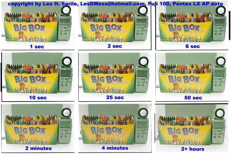

Of course the LX does not account for film reciprocity. In fact there's not a camera that does. So I checked out some C41 film data sheets and they all state to test under your conditions and times. So I did.
This with Fuji 100 . .
Fuji 100 long exposure by Les DMess, on Flickr
This with Kodak Gold 100 . .
Gold 100 long exposures by Les DMess, on Flickr
Since I didn't notice any reciprocity issues I didn't bother doing anymore of these tests on other films. Instead, I would just shoot them and so far so good.
