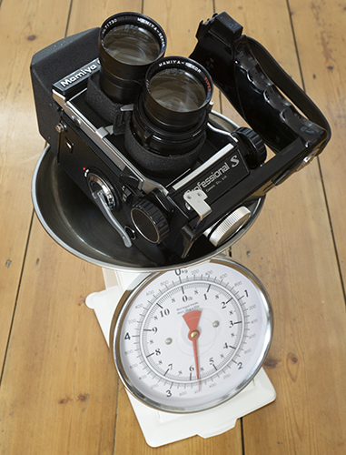

  • The C220 is one of the lowest weight interchangeable lens medium format cameras, and the other competitors for this title are ten times the price (hasselblad, mamiya 6). It even compares well to a Rolleiflex 2.8F (1.25 kg rollei vs ~1.5 kg mamiya with 65, 80 or 105mm)
