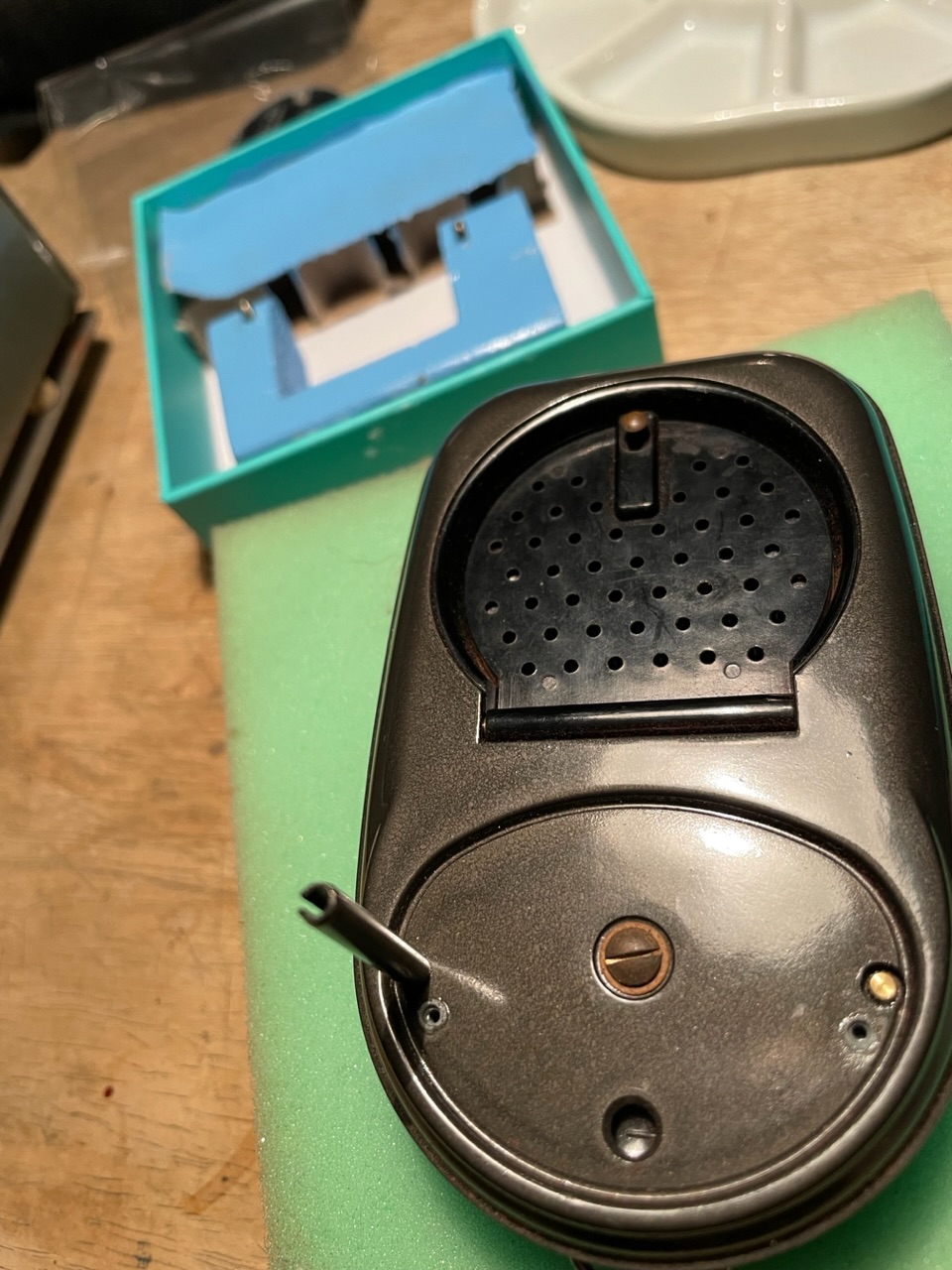

It only takes a simple tool. I took one of those split pins and used a carbide tipped scribe to cut “flutes” to match the milled screw head.
I’ve gotten to where I can totally disassemble a Master II in about five minutes, (keeping the needle, coil and magnet unit in a separate box for safekeeping)
