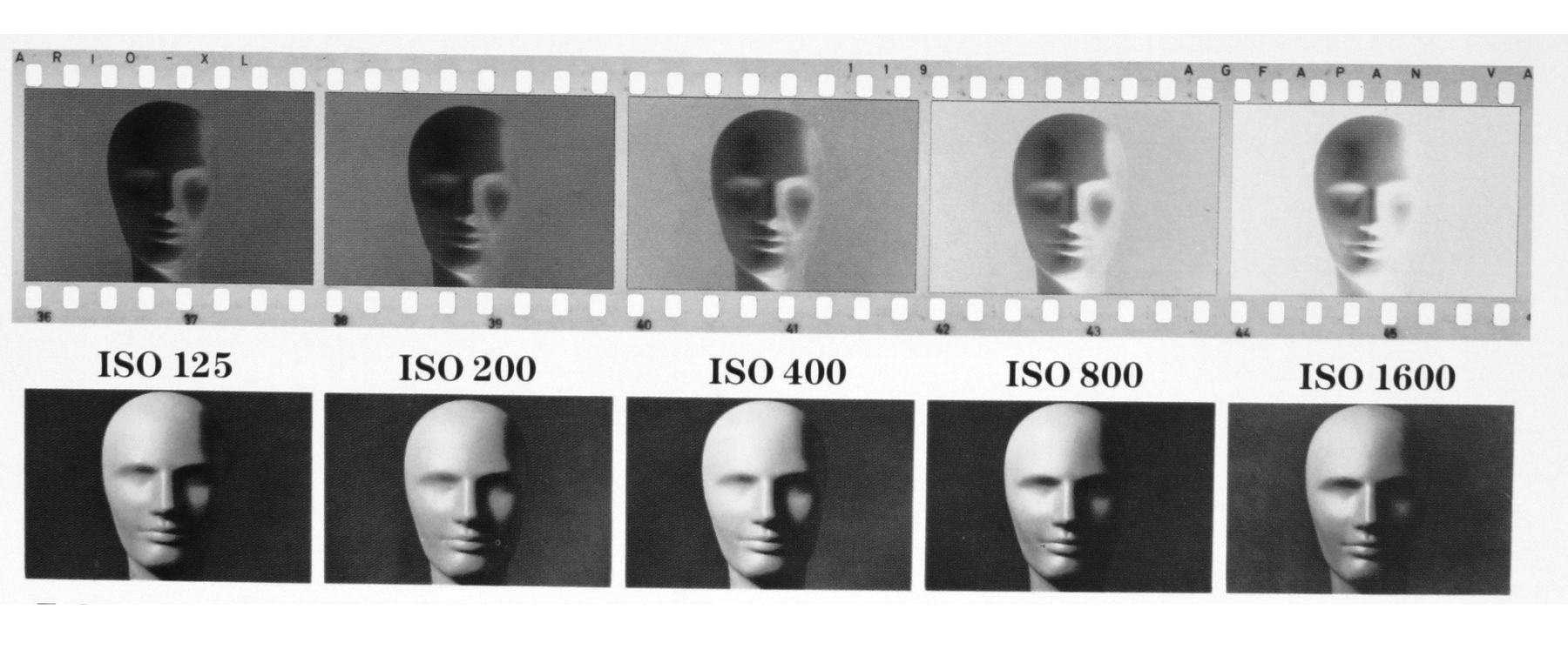

How about this idea, "one speed fits all".
