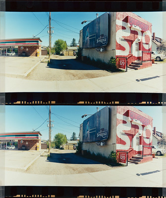

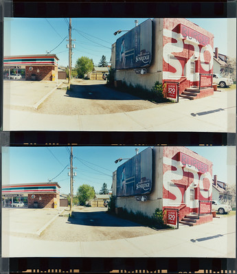

When I was gathering stuff for my darkroom I somehow ended up with 5 different enlarger lenses (Meopta Meogon 50/2.8, Rodenstock Apo-Rogadon-N 50/2.8, Nikon El-Nikkor 50/2.8 N, Minolta Rokkor 80/5.6 and Schneider Componon-S 80/4).
I tested them at a few sizes that I was likely to use. I found zero differences that I would care for between them.
I only kept small size prints that I could scan.
I thought the base line would be the Rodenstock Apo-Rodagon-N 50/2.8 (seller sold it to me in error, we both thought the item was a regular Rodagon 50/2.8, at the end I was very happy and the seller didn't care).
Here are the side-by-side scans of the prints from 50mm lenses (Apo-Rodagon is the lower print in both cases):
El-Nikkor:
Meogon:
