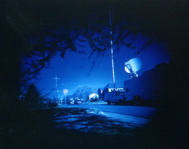

I used RA-4 color paper in camera & processed it in E-6....was a bit orange, but looked cool
I also tried RA-4 paper in-camera and processed it using standard BW developer then re-exposed to light followed by normal RA-4 chemicals...looked cool...literally, no matter how much yellow or red filters I used it was always very blue/green....but it was very fun

Good to see someone try that, DarkroomExperimente. Do you have any of them that you could scan? It'd be neat to see the results!
Nov 23, 2007
712
Washington D
I think I might, although it was 11x14 so I can scan a portion of it...I'll look
unfortunately I gave one of the coolest to the guy I took the pic of...if I was smarter I would've made him a copy
it was a fun method & worthy of more exploration
Nov 23, 2007
712
Washington D
oh yeah...the above image was developed using BW developer, light re-exposure, then standard RA4 process
I only did RA4 in E6 once...not sure where that print is...it was a 6x6cm piece of paper I put in a Mamiyaflex TLR
