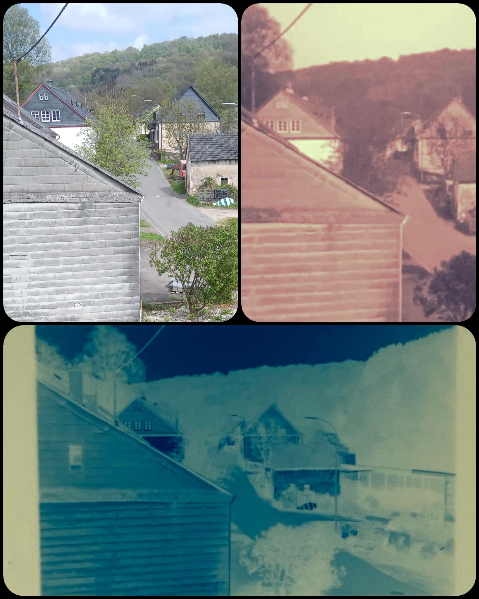

I know it has been discussed here in the past, but I gave it a go with my previously posted 2 bath Cyanotype.
After some initial tests in the dark rainy weather, where I thought, no hope, I got a relative good result.
Today with some sun, I tried again.
Here my joy to see after 1 hour with the 2.8 35mm camera a perfect exposure. To be honest I would have thought the world in UV light would look much different but seems pretty much as in black and white.
Paper : Canon Inktjet 10x15 cm sheets ( I think this is essential)
Emulsion : 10ml Dest water + 2 gr FAC + 1 gr Tartaric acid.
Exposure 1 hour in moderate sun ie there were some clouds every now and then.
developer : 20ml tap water, some K-Ferri + Tartaric acid. (about 2 gr each)
after developing rinse as normal. The color will stay a bit cyan blue, even afer a few days. So I think that is inherent to the Canon Paper.
with that paper no emulsion will come off, I brushed on the developer in these cases.
below my quick edit on the phone
1 the world as we know
2 positive edit in phone of the Cyanotype from the 35mm camera
3 the Cyanotype negative.
Cheers Jan.

- After exposure virtually nothing is visible, only when the sun has hit it direct for some time there is a slight darkening.
- When applying the developer the print is instantly visible. (could be a nice direct ready negative process by extracting through a small device with a sponge with developer.
- the curve seems relative linear, from the low to highlights. Which surprises because for normal cyanotype we have a very steep curve, here with this slow exposure it seems to behave much better.
- how to increase sensitivity further, I am thinking of adding some tiny bit of Ascorbic acid. (my first test to add this in good quantity immediately oxidized the emulsion to brown rust)
- changing ratio of FAC and Tartaric acid, I have tried 2:1 and 1:1 where 1:1 seemed more sensitive.
- adding something to the developer
- adding food colorant - which color to start, yellow, green, blue, red ? - would that be able to increase the sensitivity range?
- adding chlorophyll to the emulsion? (I would like it to stay relative simple chemical wise)
Some observations is current process already having extended range of sensitivity?
- I made a small test yesterday, with some items, Slate, terracotta, Orange, Banana. grass , twigs.
All items look to have similar gray color as expected, except the Oranges they were the darkest black ie seem to absorb all UV
I find it nice working with this paper,you have to take care to work in dim light as it will expose when in light, but it allows handling like lumen photos but then develop to the examples i have shown.
Hope to hear some feedback, if not I will continue with the above ideas.
cheers Jan.

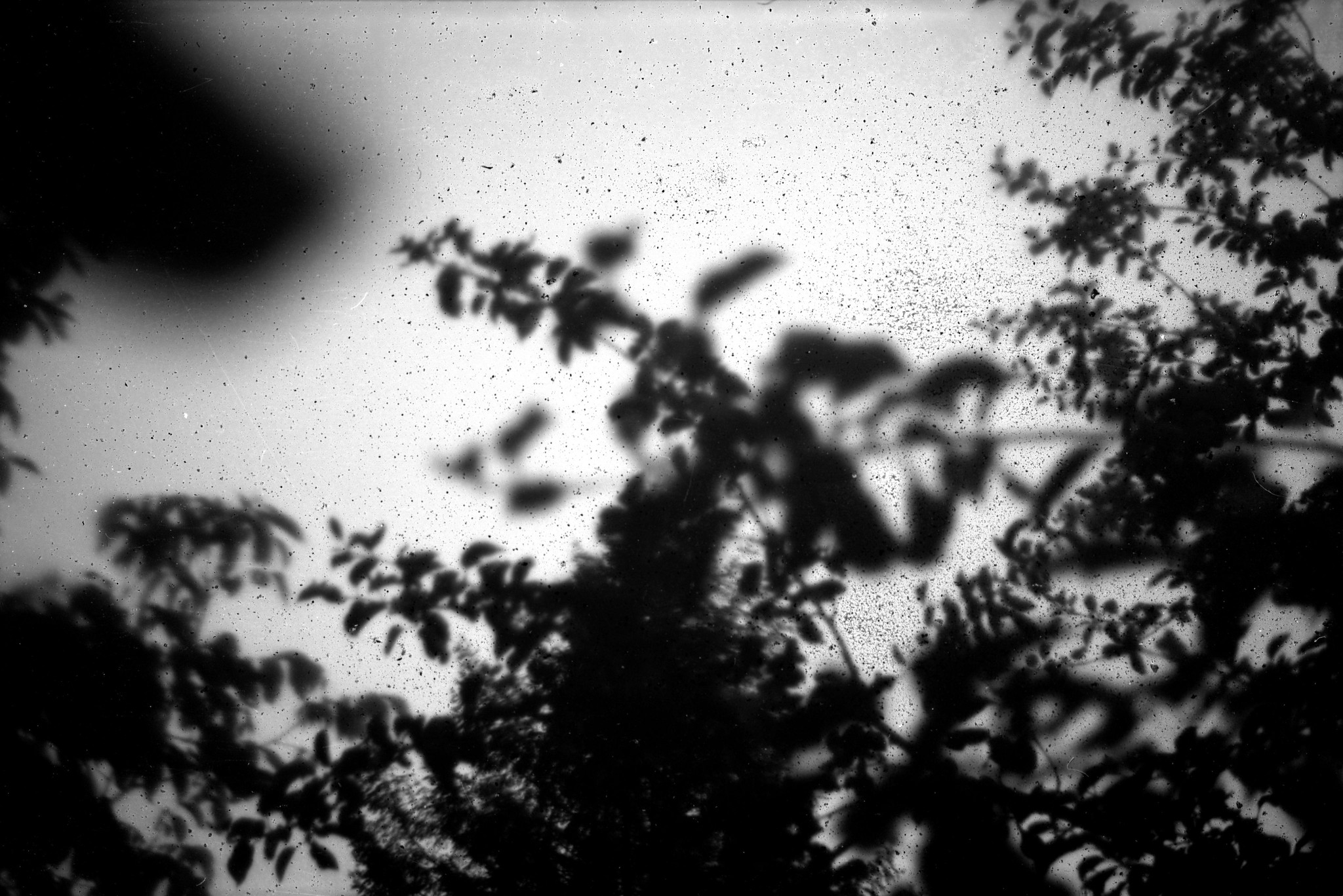

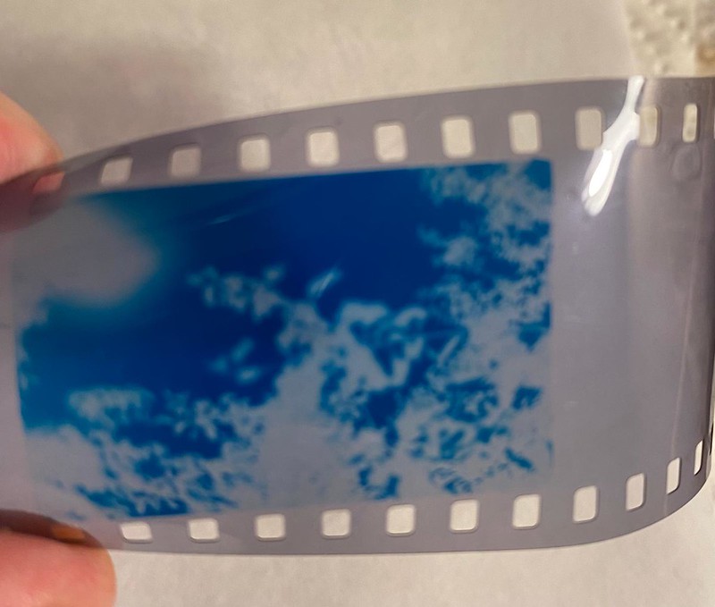

Further on this, I have not made progress increasing the spectrum but followed up on another idea I had and that is to coat 35mm film for the 2 bath process.
I started with some Ilford Delta 400 film which I fixed to clean it. Reasoning that the emulsion layer would be able to hold the cyanotype coating.
After drying i checked but could not see much yellowing of the FAC but tried it in camera, dull afternoon, exposure late in the day 4pm for 2 hours. @ F 2.8 Pointing it up on the apple tree so the sky would perhaps give enough UV to expose. Developing with K-Ferri / citric acid solution. To my surprise it gave good density. Next day when dry fortunately no bleaching, nice usable negative for the scanner. It has some artifacts where the density is more but happy for the first try.
recipe for coating
- 3 gr FAC (trying to get a concentrated solution since the gelatin layer is very thin)
- 2gr Tartaric acid
- 10 ml dest water (i may have added a bit more later to ensure all was dissolved)
- 2 ml den. Alcohol
Just after development and rinsing
Scanned on Plustek OpticFilm 135i at 3200dpi
next to coat a longer strip to have a super slow film 😀
Cheers Jan.

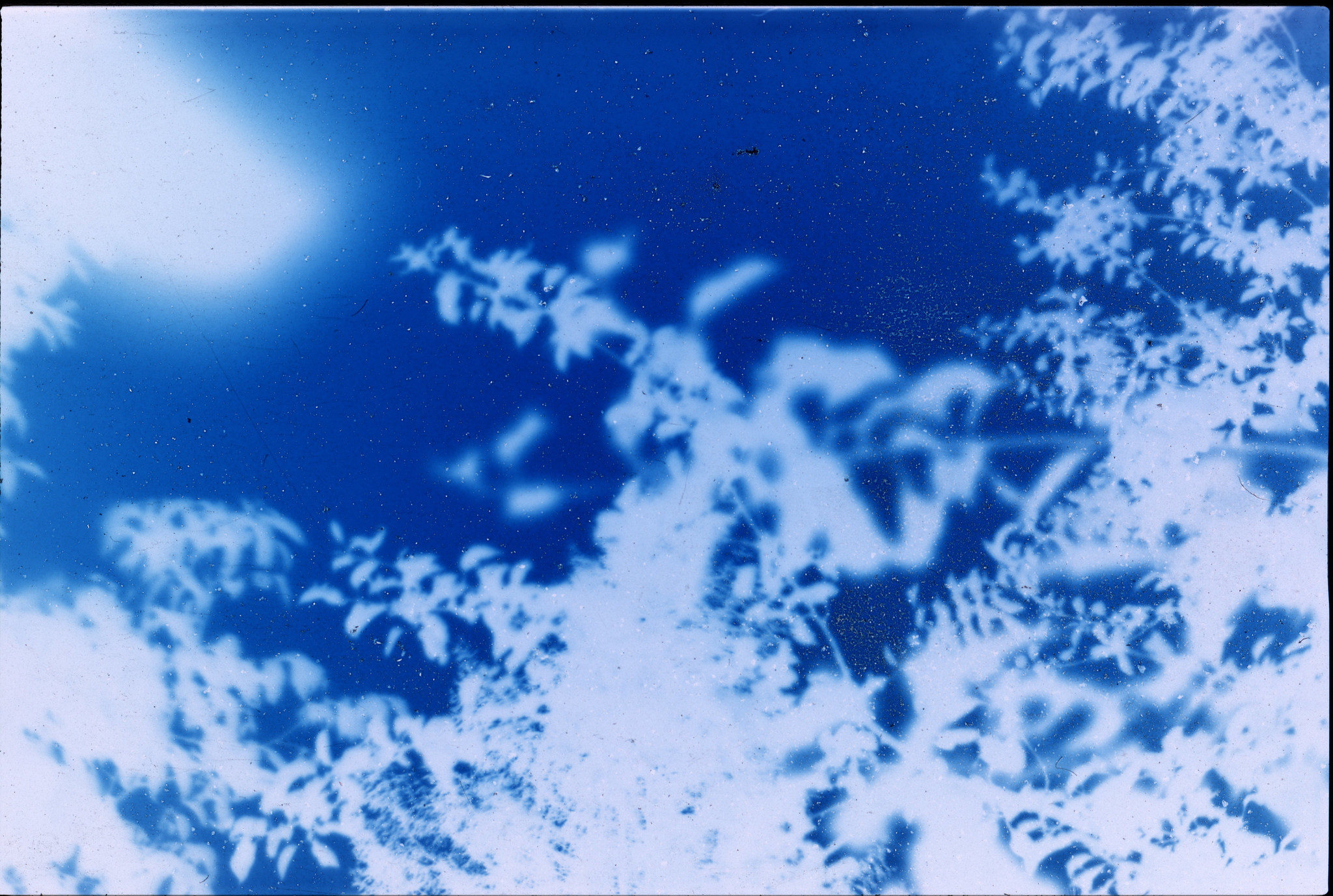

To complete the series, I also coated a small strip of film to be used in-camera for the direct-positive in-camera cyanotype, this is by adding some copper-sulfate. The action seems that in the first bit of exposure it produces the negative but faint, and after 4x exposure it creates the direct positive. Coating film is an art I can improve, but as a general proof of concept I say it is working. Perhaps pre-exposing the full frame with some UV first may start the reversal action faster.
F2.8 for 4hours on very sunny day (13-17 hour early September sun)
cheers Jan.
Awesome!!
I really like that in-camera positive in post #2! Very interesting stuff going on with the tonal inversion along the upper part of the image!
Awesome!!
Surprised also, that it did what I had in mind. based on my already found cyanotype reversal. I was not sure if it would work with film ( Ilford Delta 400 here)
Same for the in-camera negative in the post above, the gelatin of the film is ideal to hold the blues.
so I can start the factory to produce a UV sensitive only negative 35mm and positive film collection.
