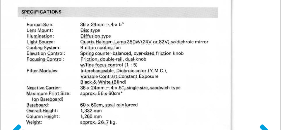

Here is my enlarger specification and I do set B&W mode while printing;
Is that configured with a condenser light source, a variable contrast light source, or a colour printing light source?
Here is my enlarger spec and I set B&W mode while printing;

Here are the choices for light source - which one do you have installed.
A digital pic of the front of the enlarger head will likely tell us.
