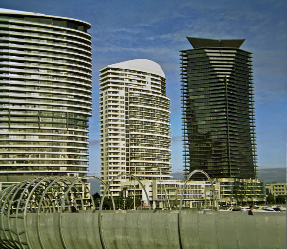

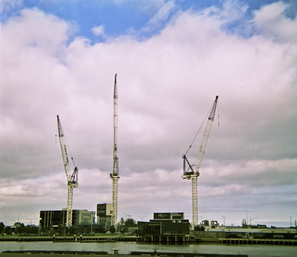

+1 to everyone who suggests the chemicals last much longer than stated.
I am on my 27th roll, I have developed mostly 120 col. negatives, a few 35mm and 5 or 6 Xpro fujichrome Velvia. Still very happy with the results.

It's hard to know if what I'm seeing is an accurate color rendition when viewing an image online, but all of those images appear to have a green cast to me, mkillmer. Do your originals have that same greenish cast?
Hi SkipA,
it's really hard to tell about the colour cast because my scanner does a white balance on the film, so I dont really see the originals. I have an older epson 1660 that changes the colour balance depending on the image every time I select a portion of the film to be scanned.
How can I tell if there is a latent colour cast?

The three images in post #79 appear weird to me as well. Picture one seems to have a pronounced green cast, the metal structure in the foreground should probably appear grey. The second one is tricky, the concrete on the ground might have taken some green overtone (moss, lichen) and the bronze (?) sphere might receive a green reflection from the concrete floor, but overall I would suspect a green cast. Besides, the magenta look of the sky might be due to the sunset hour, although one normally sees this in the West sky, and if this is sunset, judging from the shadows the sky is more a South sky. The third picture is the weirdest: the sky is skyblue on top, but there is this magenta overcast over the clouds. The lower part appears to be greenish - yellowish but that might be a false impression because there is no clear grey we can judge.

They look green and a bit flat to me too (on my reasonably-close-to-calibrated monitor), but that could be just poor choice of scanning settings. It could also be due to use of the AdobeRGB colour space, which most browsers don't support even if the image is correctly tagged. However, that could easily be down to the scans.
Scans say little to nothing about the quality of the chems - we'd need to know if (for example) the print-filter settings have drifted between the first and last rolls. And in particular, whether a test-chart looked any different. As the colour developer goes bad, I could easily imagine that the couplers started failing at different rates for different layers, and non-linearly, i.e. maybe cause a loss of speed in the highlights of one layer but not another, leading to subtle crossover (different colour balance in the highlights than the shadows). Those sorts of effects would not be immediately obvious in landscape snapshots.
