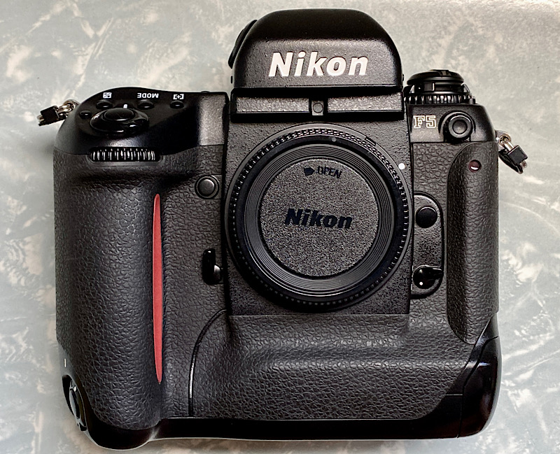

Nikon's superlative in camera construction from 1996: The Nikon F5
Flagships such as the Nikon F5 and Nikon F6, Canon EOS-1V or the Canon EOS 3 with eye-controlled autofocus obviously seem to be too much of a challenge for DIY repairers.
This also applies to all digital cameras after that.
Has anyone tried to repair such cameras anyway?
