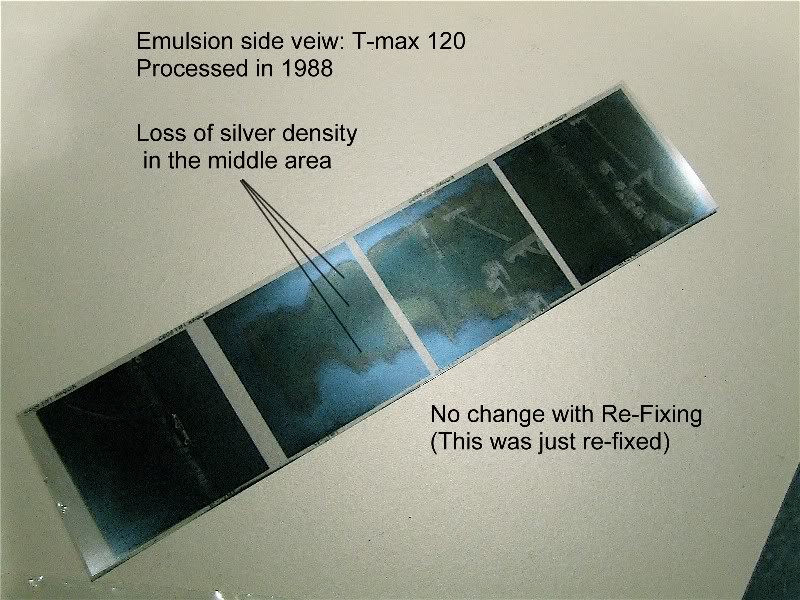

I have noticed a lot of my threads are missing the images
I have re-posted them here.
Image from post #2
Images of my notebook from post #3
