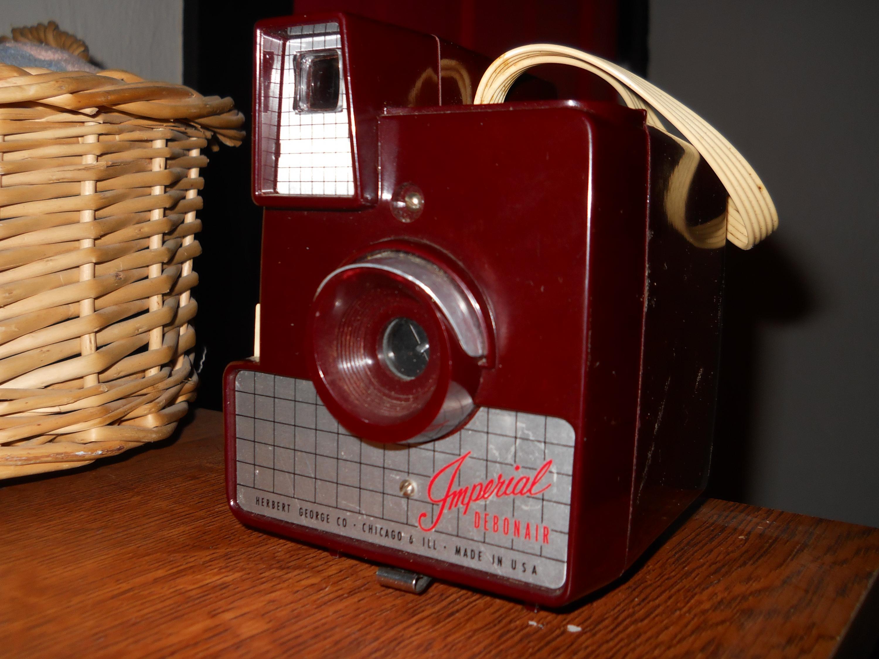

I've recently been given an Imperial Debonair camera, manufactured by the Herbert George Company in Chicago. It looks like it's a fixed focus camera with no aperture or shutter speed controls. I know it takes 620 film, but shoot, it's medium format! The shutter fires and the film transport mechanism is super simple (no double-exposure prevention either), so I plan to re-roll 120 onto 620 spools to be able to use this. Anybody know what modern film emulsions will work in this camera, or what aperture and shutter speed it uses?
I may finally actually shoot some color negative in this, as it has more exposure latitude than slide film.
Thanks!

So, given the films of the same era as the camera, you should go for fairly slow film, but with good exposure latitude. Bottom line: Pan F: no; Plus-X, FP4: yes; TMX, Delta100: maybe. If you can't or don't want to process your own b/w, your options are:
- b/w: Kodak BW 400CN, or Ilford XP2 400; both can be developed at any minilab as if they were color print films; but, starting with an ISO 400 film, even with large latitude, is maybe pushing the limits
- color: fuji superia 200, if you can find it in 120, or kodak portra 160, if you don't mind the slightly higher price. Or any color negative expired film (not on ebay, where it' sold for more than fresh film!!)
Slide film is a no-no.
With 100-200 ISO film, b/w or color, you should be able to take usable pictures in daytime, sunny to overcast weather. Shoot one film, take notes.

Before you go to re-roll 120 onto 620 spools, a process I found quite tedious, try trimming the edges of the 120 plastic spools modern film comes on. If you clip it down with something like nail clippers or an X-acto blade, some (most?) cameras will take it.
Looking it up on Camerapedia, it seems it was made in the 60s and was also branded as the official Cub Scout camera.

just about any film from asa 100 on up will work -- remember, this is a spiffy version of a Holga and depends to a great deal on film latitude to give good images.
If you use 100 you will be restricted to sunshine and brightly lit -- asa 400 will give you a lot more leeway...

I've had a couple of these fixed-everything cameras, and it seems like f/8 or f/11 and 1/50 is a common range for the settings. In full-sun conditions, I usually shoot a 25-speed ortho film in them and develop in Diafine for compensation; ASA 100 for brightish-overcast, and I suppose 400 would work for dimmer conditions, but I don't really trust my ability to eyeball the light levels at that point. In any case a compensating developer is pretty useful.
Marcy Merrill says good things about it: Dead Link Removed.

With fixed focus cameras the lens is usually set to give the best focus at about 6 to 8 feet to infinity. Avoid subjects closer than this distance for best results.

I tried Portra 400 in my Brownie Hawkeye and all the pictures were blown out. I did get some from dark shaded places that were usable. This camera is (I think) f8 at 1/45th. The Ektar and Reala 100 work great.

and speeds vary ... maybe 1/50 ... maybe 1/100
fstops may be anywhere btween f 8 and f13
