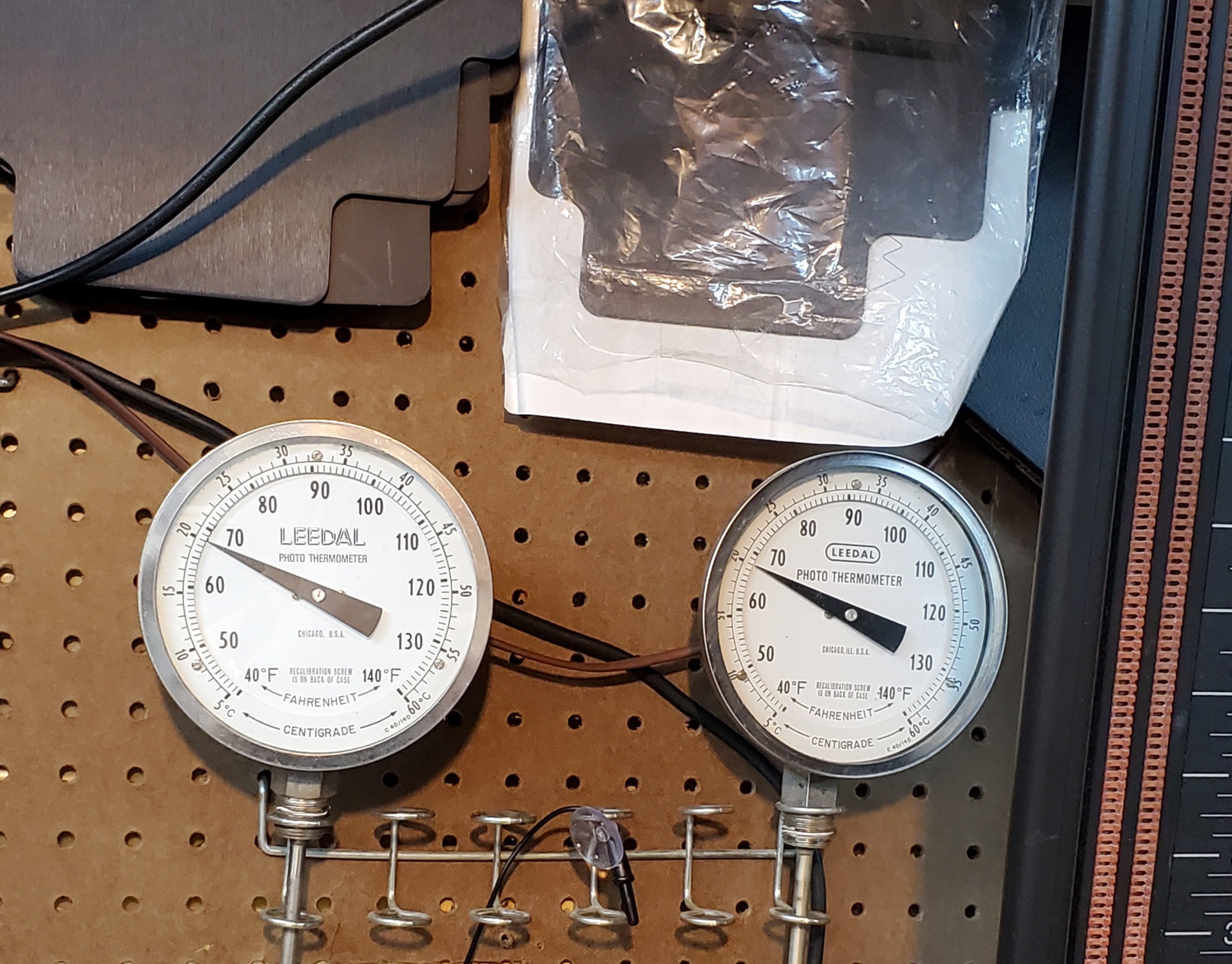

I see a what looks like a temperature probe, but got no idea how this photo is related to our topic.
