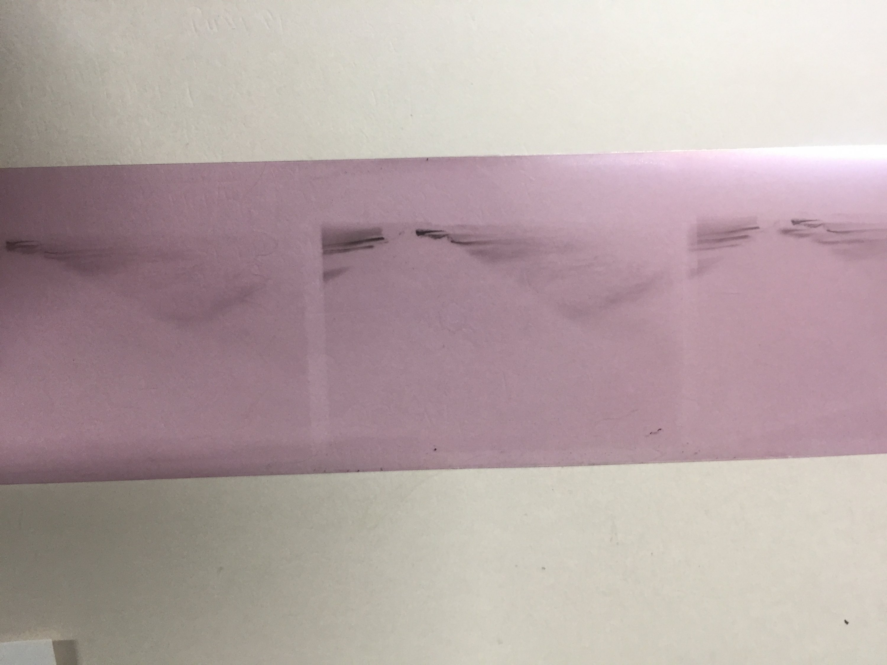

This is going to be long, so please hang in there.
First of all, I've been developing film since 1972. I have never been stumped by a problem until now.
Details:
FP4+ (120) in PyroCat HD 2:2:100 (mixed in distilled water from liquid concentrate at time of development)
Water stop
TF-4 fixer
Water wash
I have been following this routine for 7 years now (20-30 rolls of 120 a year and 50-75 sheets of 4x5). I have never had a problem and love the results. 90% of my 120 goes through my Pentx67ii (purchased from the original owner 10 years ago).
The scenario:

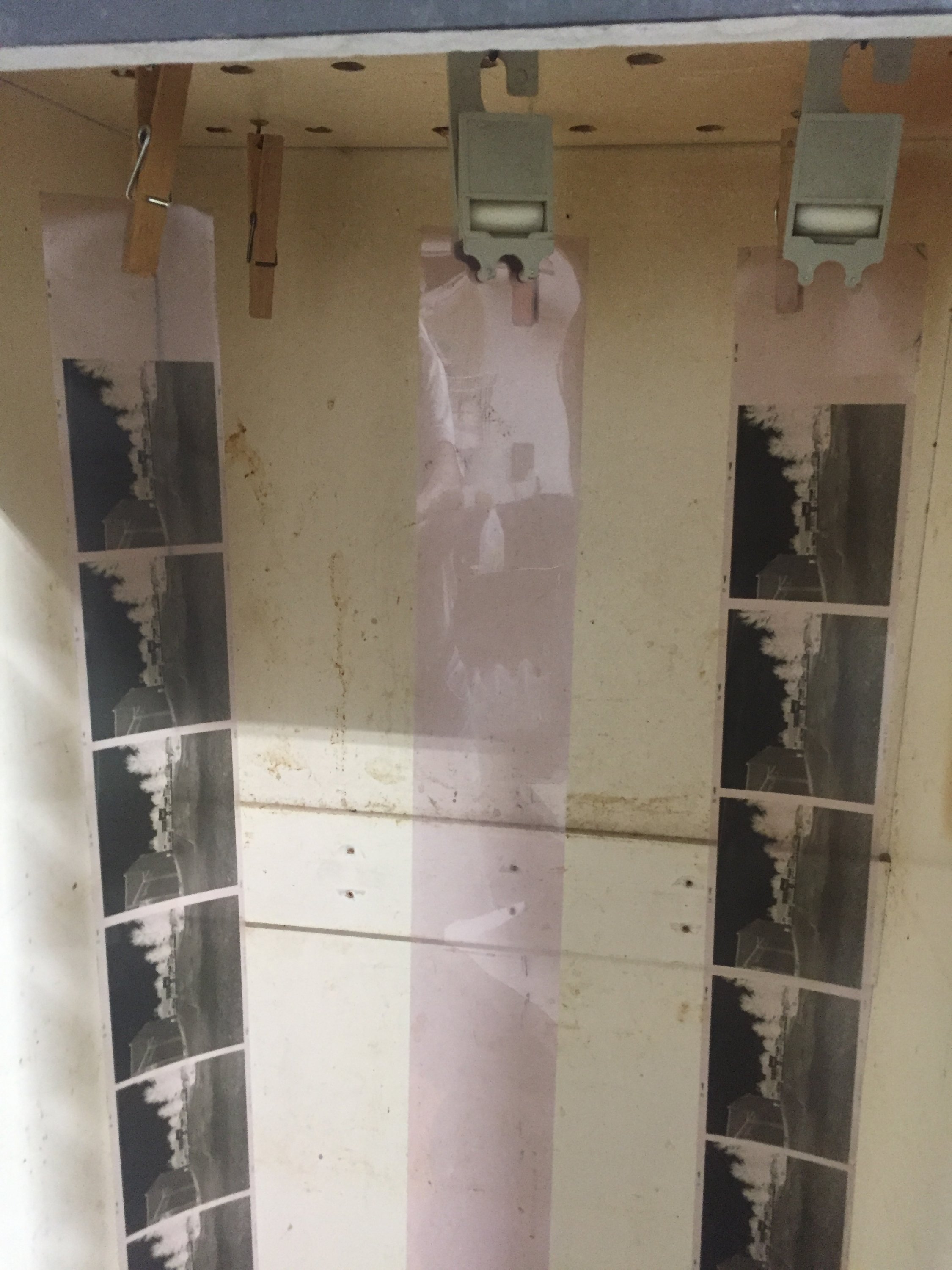

I recently returned for a trip to Colorado and had 11 rolls and 18 sheets to develop. On the last roll I developed it by itself in a Paterson tank with the normal 500ml of working solution. All previous rolls were fine. This one came out nearly blank! I could barely see an image and none of the edge markings were visible. I immediately blamed myself for mixing the developer wrong or contamination. Thankfully, I don't do this professionally!
Fast forward to this morning. I had shot a roll last night of a tremendous cloud formation near sunset and was anxious to see the results. Since my last fiasco I had been paying very close attention to my process and had done several rolls without a problem since then. Imagine my surprise when I pulled out a blank or nearly blank roll of film!! (attached). I was dumbfounded. After venting for a while, I decided I had to figure out the problem, I had to recreate it. The developer concentrates were the same I have been using for the last two months. The fixer was the same gallon.
I have never had a problem with Ilford film in years and years of using it. I checked the emulsion batch numbers and I had two different ones both expiring in 2022. So, I loaded each different batch number in the same camera and exposed all 10 frames of each, then put them in a double tank, used all the same concentrates to mix working solutions, same sequence of everything and they both came out fine! Then, just for giggles, I loaded another roll of exposed film on the exact same reel and tank and tried it again. Came out fine!
Now I'm playing Russian Roulette with the next roll I've loaded. I do have D-76, ID-11, and HC-110 on hand and I'm thinking of trying them. I sent a similar email to Ilford moments ago but, not sure what or when they will get back to me.
Any ideas??
Tim
www.schrollphoto.com
View attachment 229903 View attachment 229904
