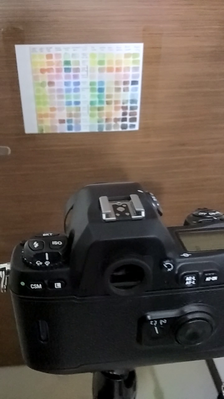

Congratulations for this courageous project. A couple of comments:
  • The "colors" whether in scene snapshots or your watercolor sampler result from: scene; film; C-41 at some lab; scanning; and also your (or my) LCD screen fro the subjective "scene" impression. So even if the watercolor patch part of the test is reproducible, it just gives relative indications. Since you mention that you have 5500K lighting (what CRI?) it might have been interesting to shoot --indoors-- a cooperative human subect surrounded by everyday objects. As in other test of color rendition.

Thank you for your comments! Actually, here in Taiwan those films are relatively easy to find. When I was living in Europe, those films would have been much harder to find. I though trying first with "uncommon" films would make the reviews more interesting, since there are many other reviews for Portra, Ektar, 400h etc. I just shoot Ektar in a trip to the Pyrenees and I'm waiting for the right situation (soon to shoot some graduation portraits ) to buy Portra :smile:.
The watercolor test is really subjective too, I thought of having the setup that you mention, but my apartment in Taipei is tiny! So I had to go for something less "Space consuming"

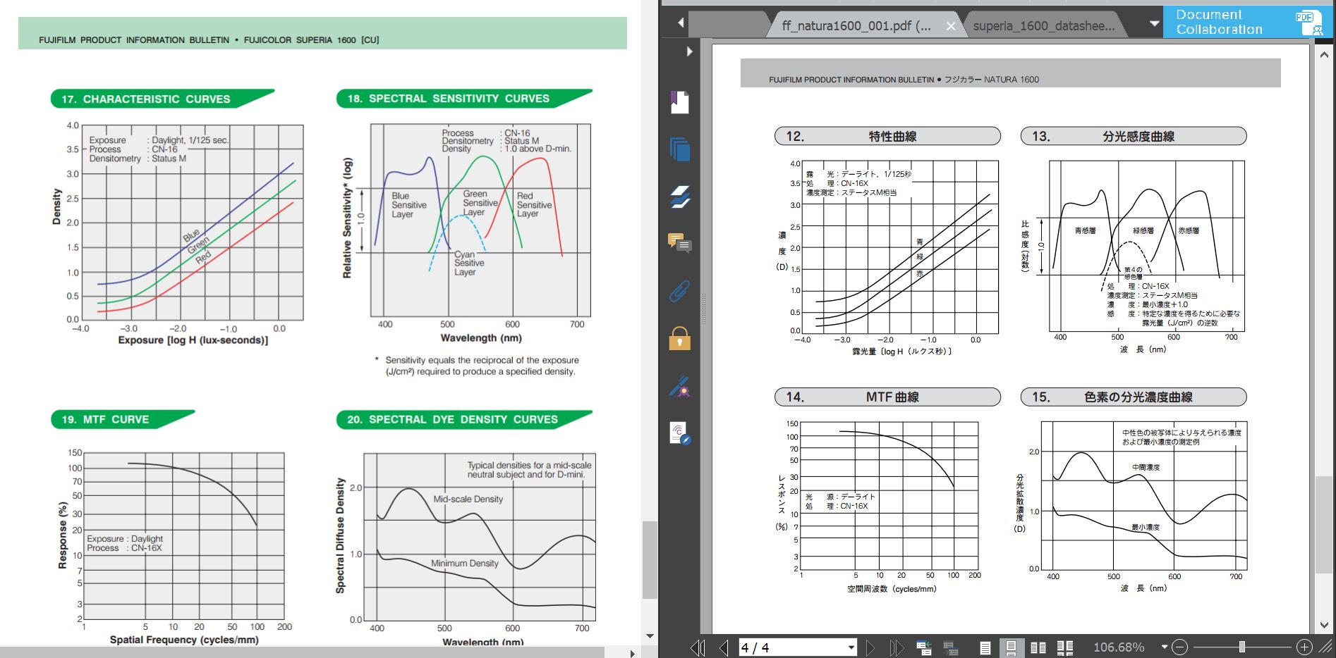

Looks to be an awesome project. The two Fuji 1600 films in question are indeed the same film. It was branded Natura in Japan to go with their Natura 35mm compact cameras. Same emulsion.

You are right, I know the iso 800 (Venus-Superia) is indeed a different emulsion, however, after reading your comment I did some research and indeed they are the same. This is the data sheets of both films and you can see that they are the same:
