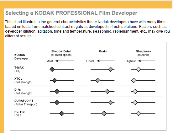

For black & white use Hewes stainless steel reels and either Nikor or FreeStyle steel tanks. I recommend replenished XTOL for shadow detail, fine grain and better tonality.
http://www.kodak.com/global/en/prof...wFilmProcessing/selecting.jhtml?pq-path=14053
