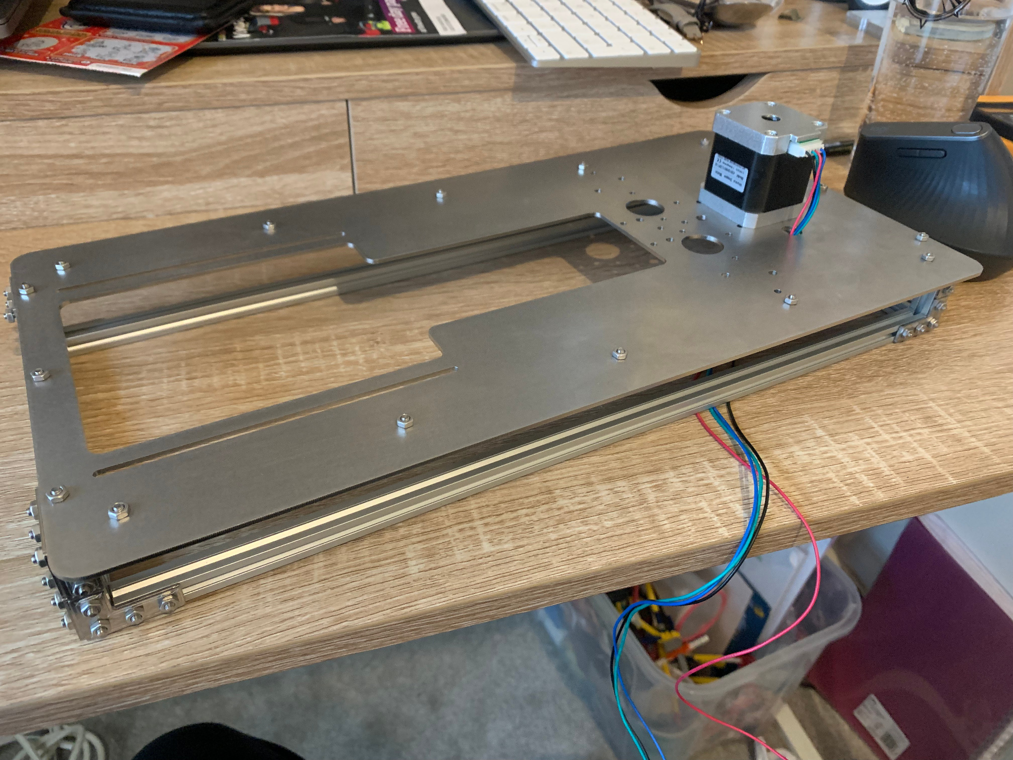

Some parts have arrived so starting on the assembly. The rest will take a week or two for the 3D prints and LED PCBs.
Remember this is just a proof of concept prototype at the moment and does not reflect how I intend the final product to look like.

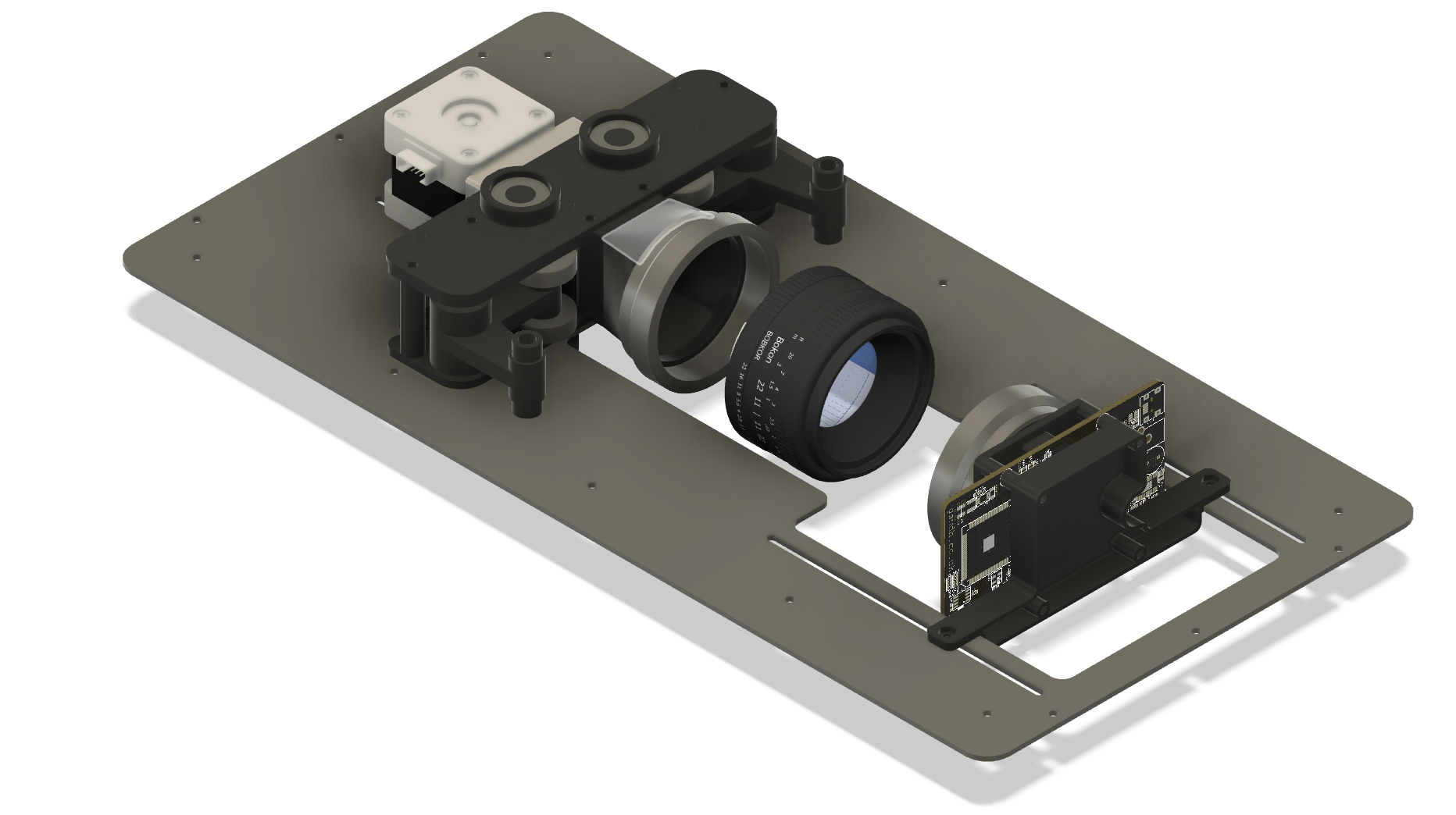

Hi all,
I mentioned in another thread I'm working on the development of a new film scanner. I started this project almost 8 years ago but put it on hold as I wasn't shooting much film at that time. Back then I developed the electronics and more recently the PC software. I've now ordered all the parts for the prototype mechanical design - let's see if it all works in the New Year!
My motivations for this scanner come from the frankly poor set of options on the market. All the scanners seem to have one or more of the following traits:
- Terrible software
- Are legacy hardware only working with legacy PCs
- Poor scan quality
- Poor user experience
- Extremely long and tedious scan times
I think this can all be fixed quite easily. I plan to make a sort of copy of the Pakon F 135 scanner, at least the style of it any way where it's capable of scanning a whole roll of film.
The electronics I have got working can scan a whole roll of film in just over a minute at 2000dpi, 14bit in black and white only. If I look to sell this, It would be upgraded to colour and at least 2700dpi.
