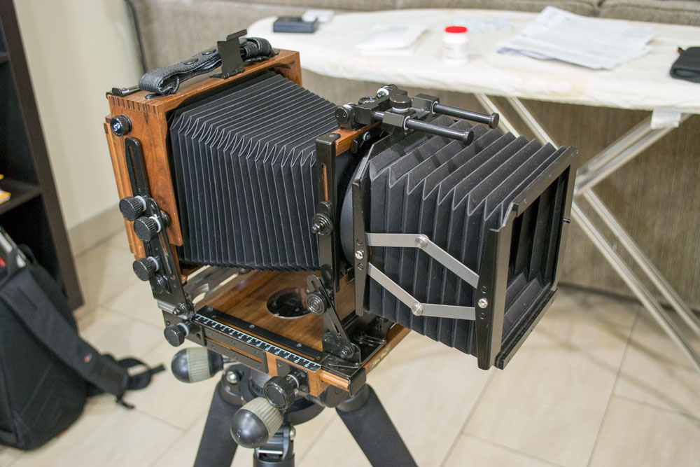

Wow, I just bought a 4x5.
This should be interesting.
