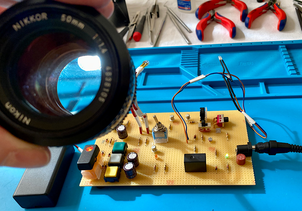

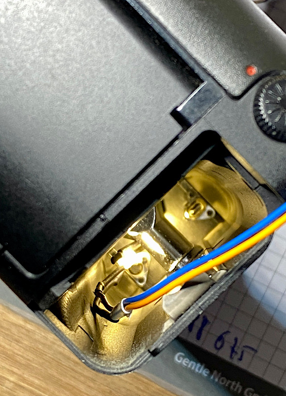

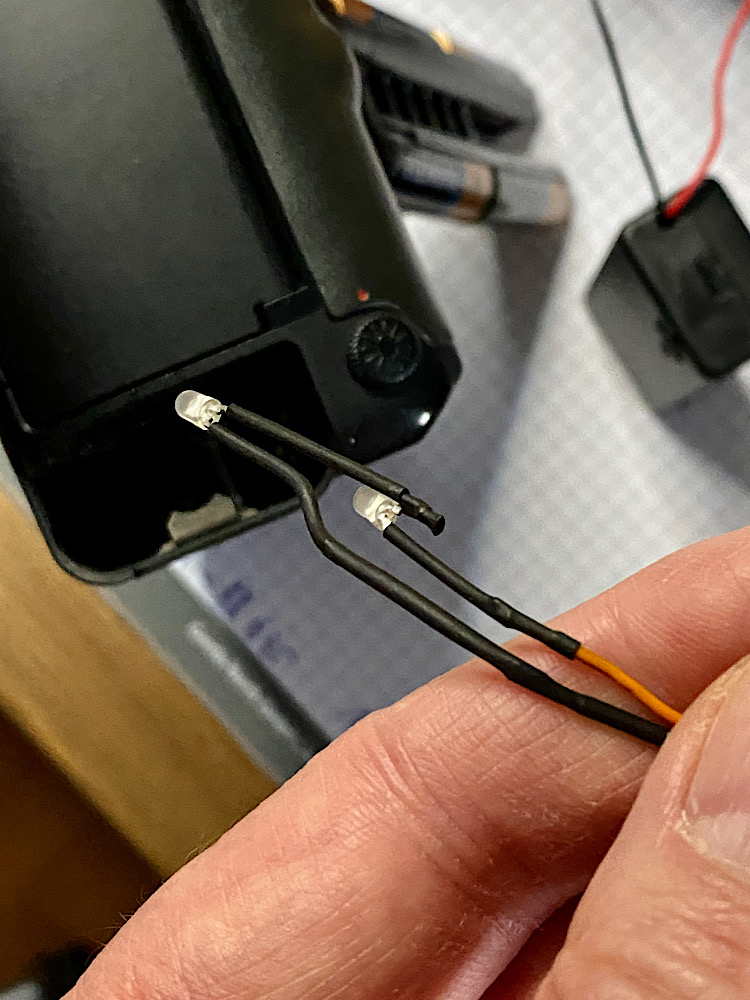

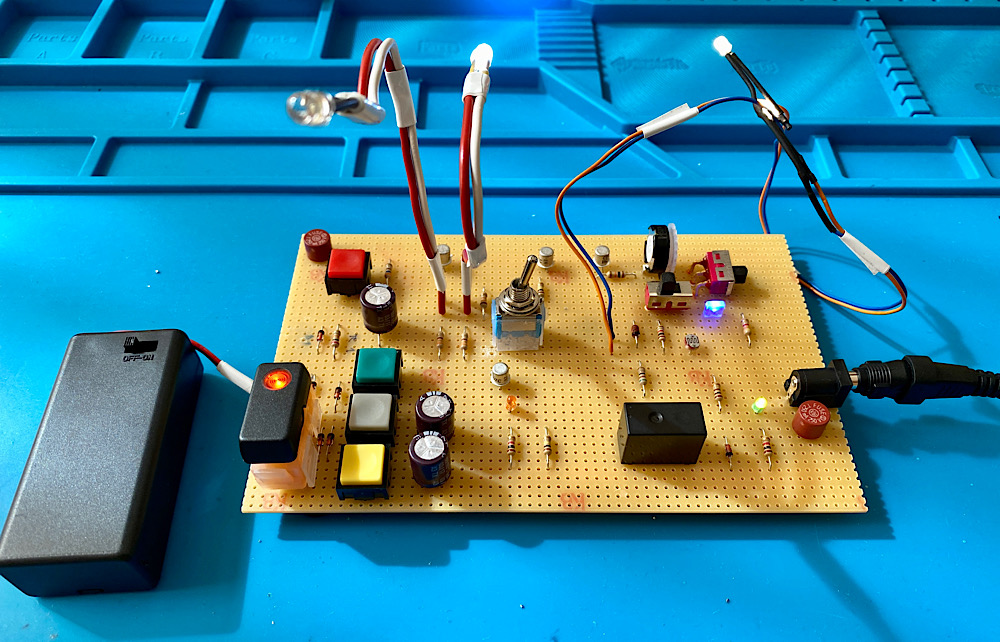

I was thinking about how I can put light where I need it during camera and lens checks. And free a hand that has better things to do than hold a flashlight.
So I was looking for a convenient and powerful solution, especially for checking and cleaning the battery compartments of my Canon T90s and motor drives.
Because at the bottom of these dark and narrow shafts are the battery terminals that supply camera resp. motor drive with voltage. These contact are often dirty or oxidized. Then the device may not power on and a check and clean is due.
This requires light and two free hands.
The idea for the Illuminator was born to support these activities.

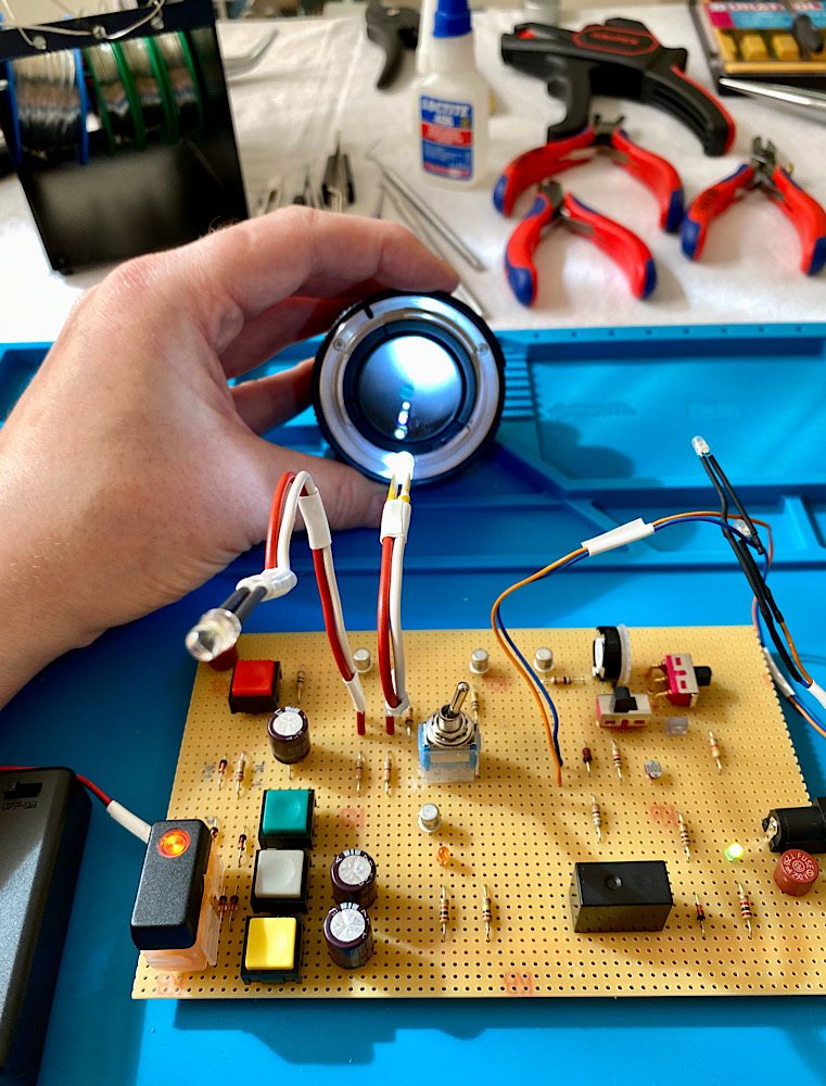

Characteristics of Illuminator 5.0

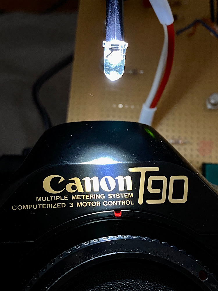

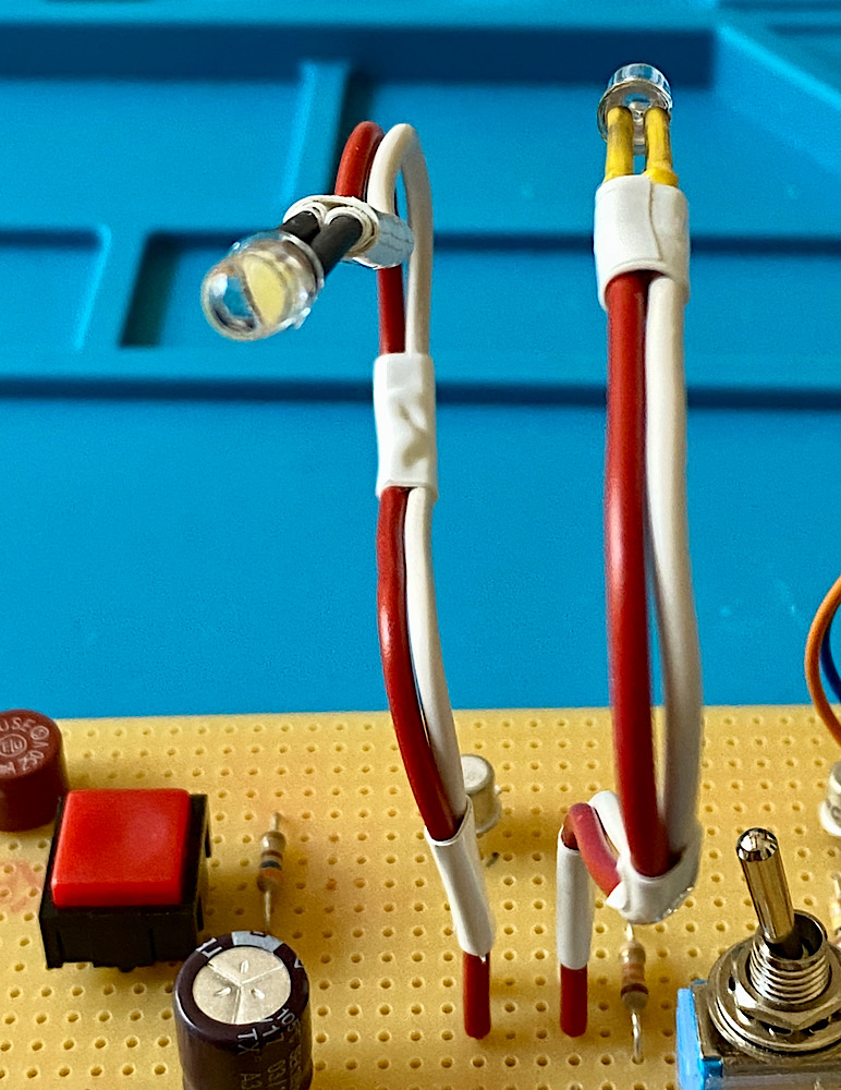

  • Two glare-free matt white LEDs for illuminating battery compartments.

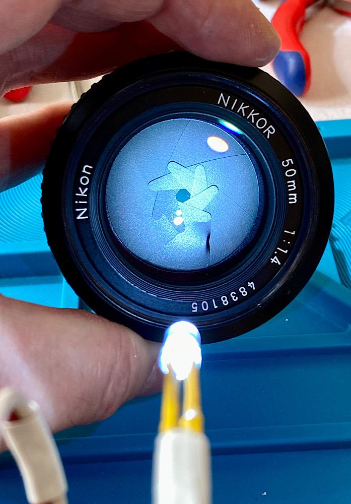

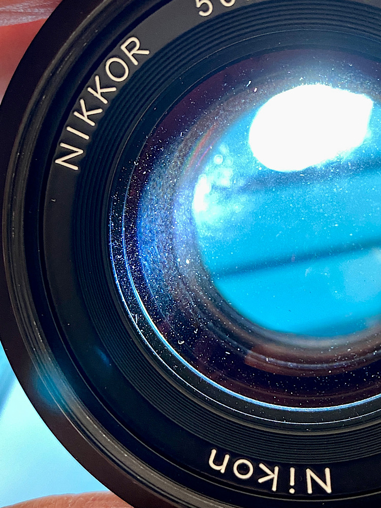

  • Two super bright white LED controlled by timer for candling through lenses/illuminating aperture blades. Start via push button, running time approx. 30 seconds bright, automatic dimming or manual switch-off via second push button (only by optional operation with switching power supply).
  • Light guidance via connection wires enables flexible positioning of the LEDs.
  • Power control of the battery bay LEDs automatically depending on the ambient light or manually.
  • Operation with 9 volt block battery or 9 volt switching power supply.
  • Automatic switching from battery to mains operation when plugging in the switching power supply plug.
  • Two control LEDs for displaying the currently active power supply.
  • One control LED for indicating power on battery bay LEDs circuit.
  • Stabilized input voltage enables uniform brightness with battery and mains operation.
  • Battery voltage tested down to 7 volts.

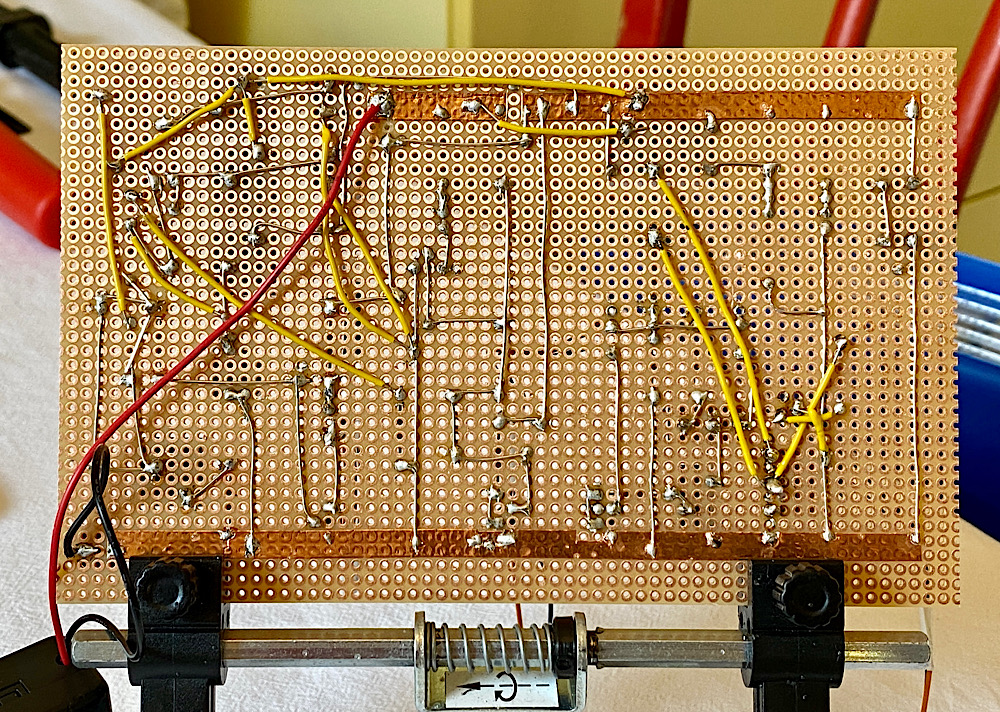

  • Analog circuit, assembly on circuit board without housing, basic version.
  • Idea, concept, development and implementation by author

Wouldn't it have been a little simpler, quicker and more compact to have one or two white LEDs each with their own series resistor soldered directly to a cut-off USB cable? That's 5 components including the USB thing and some bits of wire. Plug it into any desktop computer or a USB wall charger. Yes, the LEDs will be on all the time the thing is plugged in, but who cares about the few milliwatts of power consumed? Just clip it onto whatever you're inspecting with some mini clamps, clothespins, a bit of tape etc.

Sure do it and present your work in this thread you are welcome.
I assume that Amazon offers a wealth of solutions - smaller, smarter, simpler.
The challenge to me was to realize it pure analog following my ideas.
And to have fun when realizing it up from the scratch 😉

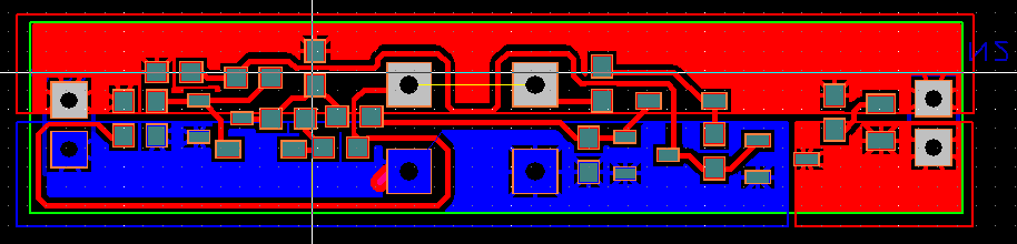

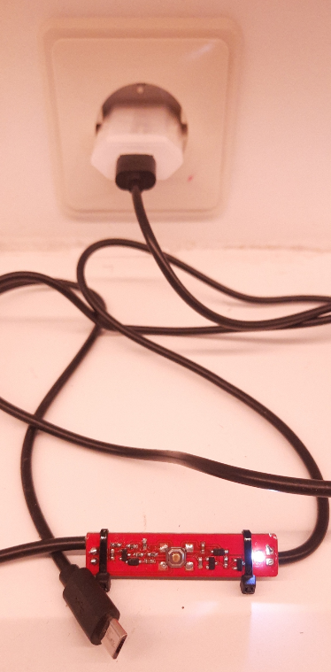

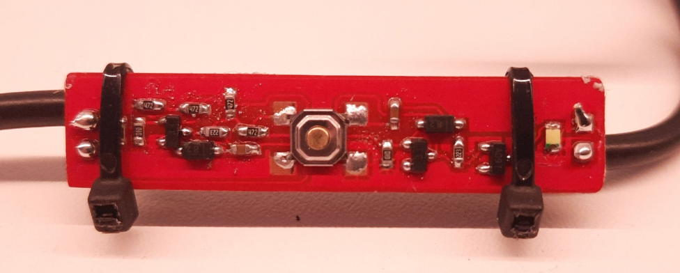

Alright, the little gizmo that triggered my response is for a slightly different application, but has some commonalities and could easily be adapted to the same application as yours. It's a small switch that plugs into a USB port (computer, phone charger) and that turns on or off a load connected to the other micro-USB end. This micro-USB plug could be replaced with an LED and series resistor. The device itself also has a white LED on it as a status indicator, but it can be used for illumination in its own right.
This is the schematic:
I laid out a simple single-layer PCB for it:
Here's the assembled device:
It measures ca. 1x5cm or roughly 0.5"x2".
The microswitch in the center acts as a toggle switch: press it to turn the load on, press again for off, etc.
Here's the thing plugged into a wall charger:
Of course, the same functionality could be achieved with a simple mechanical toggle or slide switch. This implementation has the advantage of being very compact and it's nice to use. I mostly use it in combination with a LED panel/sketch pad that I use as a simple light box when enlarging negatives. It's convenient to have something that easily turns the panel on or off; it doesn't have its own switch and this is much more convenient than pulling and reinserting the plug all the time.
As said, the micro-USB plug at the bottom the final photo could be replaced by an LED at the end of a piece of cable to create a similar functionality as your device.
While I used SMD parts for compactness here, the same could be done with through-hole parts and still retain a compact form factor. Since I always end up having a lot of junk lying all over the place when I'm working, I prefer compact gizmos so I can stack even more junk in my workspace - yay!
So in a sense, this is the same Goldberg kind of thing as yours: it gets the job done, but there are even simpler ways to achieve the same. What gives! Such little projects are fun from time to time.

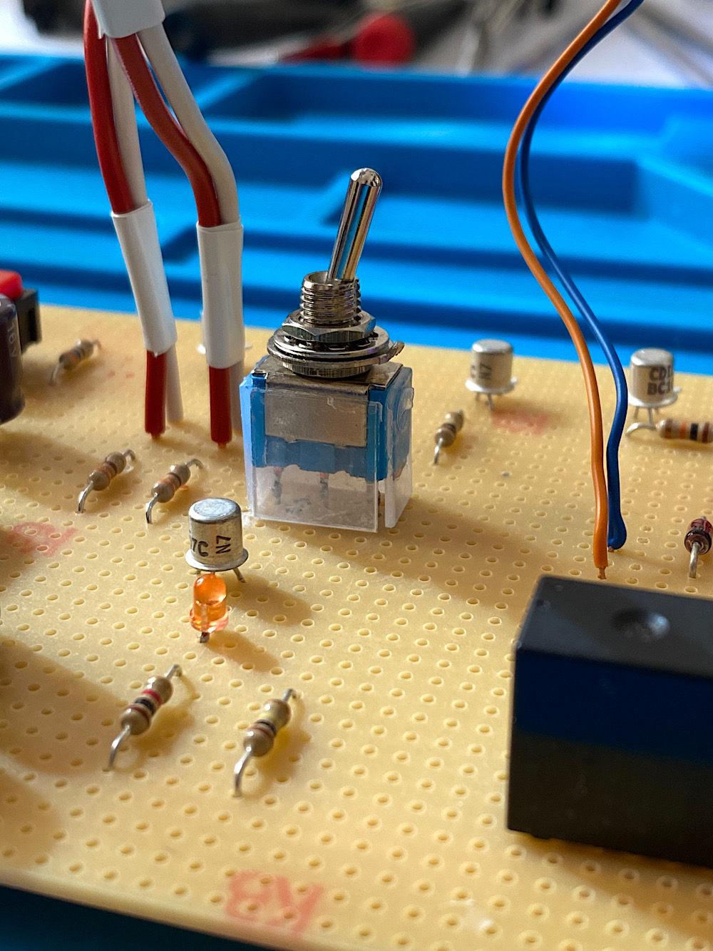

I see what appears to be a CdS cell on your perf board. Does that automatically dim the LEDs based on ambient light?

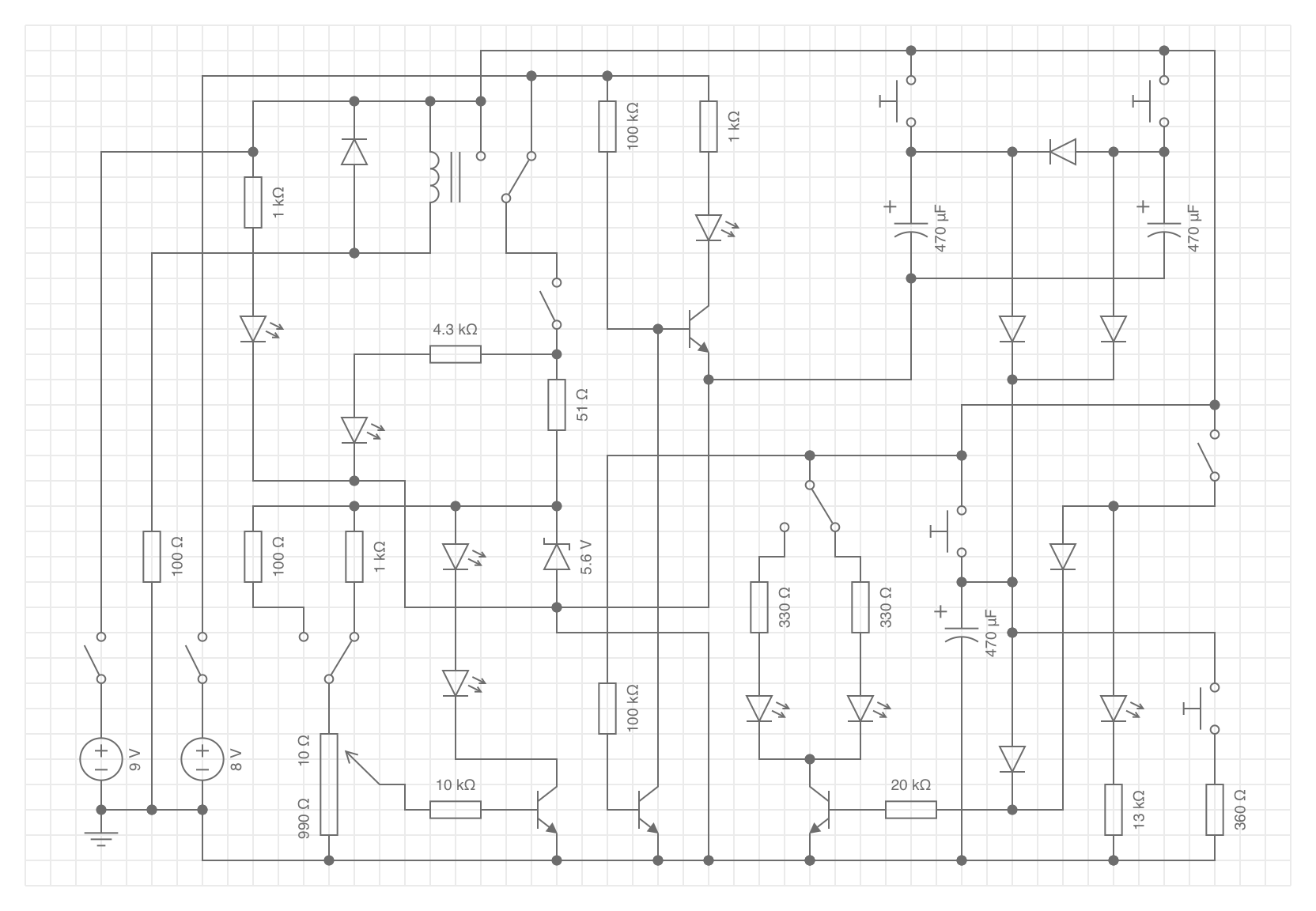

The circuit diagram to Illuminator 5.0:
This is not intended to be a professional, commercial, cost-saving, efficient circuit, but one that makes it possible to study the behavior of analog electronic components and at the same time to fulfill the task at hand.
It was my own final exercise after completing a course on analogue electronics to see what I understood and could apply.
So you will not see it on Amazon 😉

Thanks for posting the schematic Andreas, I was curious about that one.
I hope your health improves so that you can enjoy life to the fullest. When life gives you lemons, as they say - sounds like you found a pleasant diversion!

So do I. Your project is nice, really. I like how it's engineered; there are nice details to it, such as the protection of the switch and the electrolytic cap in the bottom right corner (the bit that manages the delay/fade out of the inspection light) so that neither the switch nor the cap suffer from a rapid discharge. The attention to such details is really pleasing.

I did the circuit diagram with EveryCircuit
which unfortunately does not allow to export the diagram to let have a PCB printed.
As I switched to MultiSim this might be an option.

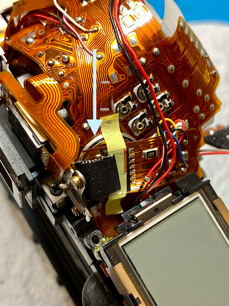

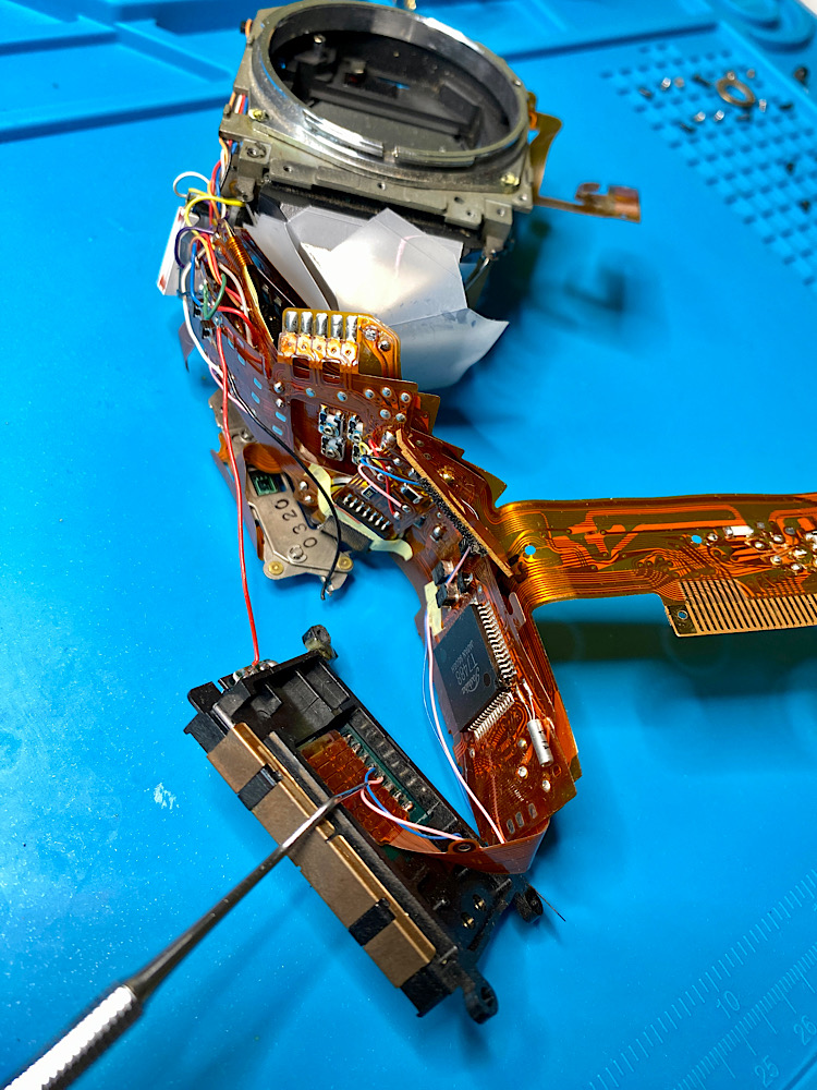

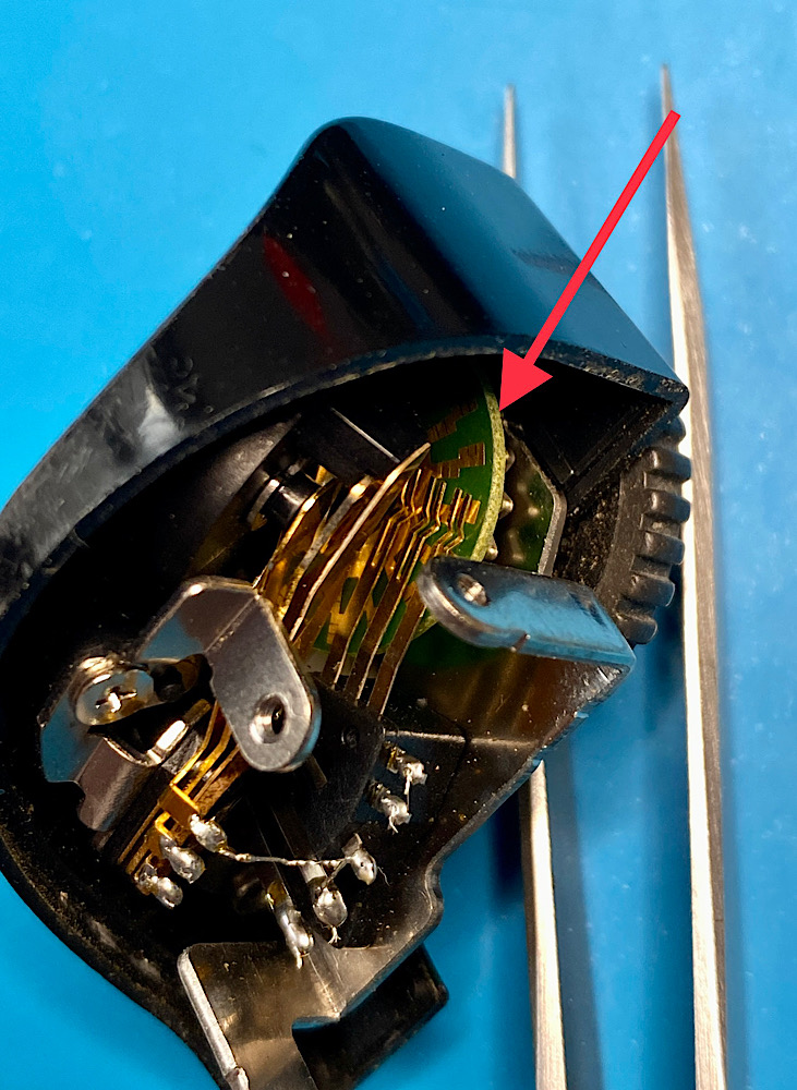

Anyway the beauty of ingenious solutions by Japanese engineers is wonderful:
Trigger unit of the Canon T90 with the famous rotary wheel that then became standard with EOS. The arrow points to the rotating contact plate with contact wipers. On the leftside the contacts for the trigger.
Position of the backup battery in the Canon T90 surrounded by parts of the flexible circuit.
Eldorado at it‘s best 😉
Highly integrated electronics built 1986.
