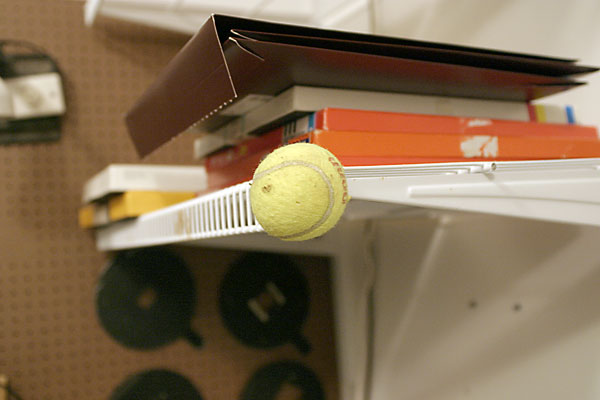

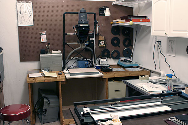

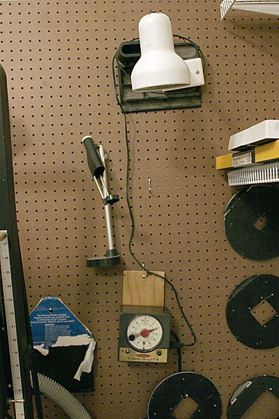

Just finished overhauling the darkroom. I got rid of the office desk my enlarger was on and built a counter 36' high with a gap with inset rails so my Beseler sits flush with the countertop. Under the enlarger is open to allow doing bigger prints by removing the baseboard and projecting through. I also raised the matting and mounting table to about 36" to make all the work surfaces equal. Then I put a few new shelves in for storing larger boxes of paper. I also mounted a small desk lamp modified with a dimmer and a 7 watt bulb controlled by a timer to do highlight bump exposures as needed.
I think the darkroom will be 100% more functional with these modifications. Heres a few shots to illustrate.
The tennis ball is to protect the scalp from the shelf.

Pegboard on the walls - oh man, Gary you are a genius!! You have just helped me solve my storage issues.
My darkroom is in a corner of the basement where the water main is and I had to build around it. It has about 8' 6" square usable space. The enlarger (an ancient Beseler 57MB with custom built in cold light) is attached to a table I built with a sliding base that I can lower.
I have a plastic utility sink that has a pump under it to pump the water up and out over to the main waste line. The trays are on another table I built with two shelves under it. And there is about a 3x5' are for me to walk around in. I have to be a little careful about any splashing that may occur from the sink.
So I think putting pegboard up is really gonna help.

The pegboard wasn't my idea, I saw it here recently in another darkroom posting but I couldn't find the thread to hook this to.

Thanks JMoore! Your inspiration has made a vast improvement in my darkroom. The biggest difference I made is using the brown perfboard behind the enlarger to kill stray light leaks from the enlarger. I stll need to figure out what else can be hung on the perfboard.
