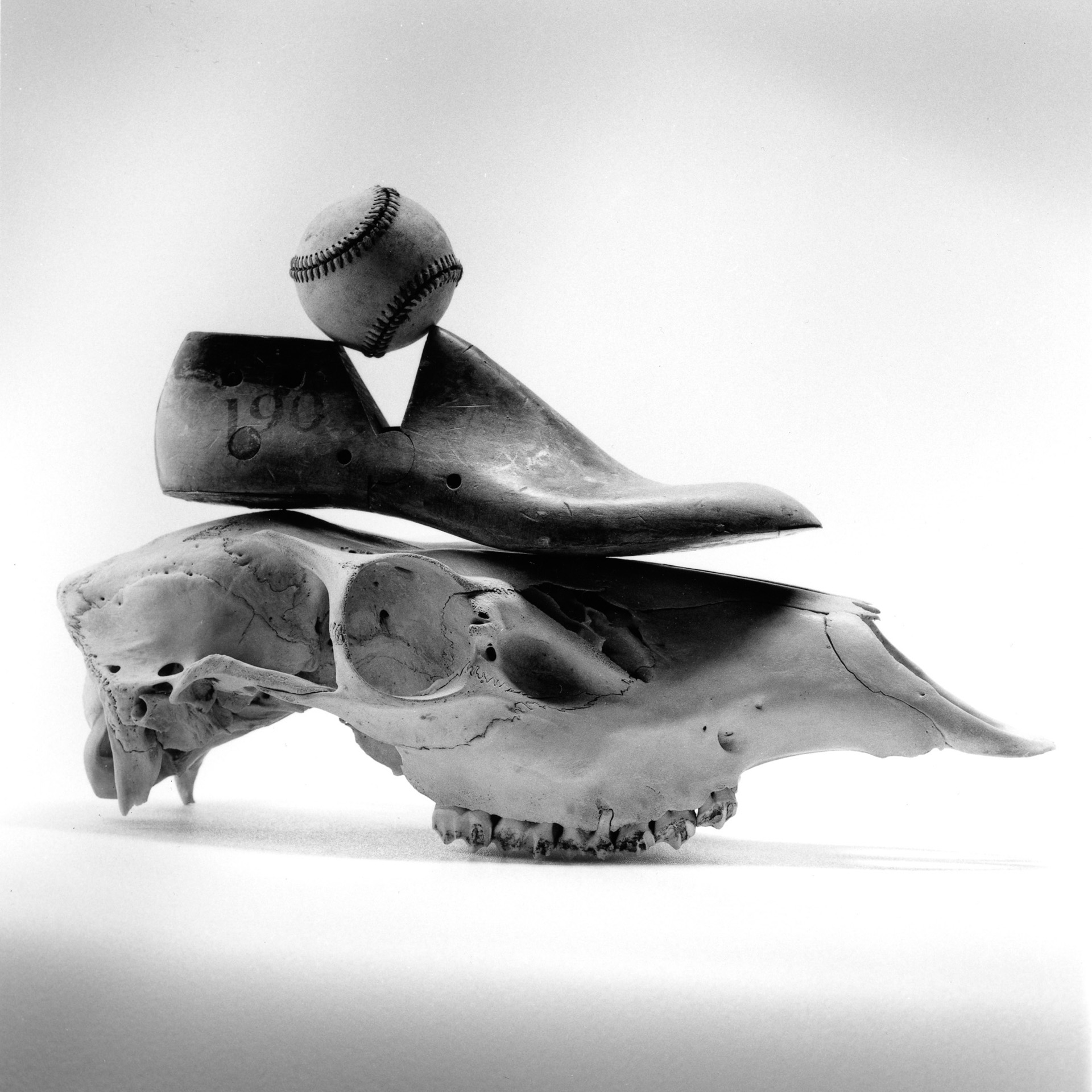

I use Rodinal for developing all my film, I use alot of Fomapan or TriX, i am venturing into using Ilford FP4 and am thinking of shooting it at 80asa and dev. For 9 minutes at 1:50. Would this be a good start? This is for printing in darkroom with 120 negs. Thanks.
There's a development time difference depending on the type of light of your enlarger... Do you use condenser or soft light head/enlager ?
I souped some FP4 in Rodinal last year in 1:50 for 11 minutes. Turned out pretty good. I exposed at box speed.
edit to reflect actual processing time
FP4+ is gorgeous in Rodinal at EI64.
If you use 1:50, that's good both for overcast and sunny scenes.
20C with 2 inversions in the beginning, and 2 inversions every minute.
8-10 minutes depending on your enlarger.
I shoot FP4+ at 80 and process in Rodinal 1+24 for 7.5 minutes, per the Massive development chart. Works great.
