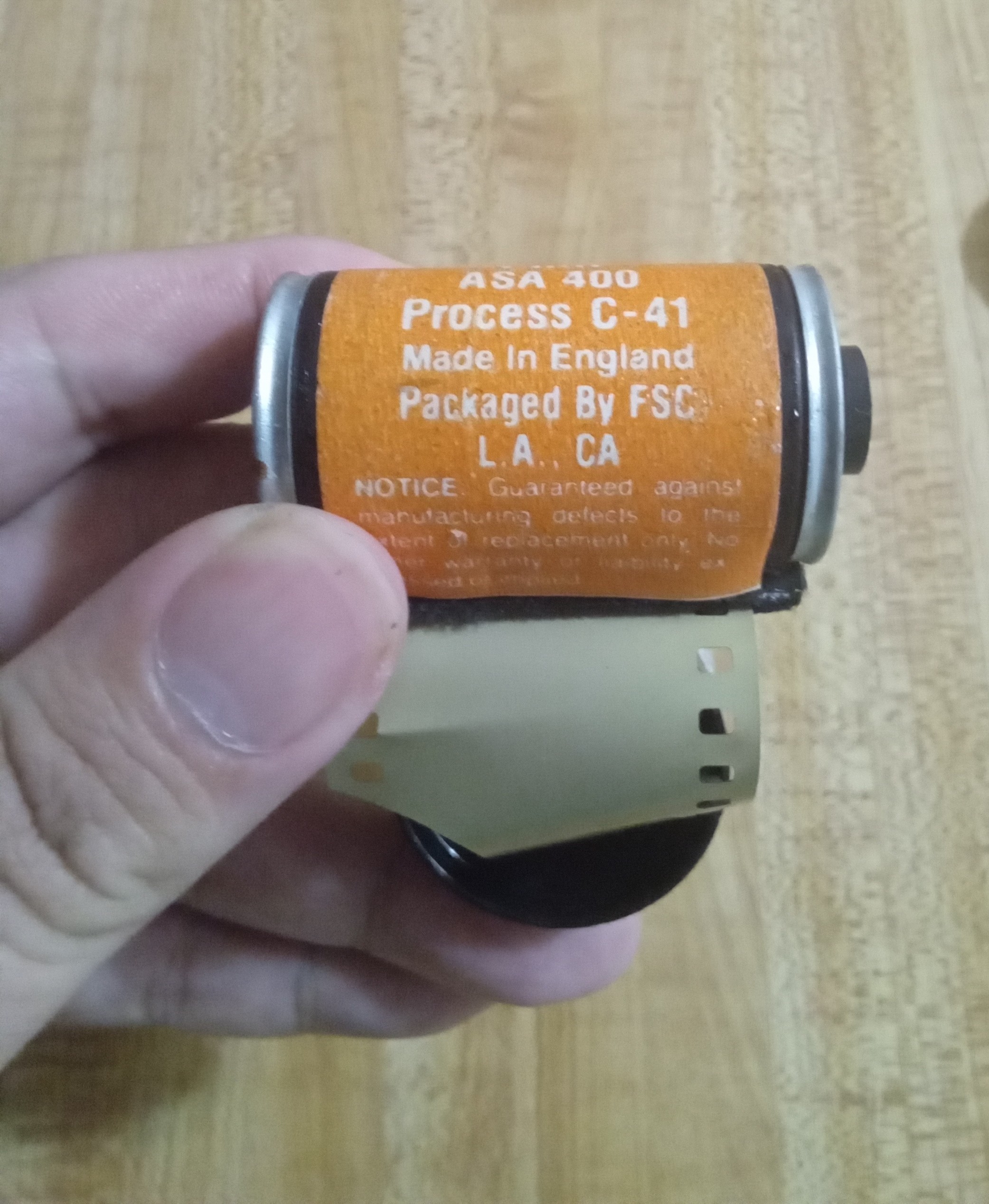

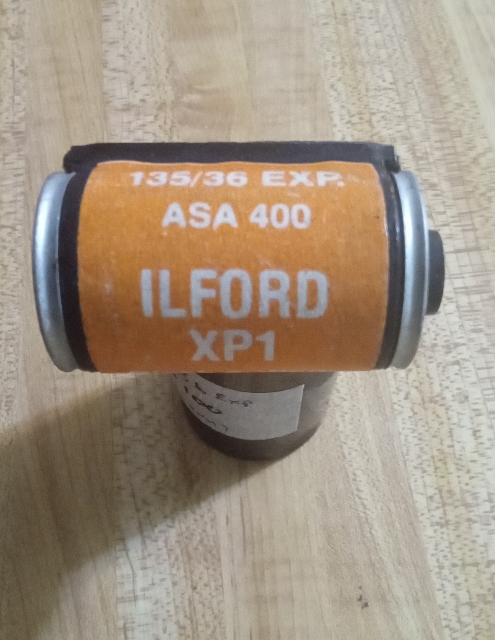

I got a roll of expired Ilford XP1 400 off evilbay a while ago (been in my freezer since I got it), and looking for more info on it.
The main question I haveis has anybody seen a roll of XP1 with an orange label like in the photos? Everywhere Ive looked online, all the 35mm rolls (even from the 80's) have a white label with black & red lettering (similiar to the XP2 Super).
That was repackaged by Freestyle back in the 1980's. Freestyle sold repackaged bulk film from Ilford back then.
(It says "repackaged by FSC" on the label).
I personally shot a lot of their repackaged Pan F 35mm movie film back then...no edge lettering, and cinema perfs.
Ahhh ok, I thought thats what FSC meant, especially it having LA, CA on it but I wasnt 100% sure about it. Thanks šŸ‘

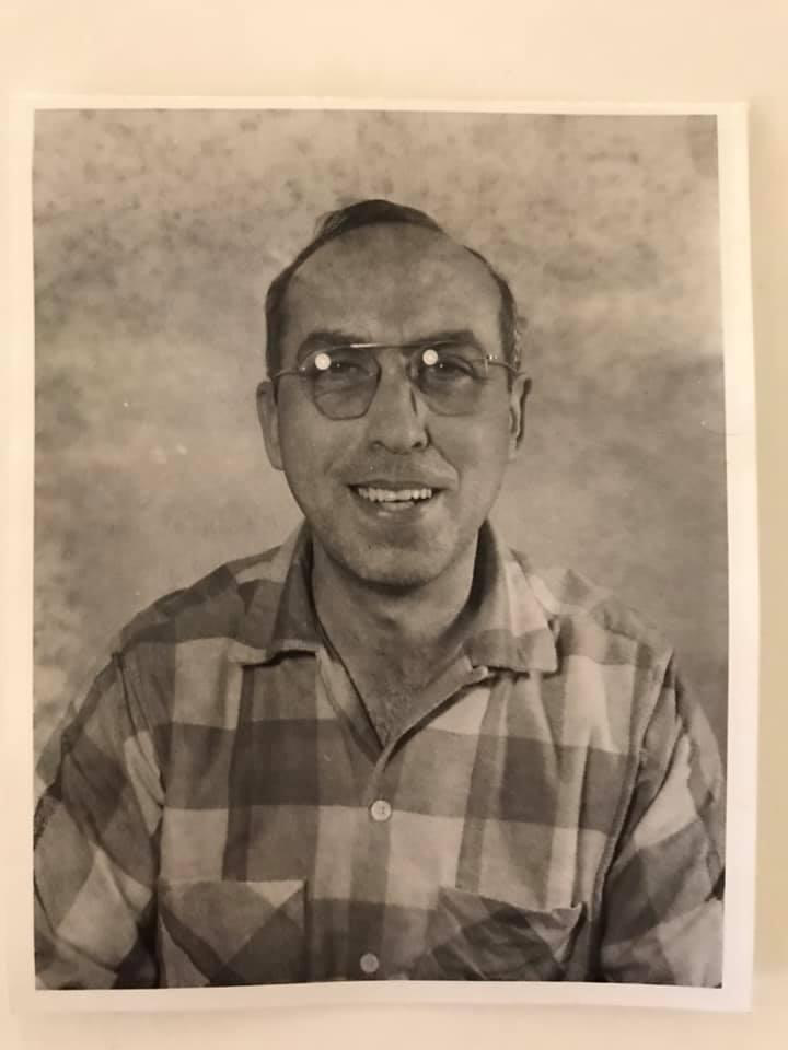

I did. It was a film pack that was half-used. A couple of the pictures were underexposed. There were some home portraits. Below is a phone photo of a print - the main emulsion damage came from the paper in the film pack.

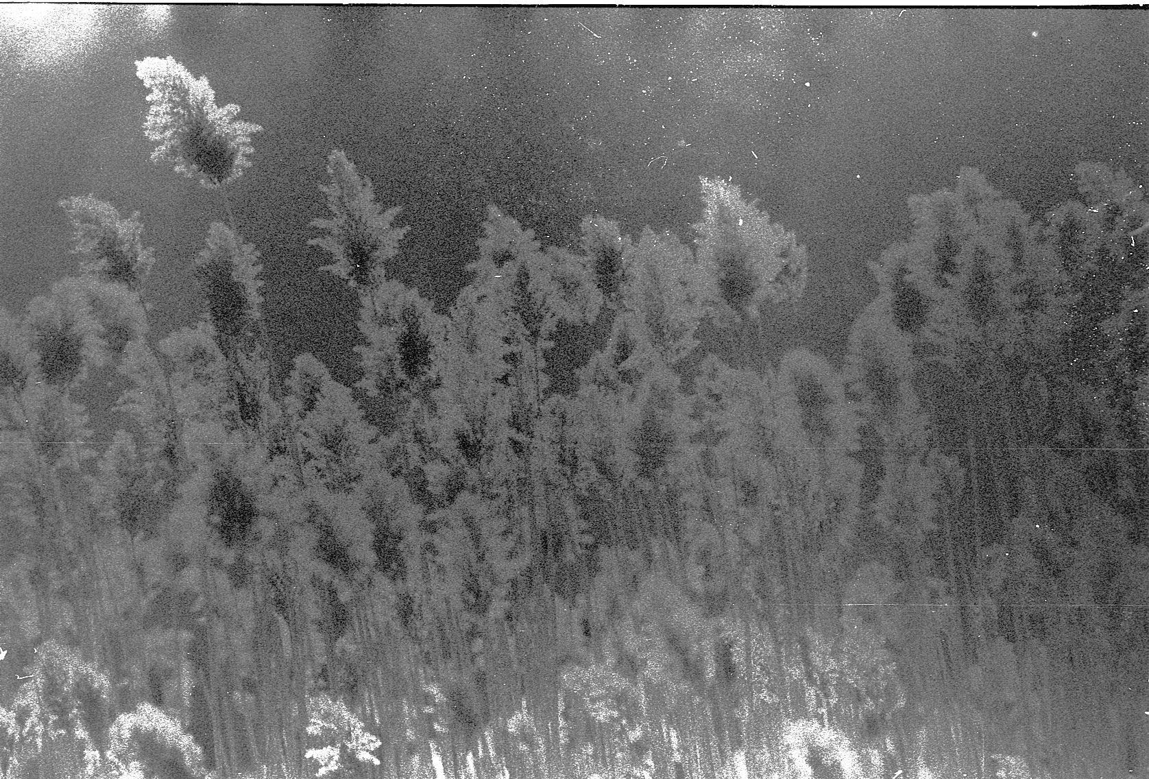

I've been doing some testing with very old, poorly stored XP1 400. Sent some out for C41 processing, blank result. Decided to do some kitchen sink processing to reproduce how I used to dunk the stuff at home with standard B&W chemistry. So, D76 for 15 minutes, also blank. Today, Rodinal 1:100, 60 minute stand. Something is appearing as shown. Very thin neg, and can make out the frame rectangles. Next try, probably Rodinal 1:50 for 2 hours.
I've been doing some testing with very old, poorly stored XP1 400. Sent some out for C41 processing, blank result. Decided to do some kitchen sink processing to reproduce how I used to dunk the stuff at home with standard B&W chemistry. So, D76 for 15 minutes, also blank. Today, Rodinal 1:100, 60 minute stand. Something is appearing as shown. Very thin neg, and can make out the frame rectangles. Next try, probably Rodinal 1:50 for 2 hours.View attachment 372527
Rodinal 1:50 4+ hours stand processing. NG. Fogged. May back off to Rodinal 1:100 again, 2 hour stand. Or try HC110 dilution E, 24 minutes.
