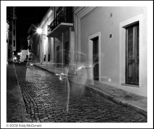

I've often wondered if there has ever been talk of XP-2 in 4x5 sheets?
GraemeMitchell said:
XP-2 is a remarkable film. And it has a wonderful tonality and it's so easy to shoot.
Not only was it talked about, it was manufactured. I used it to make the attached photo.
--Eddy
