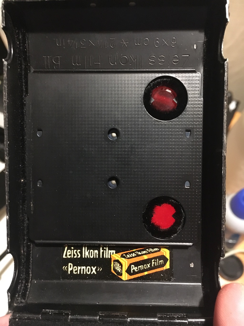

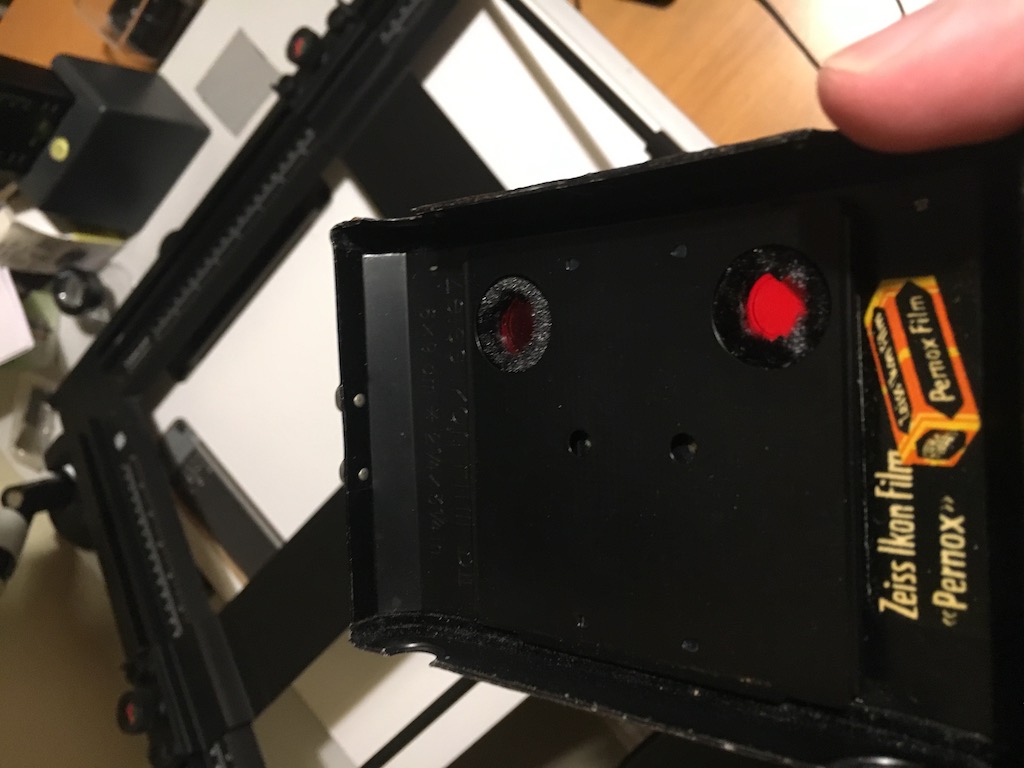

Red windows can be a bit more complicated than just a red window. My Zeiss Ikon cameras also have some felt around the edges of the red window where the hole meets the pressure plate. The idea is to prevent the light from leaking beyond the hole. If the backing paper is doing its job than the film should be fine but if the red window "leaks" light beyond the small area that enables you to read the backing numbers then it could fog film. It would surely reduce the chances of fogging to cover the window except when winding on the film.

Just out of interest, here are some pictures of the red windows on one of my Zeiss Ikon cameras. You can see the black felt that contacts the backing paper preventing spread of the light.
