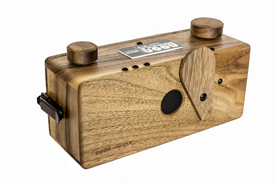

The only camera I have right now that requires the red window advance is my pinhole. Which makes total sense since it's a wood box with a manual film advance.
So the fact that it is made of wood must enhance the Wood Effect, right? :wink:

The only new camera (manufactured in 2016-7) that I own requires that I use the numbers on the backing paper and the red window(s) in order to advance the film properly.
Isn't it pretty?
It gives good results too.
I View attachment 189354
I have an older roll of SFX that I should probably try it with.
Lovely camera and print. This is what it's all about!

The camera actually has three red windows - one for each of the format choices. If anything is likely to reveal the answer to Scott's suitability questions, it would be it.
