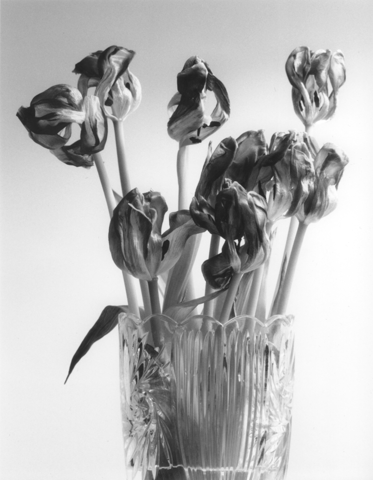

My entry in the Ilford APUG contest a few years ago was shot on unfiltered SFX 200.
The slightly different spectral response is interesting to work with.
