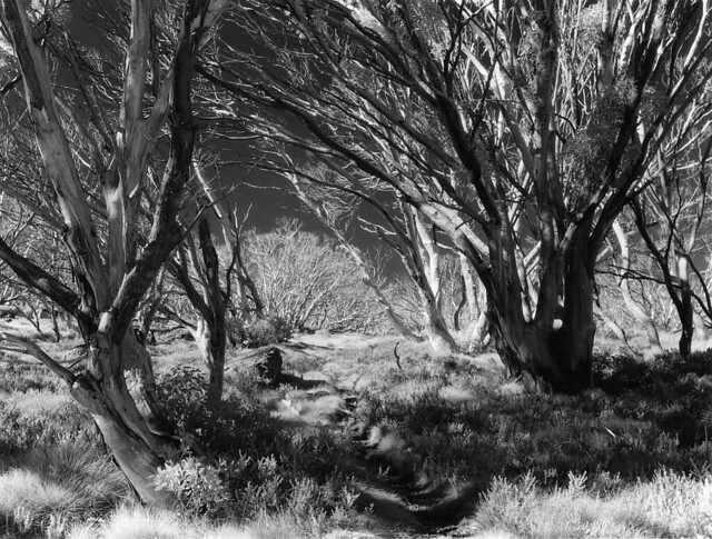

Worn Path, Mount Wheatley.
Ilford SFX 200 exposed at EI = 6 in a Mamiya RB67 camera fitted with a 50mm f4.5 lens and IR680 filter.
I've exposed a lot of SFX 200 through infrared filters like IR680 and IR720. In each case I used an EI = 6 on a Sekonic L-758D meter and aimed it at an approximate mid-tone. Observations:
The correlation between visible light metering and actual infrared exposure is vague but it's better (only just) than nothing.
Metering the shadows didn't work for me. The shadows, if illuminated by blue sky, have virtually no infrared in them. Conversely if the shadows are illuminated by scattered light from green leaves then there's loads of infrared available.
Trying to compensate for reciprocity failure didn't work for me. Because effective IR exposure is unpredictable I simply expose using numbers off the lightmeter. If reciprocity failure happens then the shadows just go dark. Which kinda looks "natural" in the unnatural world of infrared images.
