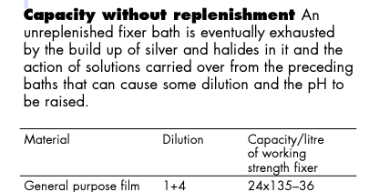

Here is what the datasheet says:
That suggests that the answer is 12 rolls.
The T-grain/Delta films are more demanding, so 12 may be high.
