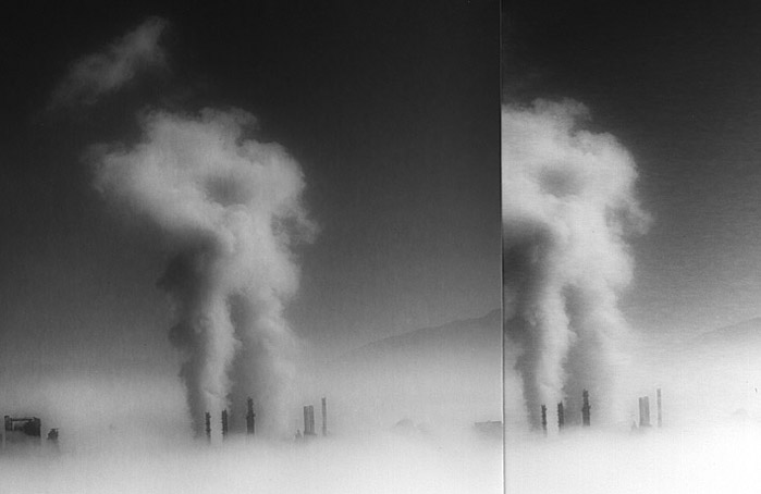

As I stated the problem will not be apparent in most circumstances. It requires high contrast, no or low texture, large smooth areas. But please try this, expose a sheet of FB multigrade paper using a grade 5 filter, no negative, just fog it to zone 4 or 5 and then process it. If that print comes out clean then please tell me exactly what you are doing/using and give me the emulsion number of the paper so I can get some.
Here is a sample of a print that I can't print because of the mottle problem, it's 2 prints of the same neg, please note that the direction of the mottle appears horizontal in one and vertical in the other. This was caused by turning the paper 90 degrees to see if the mottle was enlarger or negative based or paper based.
I will do this for you, I am in the darkroom this coming week. Ilford MG4 , Grade 5, No negative, lens totally out of focus, slight tone on print, Dectol 1:2 , 2min dev.

Thanks Bob, I will not be around to check the thread but please post it. Also you might want to contact Rod Parsons if the results are of interest. I just spoke with him and he thinks the R&D guys have made serious progress so maybe all this will be behind us soon. BTW not slight tone, more like zone 4 or 5, medium gray to dark medium gray. The problem does not appear readily in lighter areas.
Hi there
I just finished the test , I used full sheets of 11x14 paper for the test.
I made prints that went from light grey, to dark grey.
I did notice a pattern in the lighter grey prints but not in dark grey. I would say that there definately is some pattern in the mid tone prints , I used grade 5 , with 135mm lens racked out of focus and I moved the prints during exposure to minimize any defaults in my set up ie the mixing box possibly providing a pattern.
Now would I see this pattern in a print with a negative in place ? I am not sure. I will try to print a negative with lots of nuetral grey to see if I can see any pattern.
This pattern is very subtle but admittedley it is there.
I will post again after printing the same emulsion with an negative in place with a nuetral bias .
