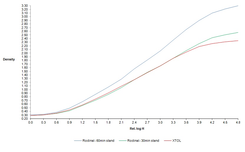

Here are some FP4+ sensitometry results for Rodinal 1:100 stand development at two development times relative to XTOL. Note results will vary in practice as in this experiment care was taken to minimize any difference between developer temperature and ambient temperature.

So Rodinal stand gives the best shadow speed, as expected.

…with a few caveats. Note the 60 minute development time produced high contrast. The 30 minute time produced a normal gradient (essentially the same as the XTOL control) with basically full emulsion speed. It would be interesting to find out if a normal process (much shorter development time with agitation) yields a materially different result.
One thing to watch out for though - uniformity in these tests was bad. Each density on the curve is the average of a series of measurements on each patch and the spreads were significant. Come to think of it I should have put in error bars. Even the fog levels showed some non-uniformity. Some amount of intermittent agitation would likely improve things somewhat but it would require experimentation. When it comes to these extreme processes there are variables, some quite difficult to control.
