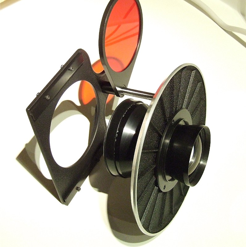

Hello all:
Is there a lens focal length limitation for this type of Ilford under the lens Multigrade filters?
ie is this kit limited to 35mm film and 50mm lens? Or is it designed for use with 35mm, 6x6, 4x5 film and associated lens'?
I see some on-line that people are mounting 6"x6" MultiGrade filters under the lens and I am wondering is their a format which the kit shown is no longer suitable?
Thanks
Todd
The optical grade filters like you show can be used below any focal length lens.
6x6" filters are usually not optical grade and are designed to go between the light and the negative.
In the old days when I used the Kodak version, the only problem I had was that finding a holder that would fit my Wollensake 162MM.
The filters can be used on any lens as long as the edges of the filter don't interfere with the projected image. In practice, with a filter mounted close to the lens, as long as the filter is a little larger than the lens' front element, it'll be fine.
As mentioned, the small filters are designed to go UNDER the lens -- and as long as it is fitted correctly, any filter will work with any film format.
The BIG filters (usually gelatin sheets) are designed to go ABOVE the negative -- and as long as it is CUT to fit correctly, any filter will work with any film format.

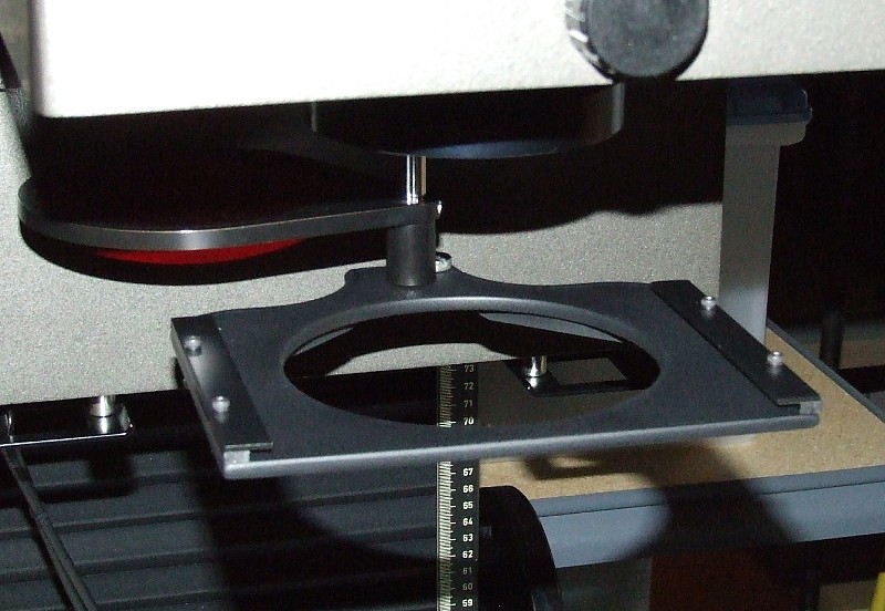

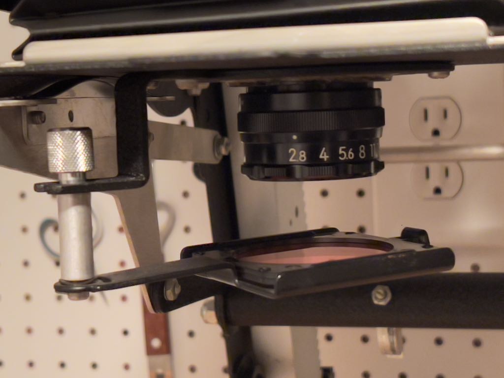

I use the under-the-lens filters for both 135 and 120 film (and, of course, their corresponding lenses and boards). Your boards do need a fork (or whatever the engineering term is) to be able to mount the holder, like so:
there are any number of ways to add a filter holder to an enlarger. I ditched the one on my Beseler MXT when I got my Zone VI VC head....

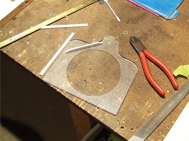

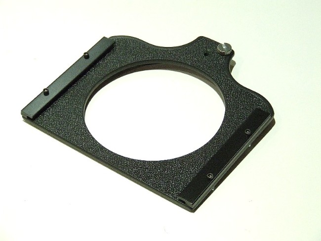

Here is an example of a filter holder I made for a 300mm lens. It takes the 6x6" Ilford filters.
Here is an example of a filter holder I made for a 300mm lens. It takes the 6x6" Ilford filters. View attachment 326184
Oh no! Those are the wrong filters! Only for above the negative use. They are not made of the same filter material as the under the lens sets, 😃
Okay, my attempt at humor here. I do the same thing with my 300mm Schneider enlarger lens. It works perfectly. I have the standard under the lens kit as well as the 6”x6”. They look the same. When you think about it, does it make sense for Ilford to engineer and manufacture two different filter materials? I think not. I also got a set of unmounted 3x3 filters- no different from the mounted ones.
Nice holder BTW, I need to come up with something like that. What materials did you use?

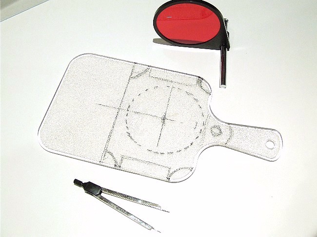

I had a thread on the construction of that holder, but the images are gone. I did find them on my hard drive from 2008. The holder is made from a kitchen cutting board:
