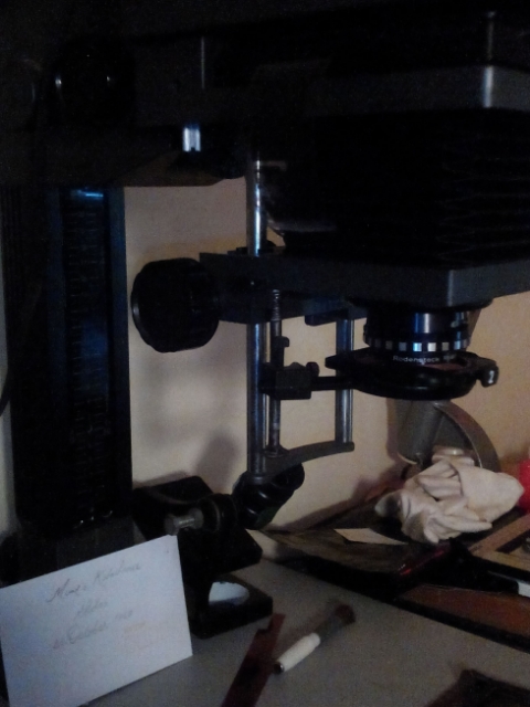

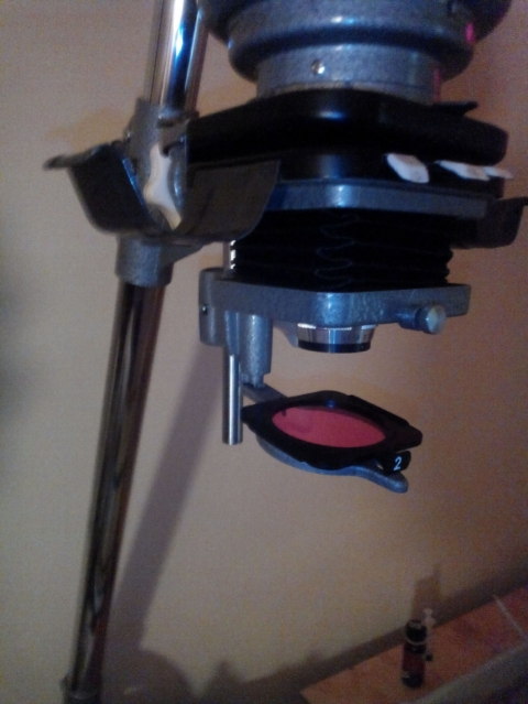

I've used the filters beneath my colour head enlarger a couple of times also for split grade printing and using a diffusion filter (little old ladies like me for this!) Presumably the hole in the lens board was originally intended to accomodate an under lens red safety filter, but no such thing arrived with the enlarger. So, I screwed a long bolt in place and attached the Ilford Multigrade Filter holder to that. It's pefectly fine beneath a 50mm lens but too cramped beneath my 80mm. A longer bolt would
remedy that.
(Apologies for the awful illustrative images!)
