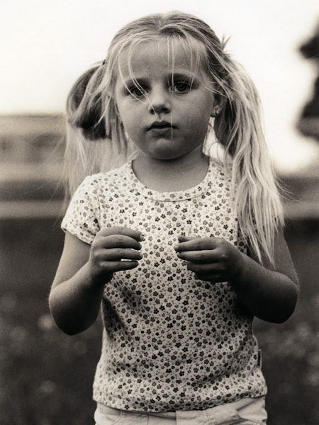

I attached an image that I bleached in full strength bleach for 45s. I tried one at 30s and one at 60s, and it was either not warm enough in the highlights, or (at 60s) it turned too much like Wisconsin cheddar in the highlights, borderline orange.
I never use the bleach full strength out of the package. That is testament to the latitude available with this paper. It allows each their own. I use both thiocarbomide and Kodak's Sepia II, but as Thomas points out that has now been discontinued. A home brew is easy enough.

... it was either not warm enough in the highlights, or (at 60s) it turned too much like Wisconsin cheddar in the highlights, borderline orange.
This may be due to the strong bleaching out of any information you had in the highlights to begin with. The file you use as an example looks a little hot to me as if the highlights have bleached out. It could just be my monitor though.
As for the bleach time Thomas, it varies depending upon the feel and color I am looking for. However as I said before, what I have noticed is that the first bleach bath doesn't do as much as subsequent ones. I also use the bleach in a warmed state by floating the bleach tray in a larger one with warm water. To use your words...

My posted picture is difficult to scan. There is a little bit of a golden hue present in all of the highlights. Some of the highlights are blocked up on purpose, as I wanted a print with a slight halo effect especially around Karly's beautiful hair. I see your point on completely bleaching away the highlights. It happens sometimes, for sure, and next time I get to print I will dilute the bleach and bleach longer. See what happens.
Experiment, experiment, experiment... :smile:
