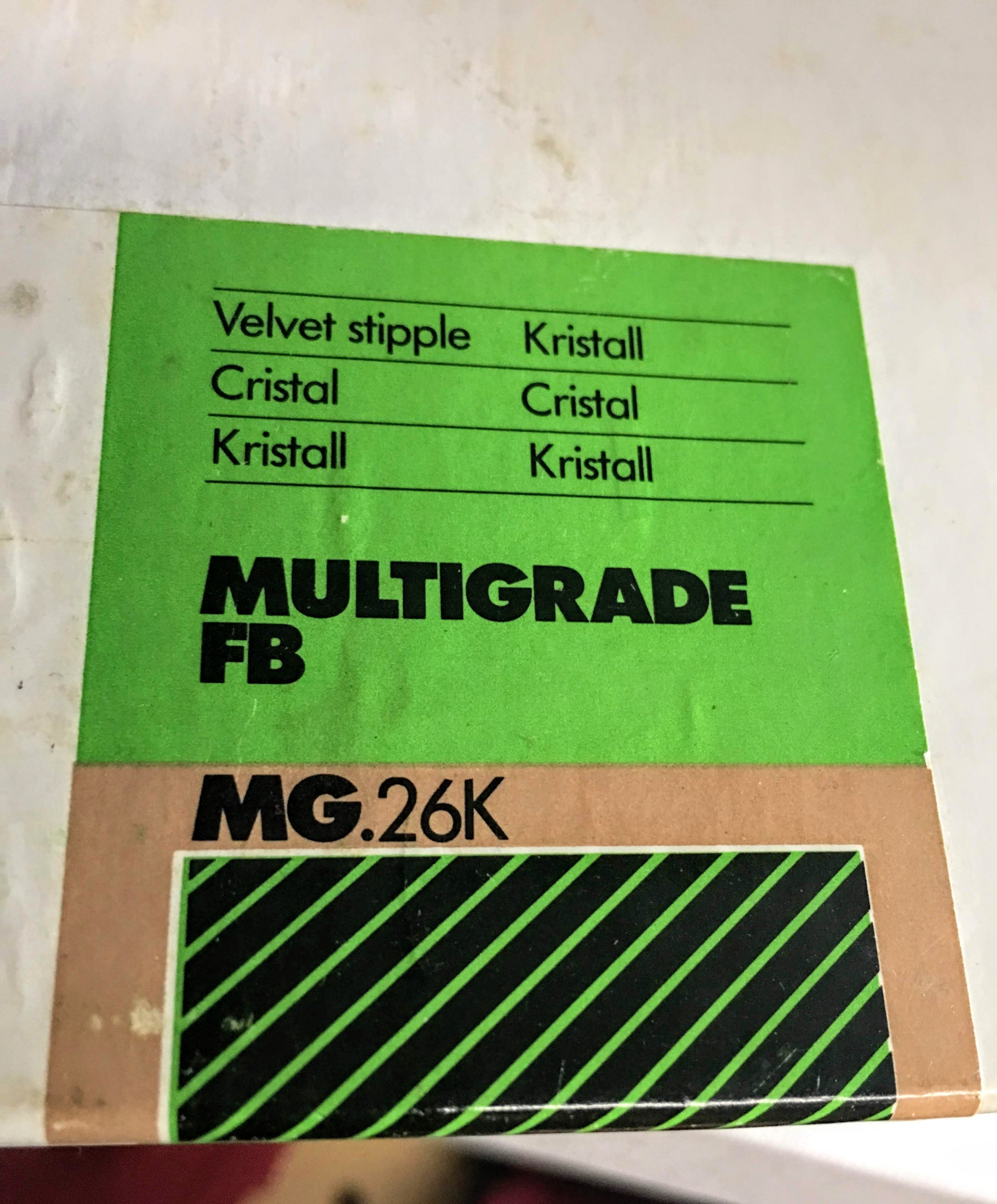

Was lucky enough to snag an unopened box of MGFB 2.6K recently. Have not seen this surface in forever. Has anyone else seen this surface available?
If memory serves me, Velvet Stipple was comparable to Pearl in RC.
I always compared Velvet Stipple to a Kodak E surface, a bit more gloss and a bit more texture than the Ilford Pearl.
From what I've seen of it, Mike's comments are pretty accurate - it's quite a dense texture, relatively irregular in shape. Pearl is much more regular & much lower relief. Must admit that 26K is not a surface I care for. I think it probably died somewhere between the first of the modern Multigrade papers in the 80's (as per that box in your post & a contemporaneous paper sampler I've seen) & Multigrade IV in the early-mid 1990's. From the samples I've seen, it seems to have been available as a substrate for both Ilfobrom & Multigrade FB.
