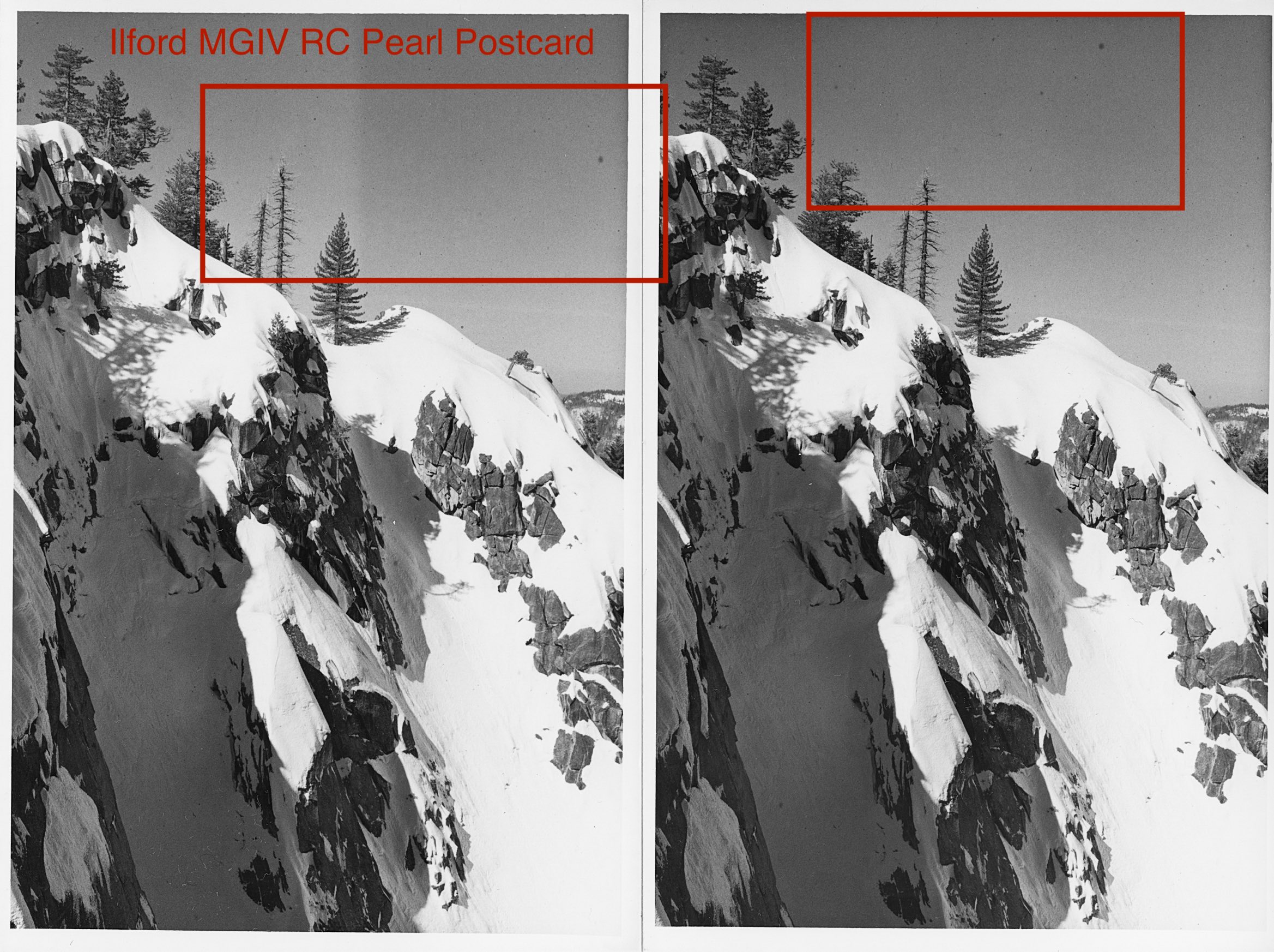

I recently bought a box of Ilford’s MGIV RC postcard paper from B&H Photo. I’ve not used this paper before but I’ve used other Ilford MGIV RC paper in the past without any problems.

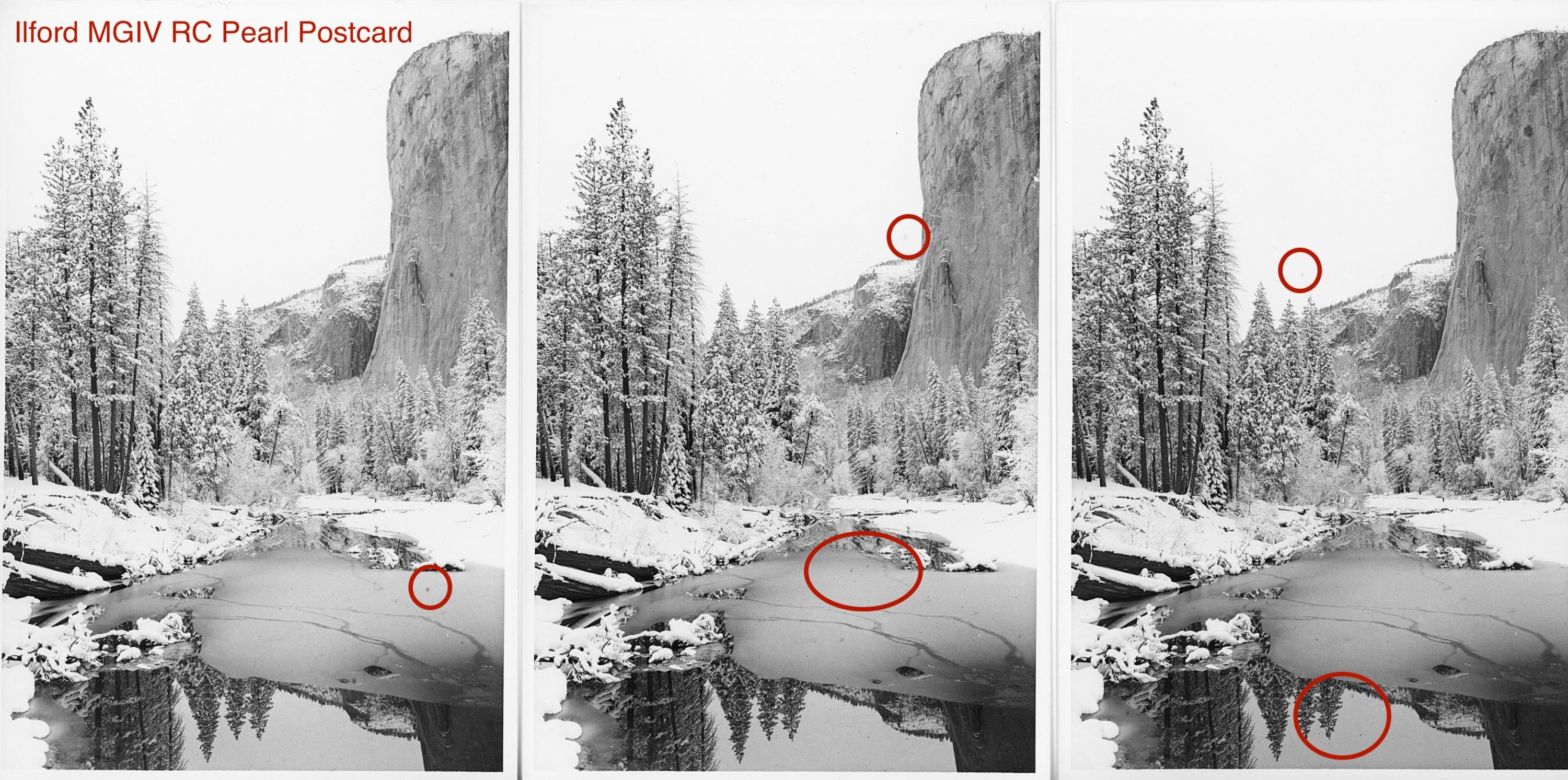

With this specific paper, I’m running into a lot of issues with small black/dark gray spots everywhere. These are tiny spots of various size, some sharp, some softer, always in different locations with each print (I did not change the negative/lens/filter between each print). They are more visible in darker areas of the print.
It’s not the negative, lens, filters, or chemicals, it must be the paper because, during the same print session, using the same exposure, same negative, and same chemicals, I’ll have black spots on the postcard paper but, If I use an 8x10 sheet (print area is still postcard size) of MGIV RC paper the print will be clean, no spots.
Samples of the postcard paper (not every spot is highlighted):

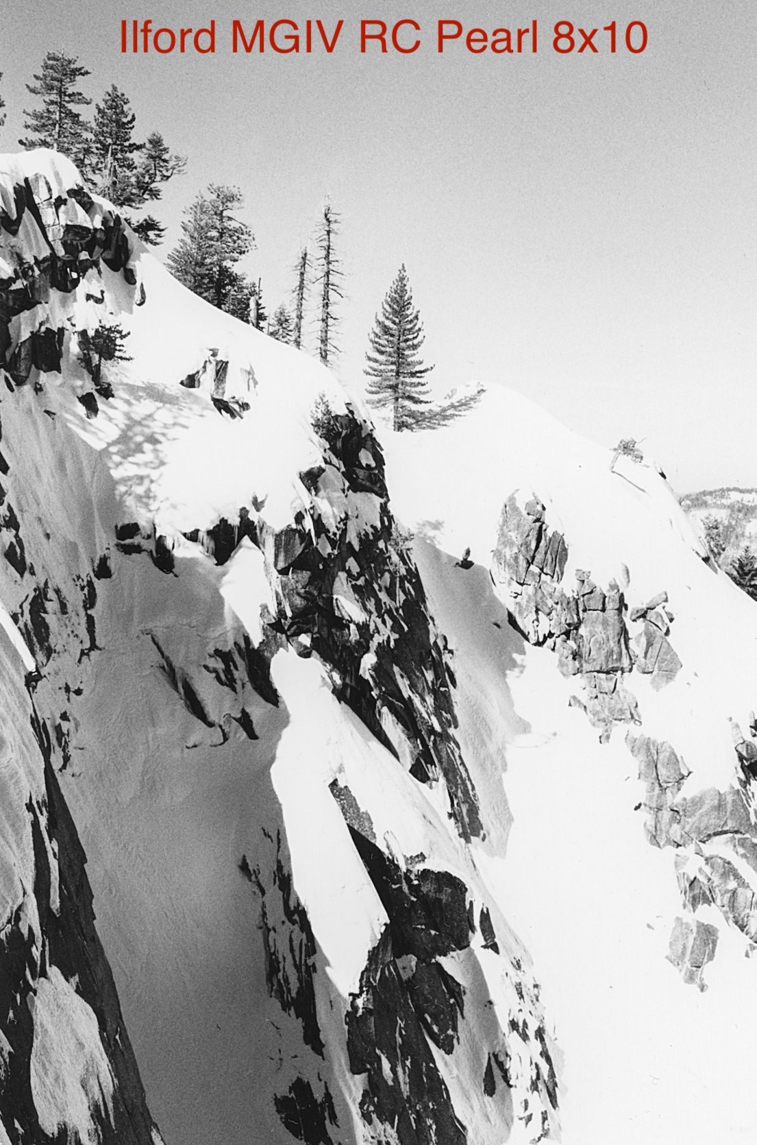

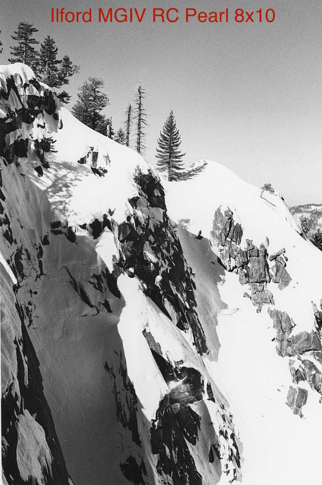

Clean samples of the standard 8x10 paper:
I’ve gone through about 20 sheets of the postcard paper and every one has this issue to varying degrees.
Another thing, I’m not familiar with this paper, should it behave similar to the standard MGIV RC Pearl paper? This postcard paper is MGIV RC Portfolio Pearl. I’ve noticed, when comparing it to the standard 8x10 RC paper (during the same session with the same chemicals) that with the postcard paper, it takes longer for the image to appear and it’s fairly lower contrast. The same negative might need a 4.5-5 filter grade on the postcard paper while on the 8x10 it might need 3 or so.
This paper was backordered from B&H Photo for about a month, I don’t know if I just got sent an old box? Or, if it’s a bad batch? I’ve not had this problem with their other papers… I plan on contacting Ilford but, I was just wondering if anyone else had experience with this paper in the past (good or bad).

In the second image the photo on the left has a line it's lighter one side than the other. I suspect it's an over fixing issue where another print has been sat on top in the fixer covering the darker right side and the left has some image bleaching. Rapid fixers can do this.
Ian
sorry, I should have explained that, that was a test print of two exposure times, it just happened to be a good example of my spotting problem.
