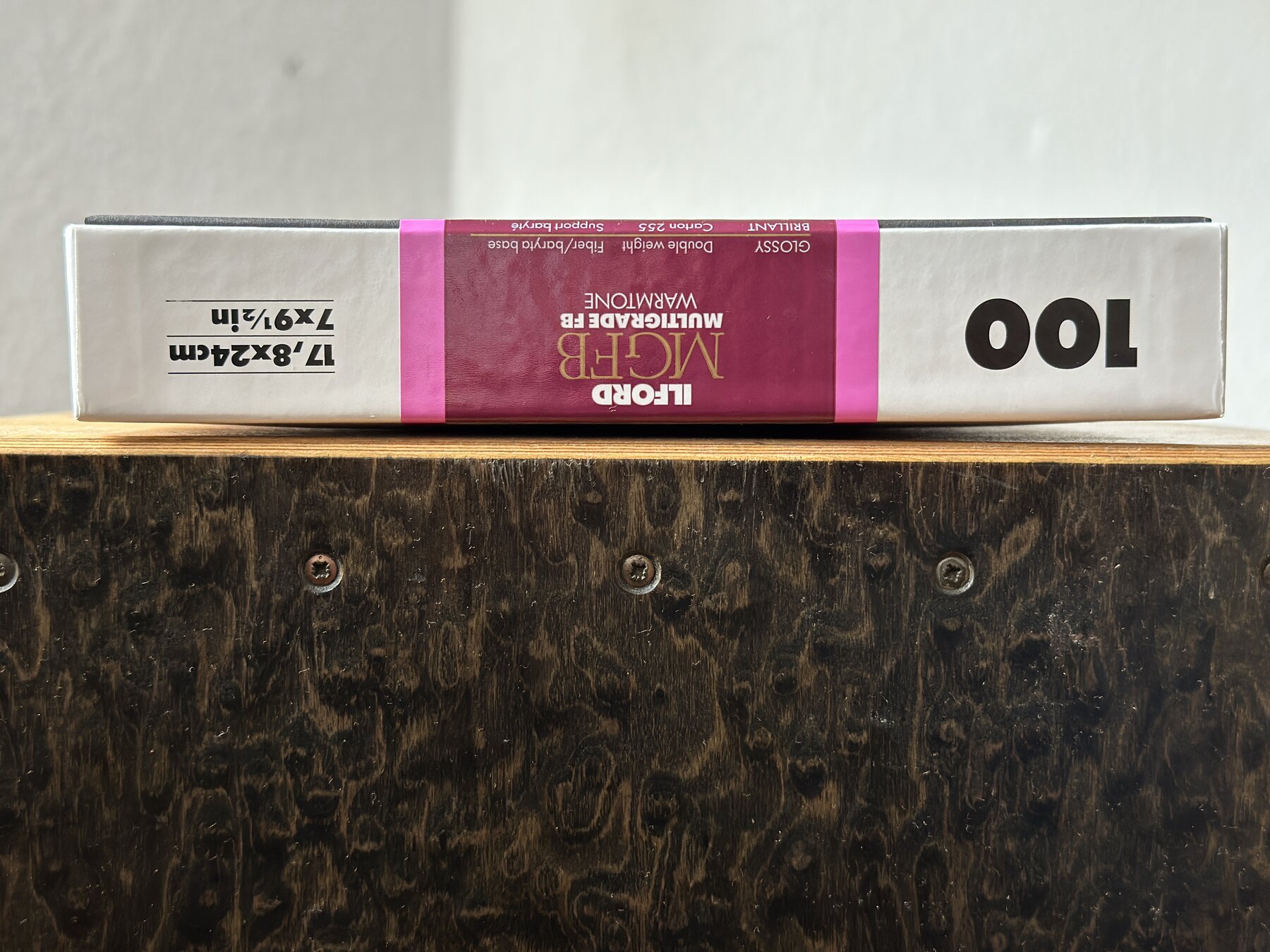

Just received a 100 sheet box of 7x9.5 FB Warmtone Glossy -
the paper inside the box (which I haven't opened yet, tape is still in place) is so bent (bulging up), that it literally creates a bump in the lid of the box.
I suppose you can't expect it to be 100% flat, but I'm finding this a bit extreme.

As you can see in the pic the sides of the (still unopened) box are literally up in the air when you put it upside down on a flat surface, as the bulge of the stack of paper is pushing against the lid so strongly 😅
Thought about returning the paper, alas warmtone is pretty much sold everywhere in pretty much all sizes, also the recent price hike means if I were to buy a new pack that's 25% more.

So is my heating and my RH is higher than 40-45% based on my hygrometer. I need to say that I don't use FB but if the problem has not gone away since your March 29 post then it may be that something occurred before you got the paper and cannot be corrected
I would write to Harman about the problem and it is agrees it is its fault then it should change the paper without you having to pay anything

Baryta paper is often curved rather than flat like RC. It's more pronounced in smaller sizes, but i've never had issues of it not being held flat in the easel. I consider it the nature of the product....rather than a "fault"
